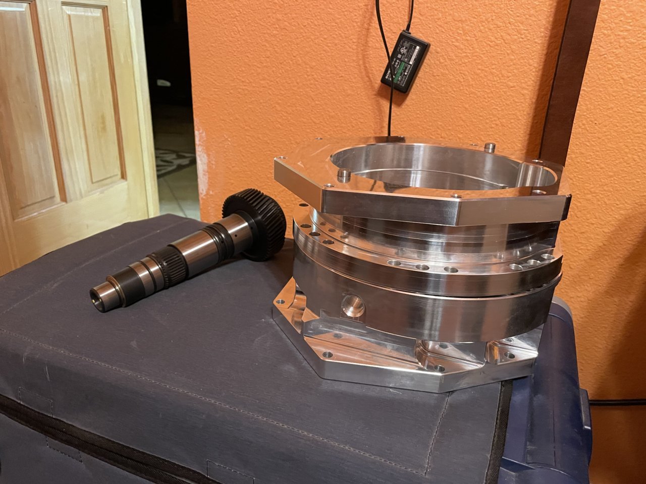

    Got my NWF case in yesterday. Ordered 11-28-21 for reference

    Looks fat. What donor transfer case are you using?

    That is a beautiful piece of billet!
    Just curious, what provision does NWF have for mounting for the Eco? Or is it just cantilevered off the transmission?

    Using an auto FJ case for the donor, and a Manual AWD FJ case out back
    From what i understand, it's just going to hang off the trans.

    I'm guessing that means you'll need to pull the input from your AWD case to go into the NWF box, then swap the FJ input into the AWD case, but with their longer input shaft?

    Itll be going behind an R156F so the auto 23 spline input shaft will work perfect for the EcoCrawler. The auto case will be used as the donor and then input shaft will need to swapped on the AWD case for the NWF input

    Gotcha. Forgot you had a the R156F in there.
