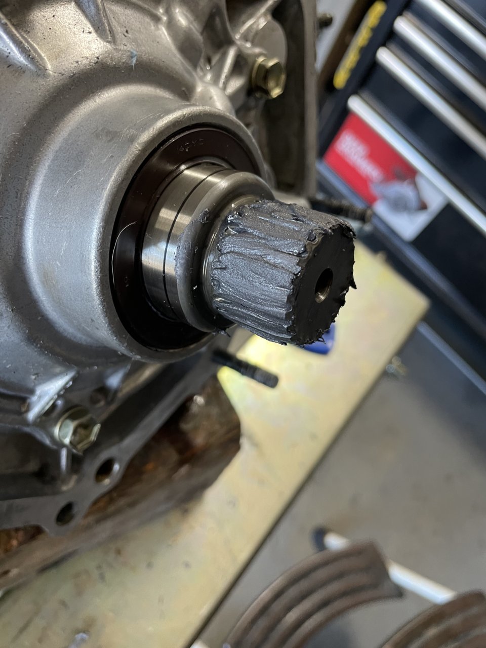

    Pull the housing off or carefully remove the seal.

    Decided to leave it on, greased the couple real good and slide it back on

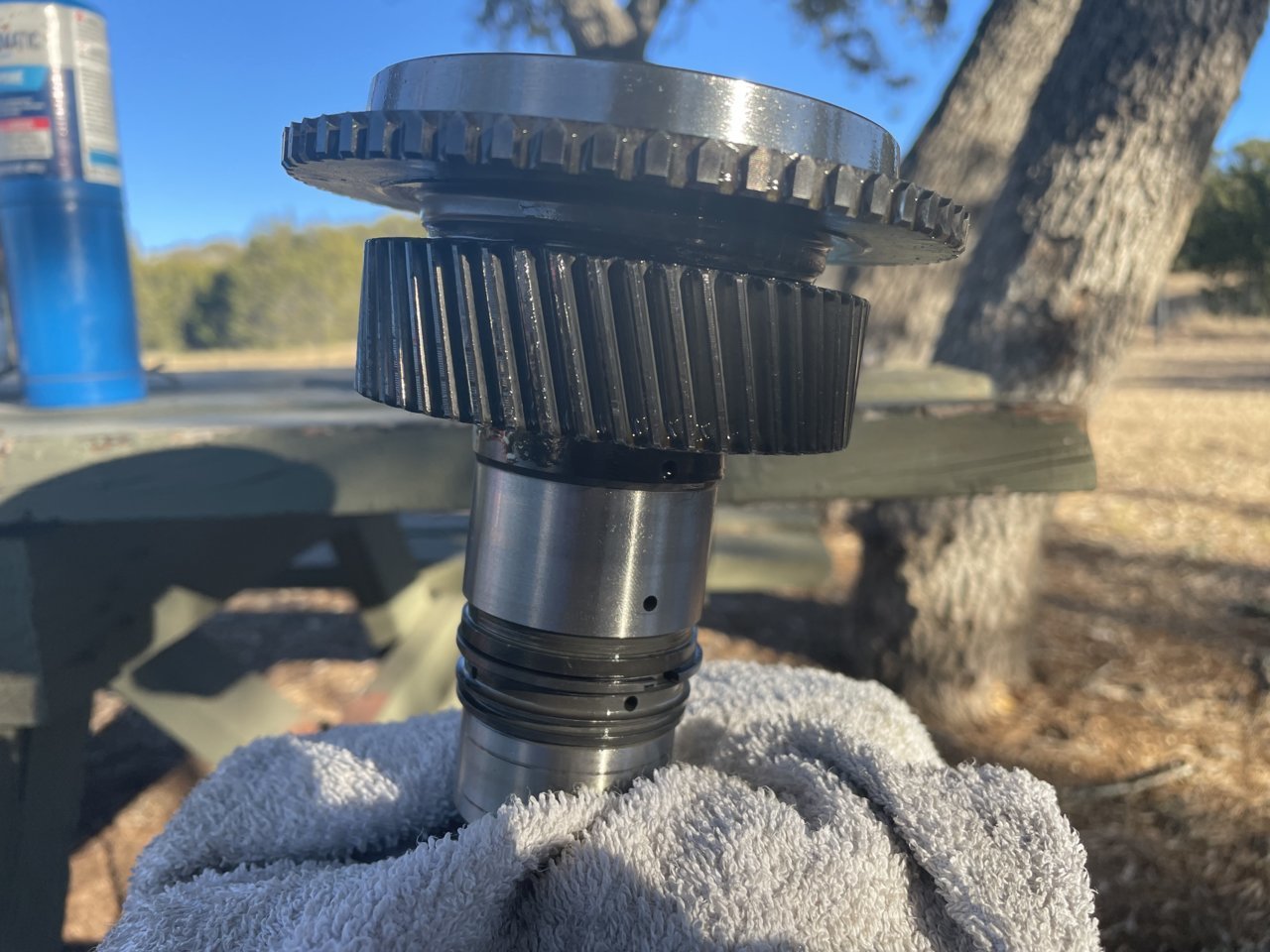

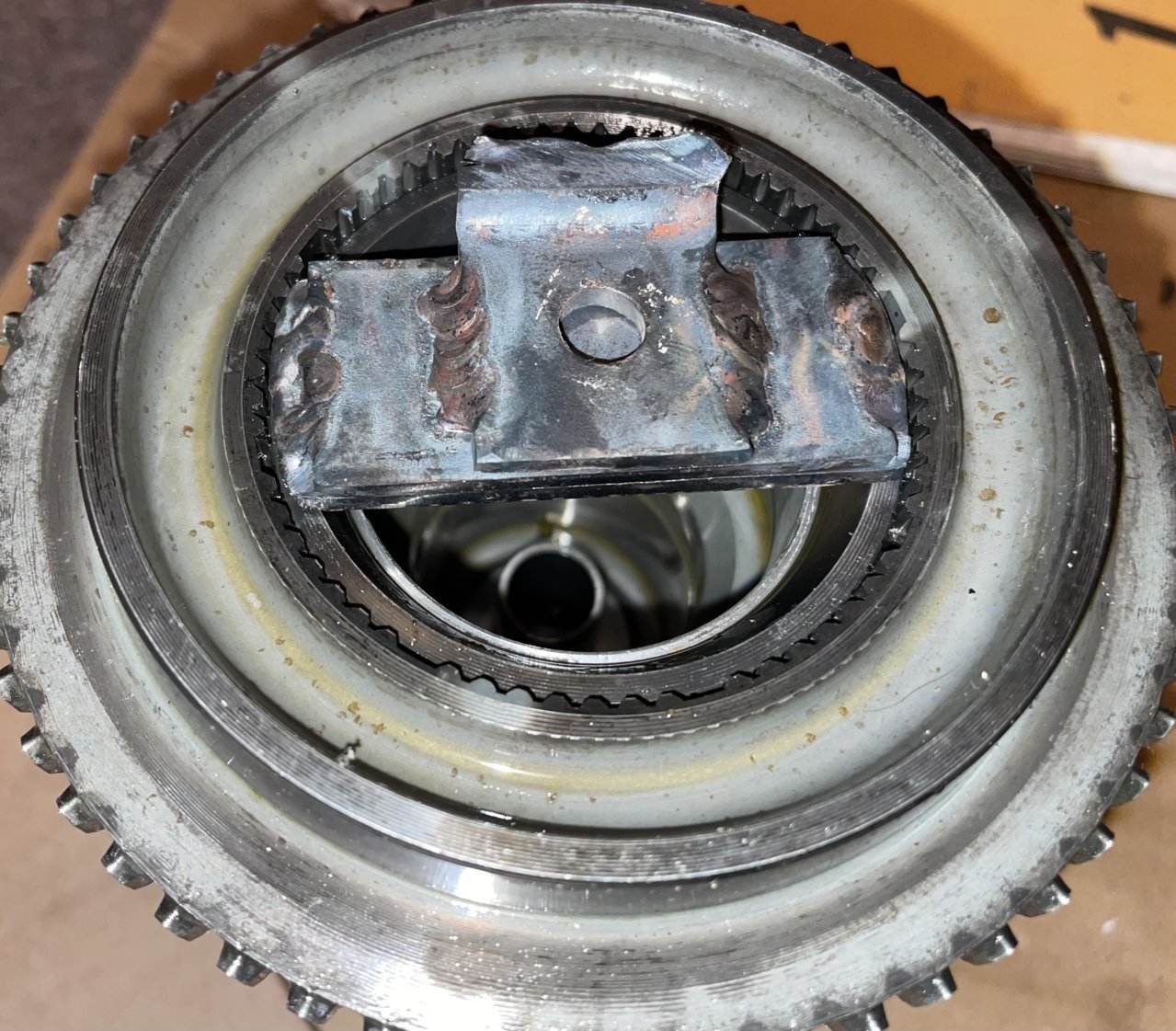

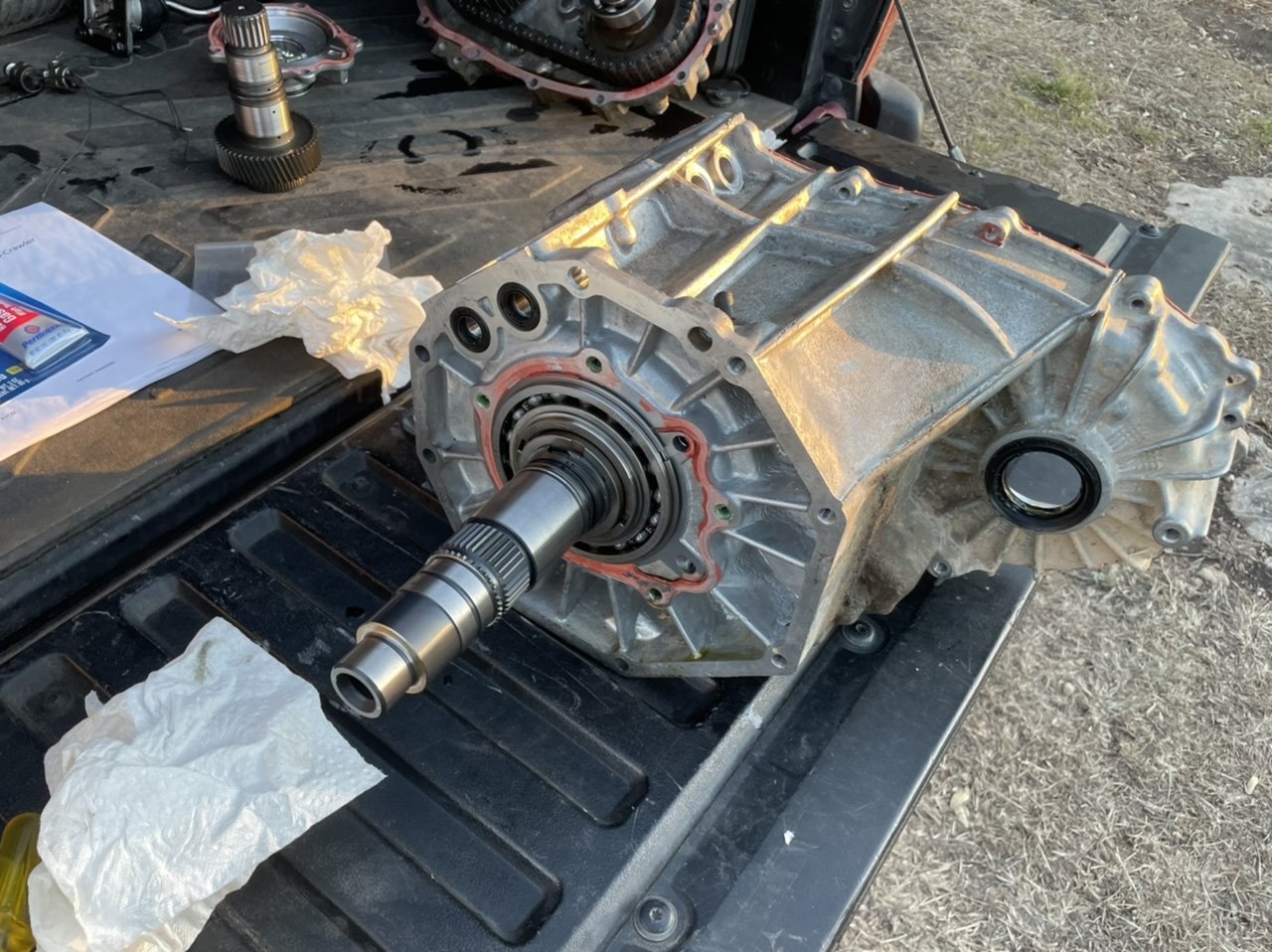

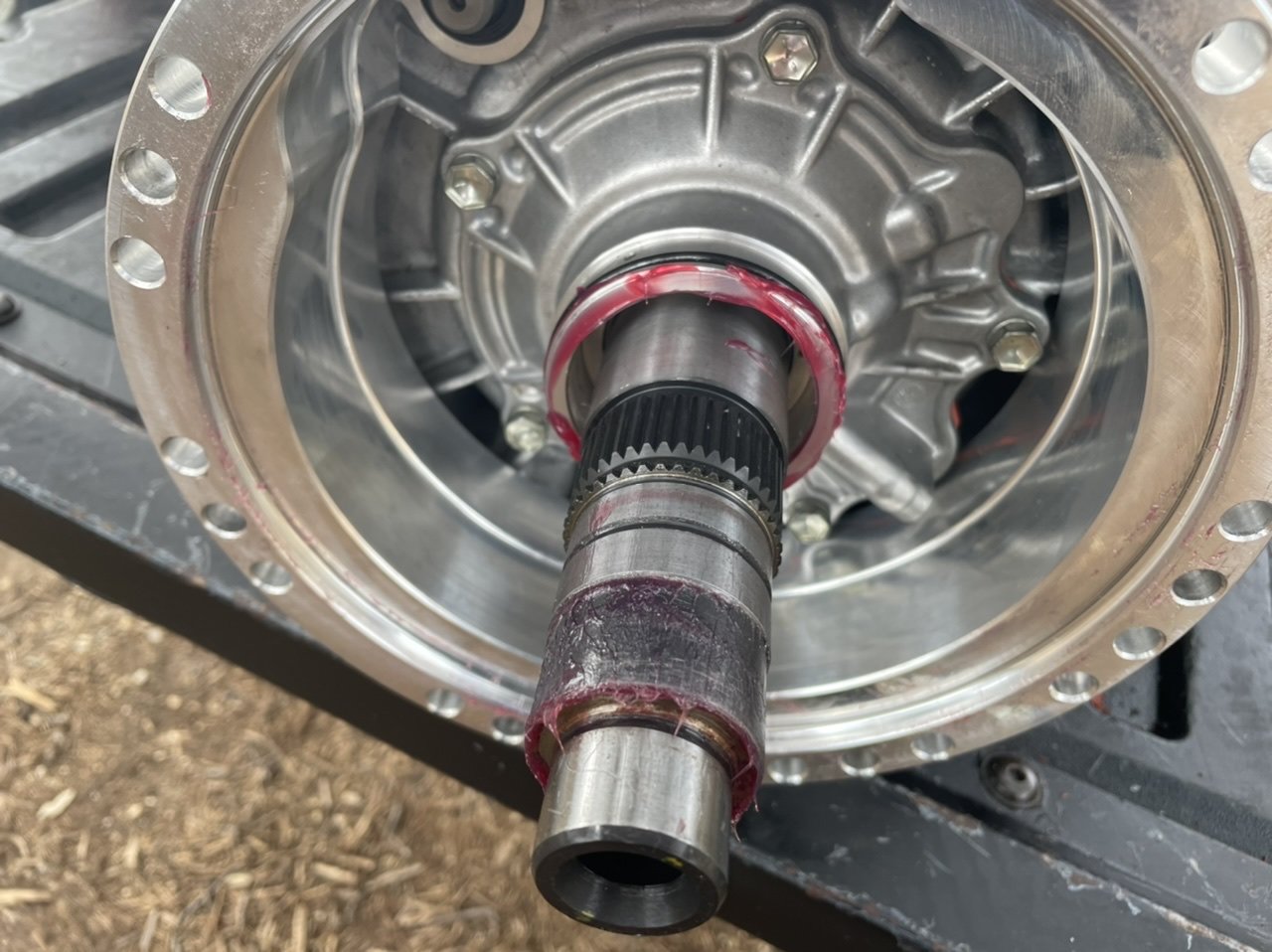

    Does anyone have any tips on how to separate these two pieces? Looks like i need to reuse the top section on the NWF input shaft, but they are not wanting to separate

    a bearing splitter should work
    BassAckwards[QUOTED] likes this.

    Thanks, i will have to see if i can rent one at the zone

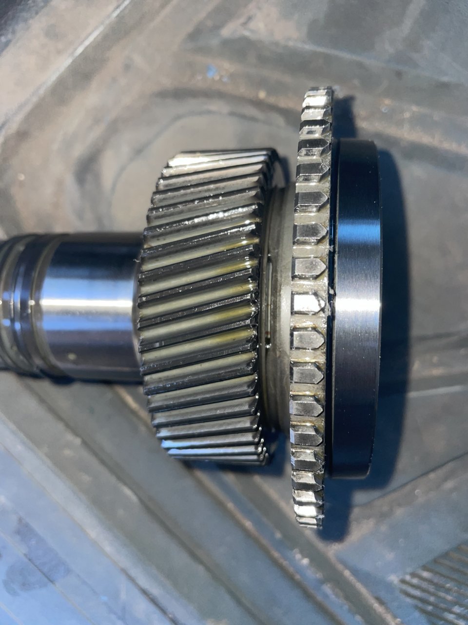

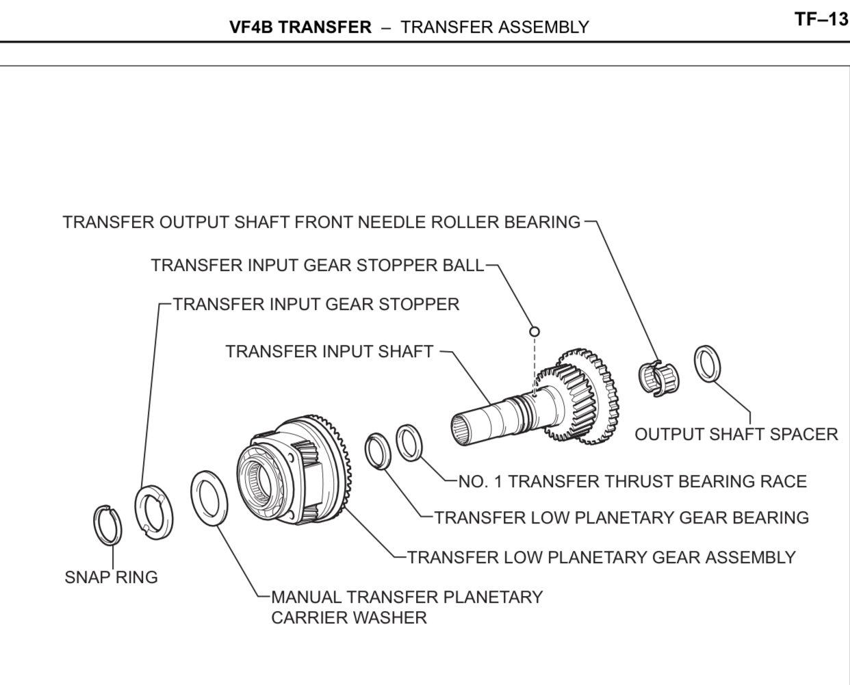

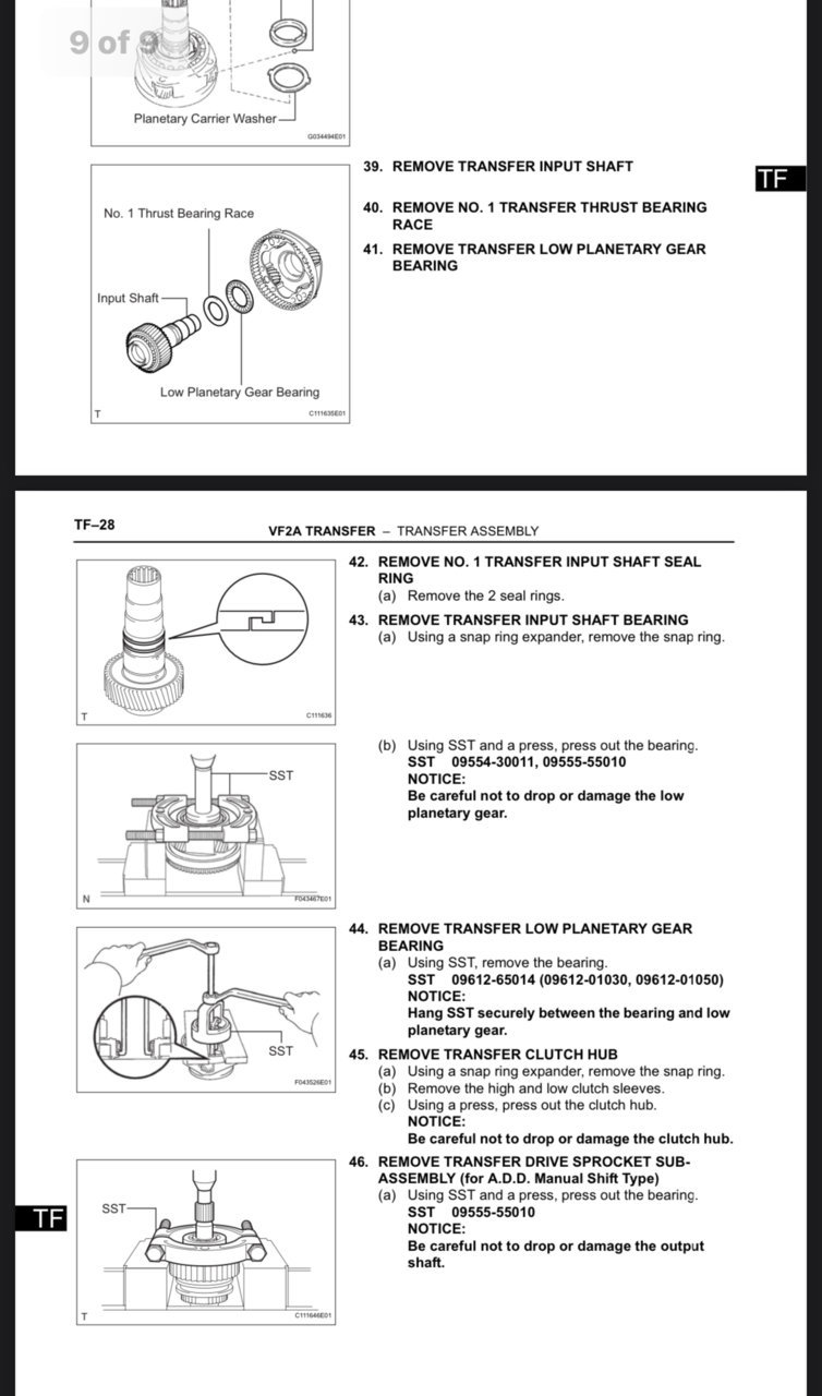

    is that the input shaft from the awd case? If that is, it doesn’t look like it comes apart? I’ve not had a VF4B apart to see that closely.

    Yes it is the input from the awd case. Based on the online diagrams and fsm it doesnt look like they come apart, but when you look closely it seems like theyre two pieces and like theres a place to wedge them apart. Heres some closer picsD17FB71F-DFAB-470D-BF90-6A354FE6C391.jpg
    And heres the new NWF VF4 input that i believe that upper section from my previous post should accept
    6 gearT444E[QUOTED] likes this.

    Yes it does look like it could separate. I can’t believe they would machine that as all one piece either so it makes sense. Use a bearing splitter and go slow, keep an eye to see if it starts separating vs. bending.

    Rent the medium sized 3-jaw puller from AutoZone, get a 3/16" or 1/4" scrap piece of steel to go on the end of the gear to protect it from the screw from the puller, hit it with an impact. That's how I did it, came right off.

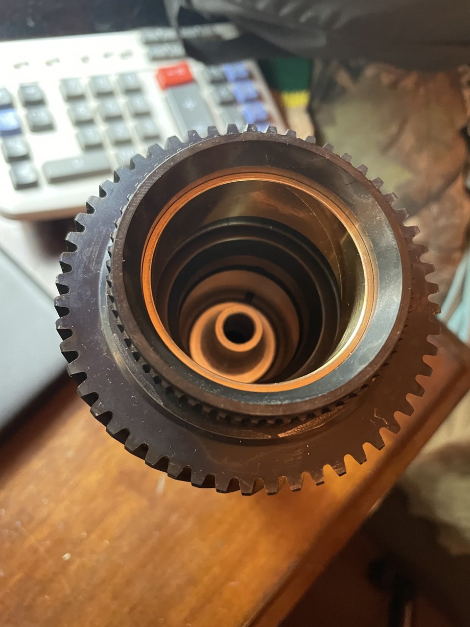

    Thanks for the recommendation. Tried a bearing puller today, but the one i got wont work without some modification or longer bolts. Got some jaw pullers on order earlier today, so ill give those a try if they show up tomorrow

    Just threw this together with some scrap i had laying around. Hopefully it makes the job easier. F4874BE9-9FC4-4112-8E3A-6C98C6E49962.jpg

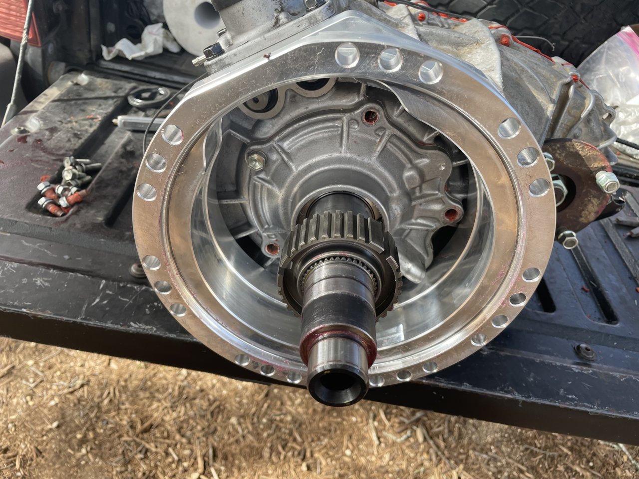

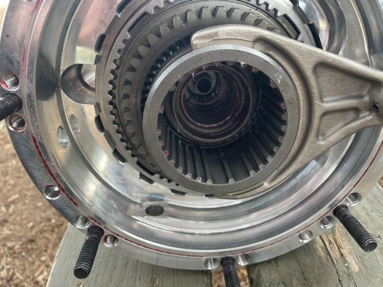

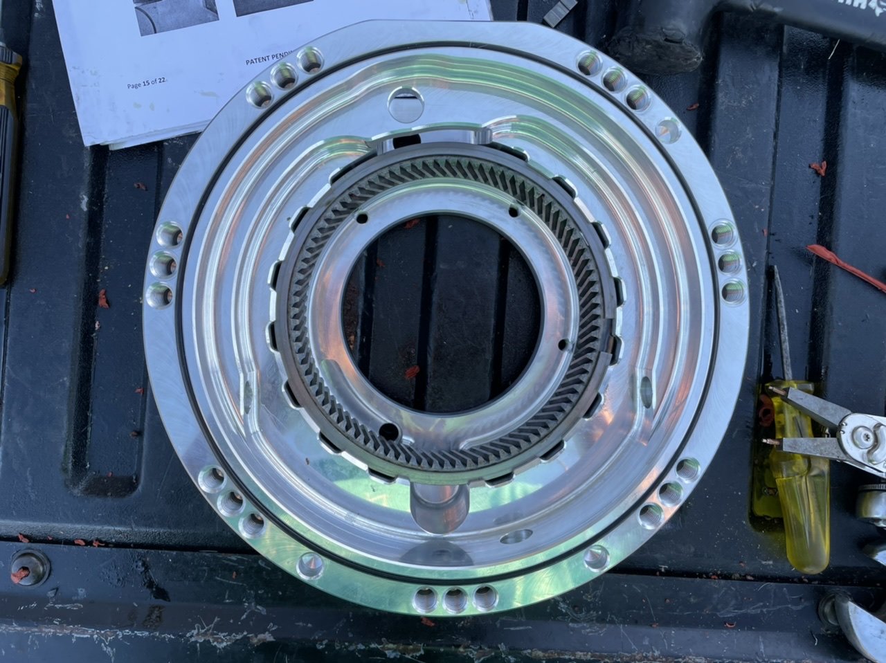

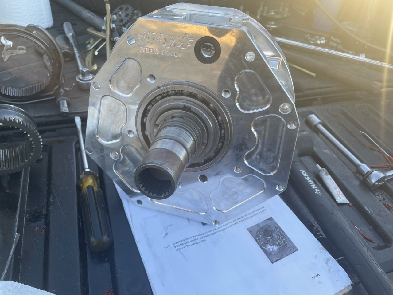

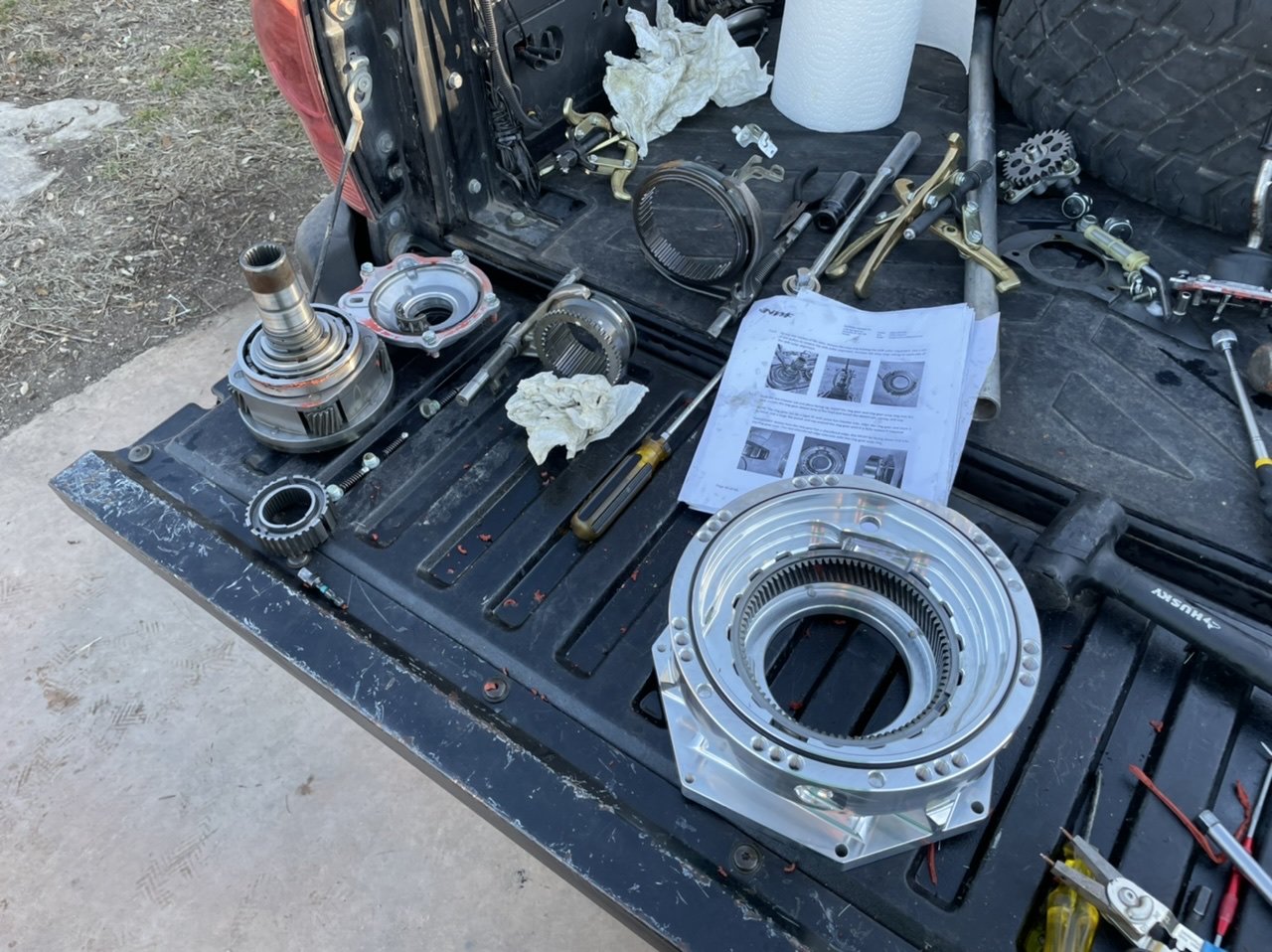

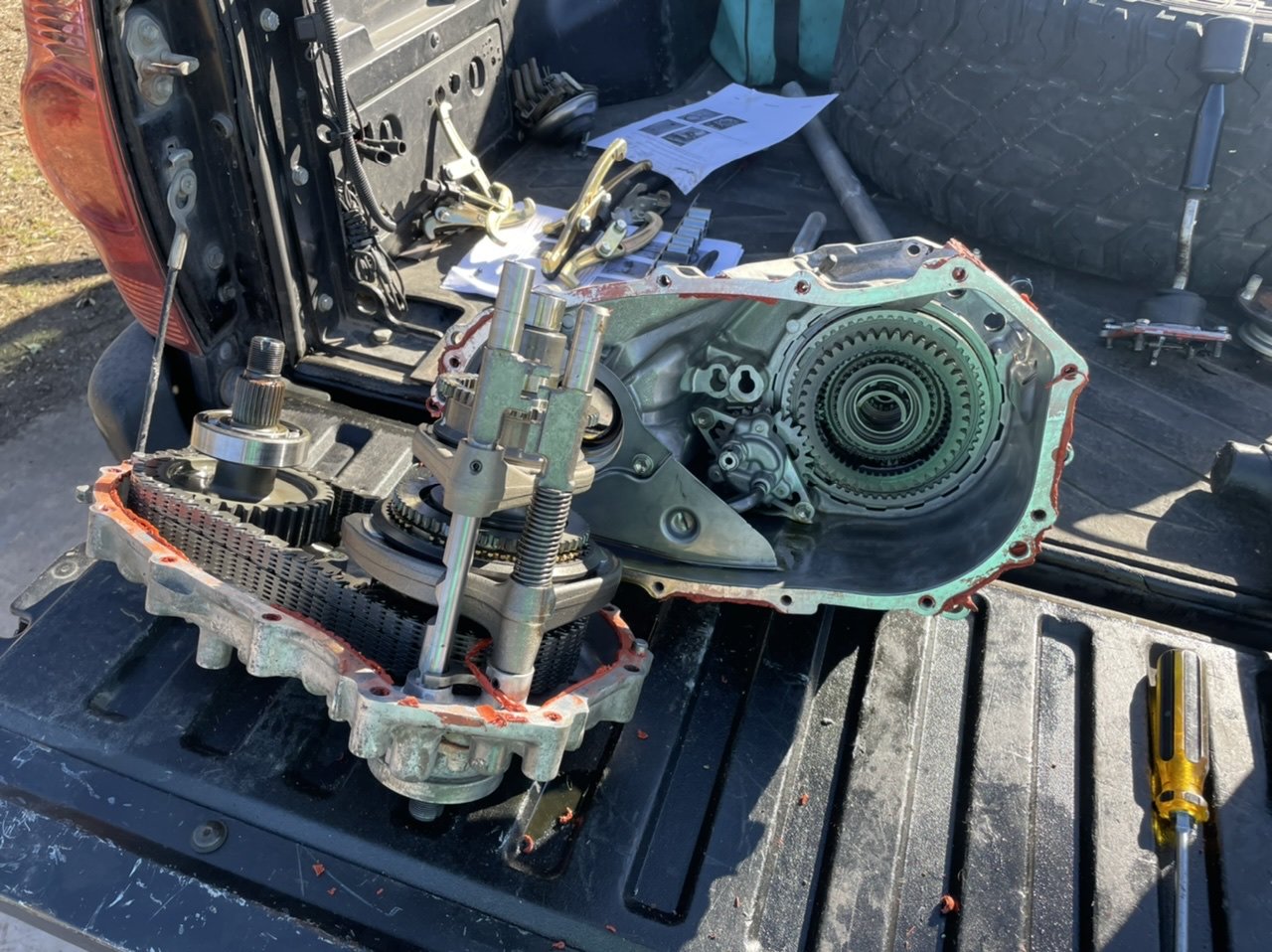

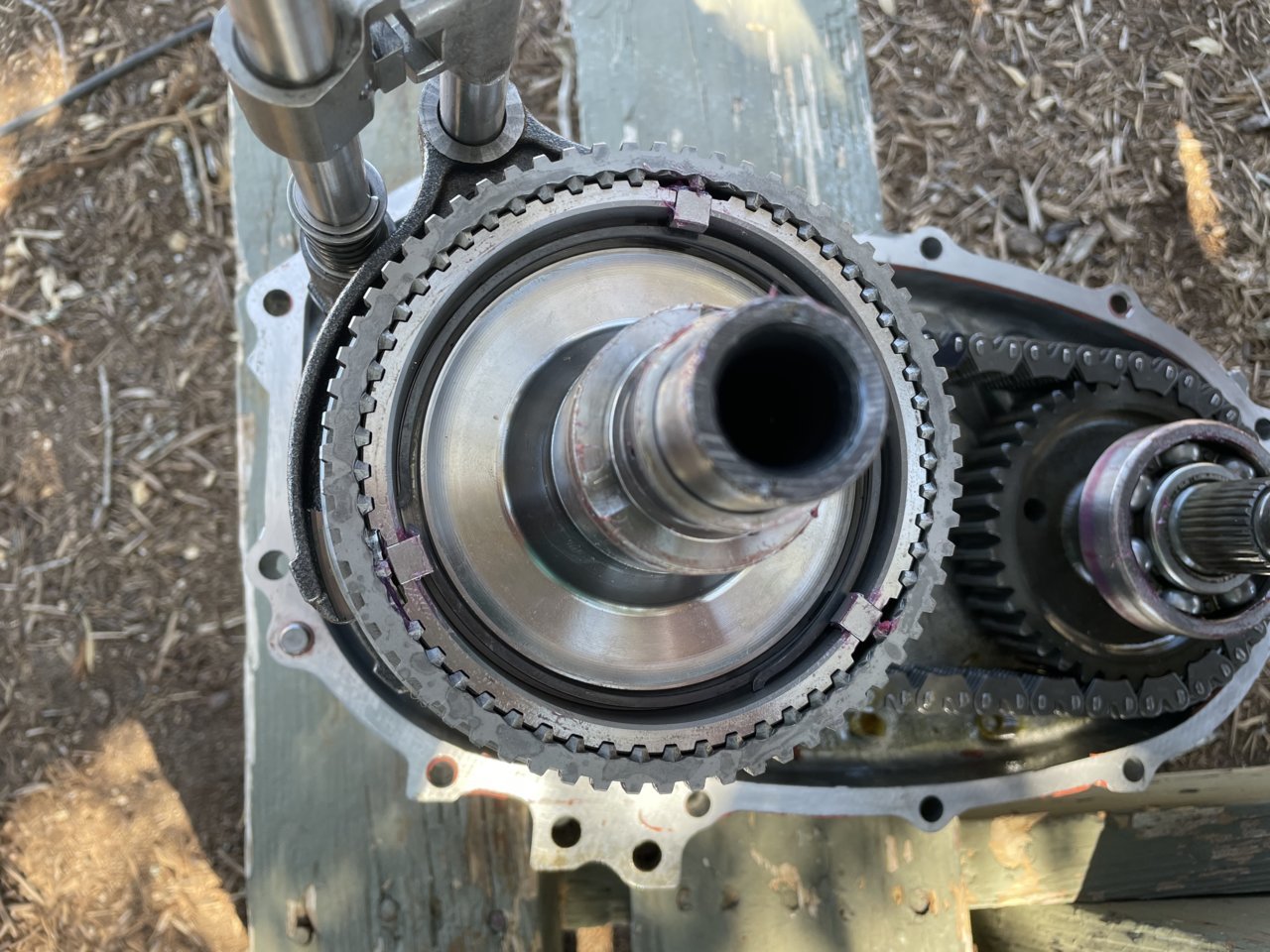

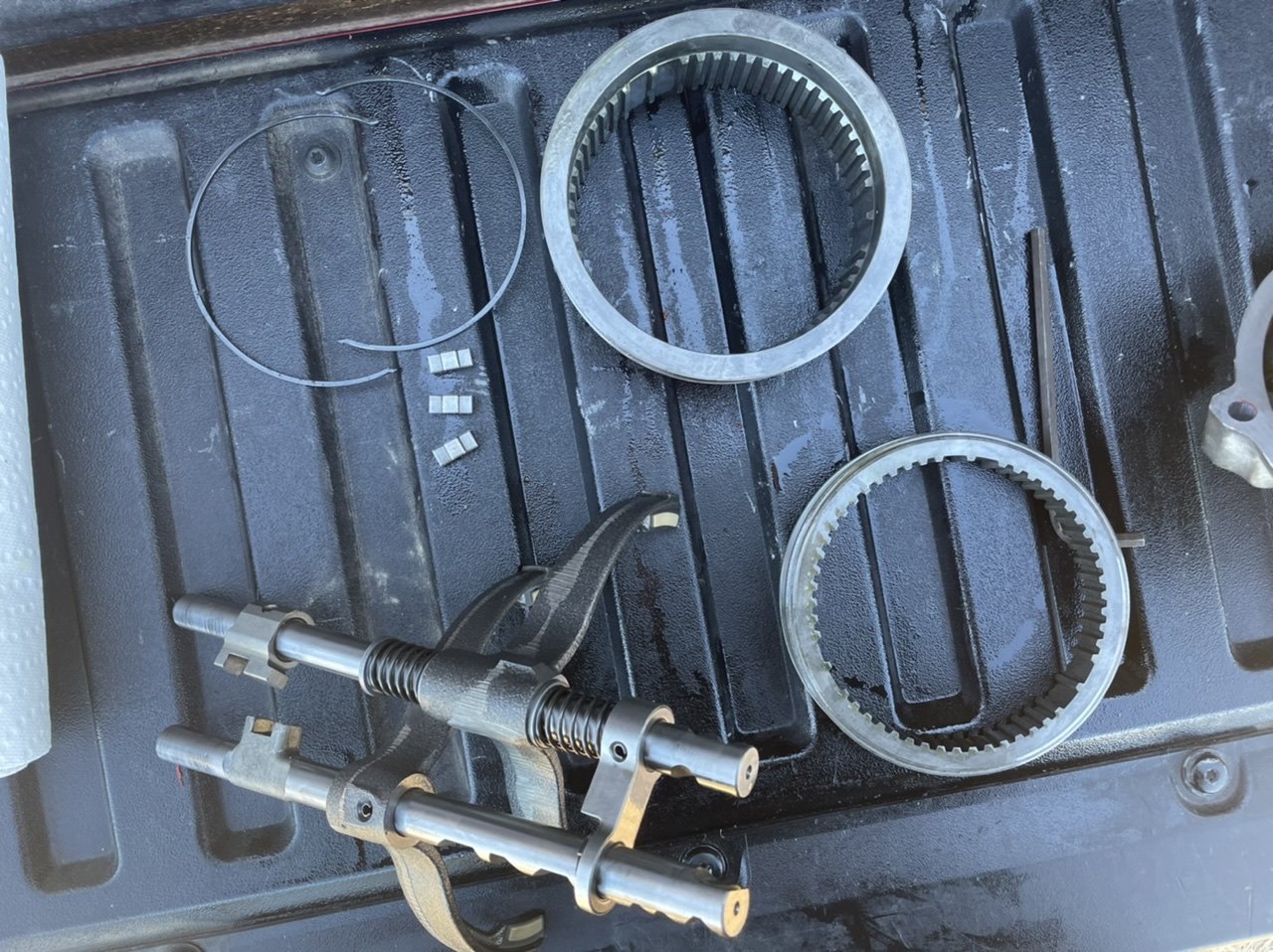

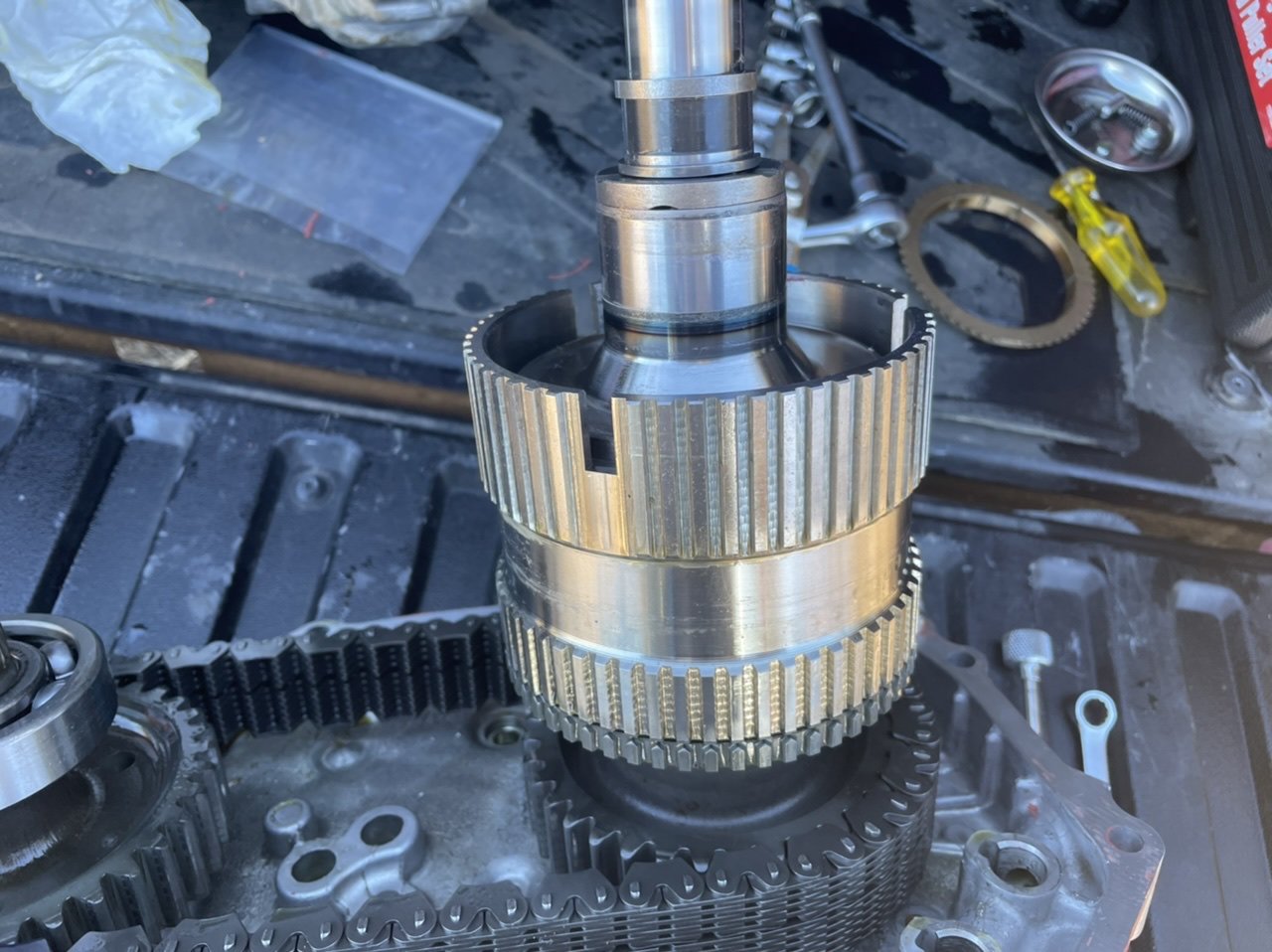

    Well, it’s been a busy weekend wrenching. Started out by reassembling the VF4B AWD case which quickly turned into another battle. Got the input swapped in Friday and figured I’d try to test fit the front side of the case. The case would not seat all of the way, so i knew it had to come back apart. Well that went south shortly after when the center diff lock shift fork got pushed from the unlocked to the locked position. This would be like the equivalent of shifting from 2wd to 4wd in a part time case. When this happens and the case is split, there are three keepers and two springs pop out of place and have to get put back in.

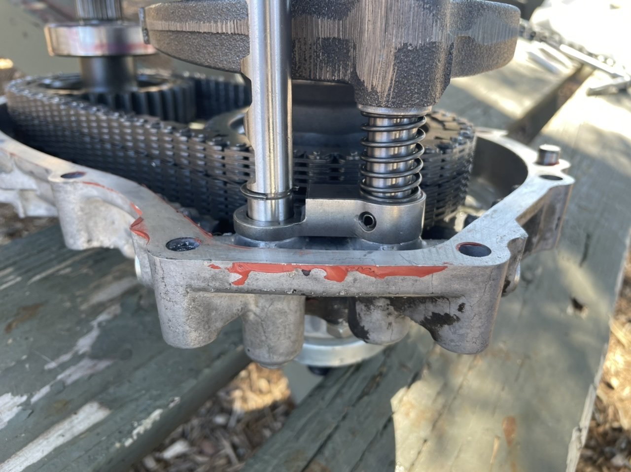

    So here’s what I was looking at now. At this point I also determined why the case wouldn’t seat all of the way, there were two balls and springs for the shifter that I didn’t remove and they fell down in the shift rail’s slot.
    After much deliberation, here’s how the springs and keepers get installed on the VF4B.
    And the shift rail retainer has to be flush with the back of the case. When reviewing some pics i took during disassembly this is how i figured out the issue with the shift rail springs & balls.

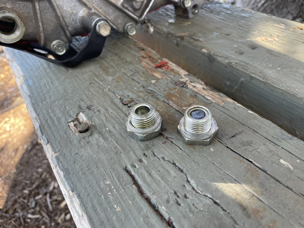

    While i had it apart I swapped in a magnetic drain plug I had.
    And a few hrs later finally back in one piece. It was a big victory to get it back together after things literally fell apart lol.

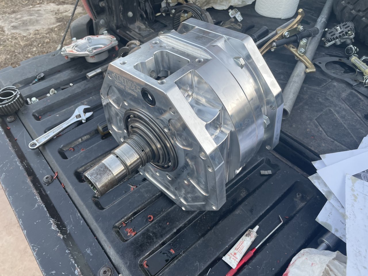

    Now onto the fun stuff, gutting a part time 4wd VF2A and building the EcoCrawler

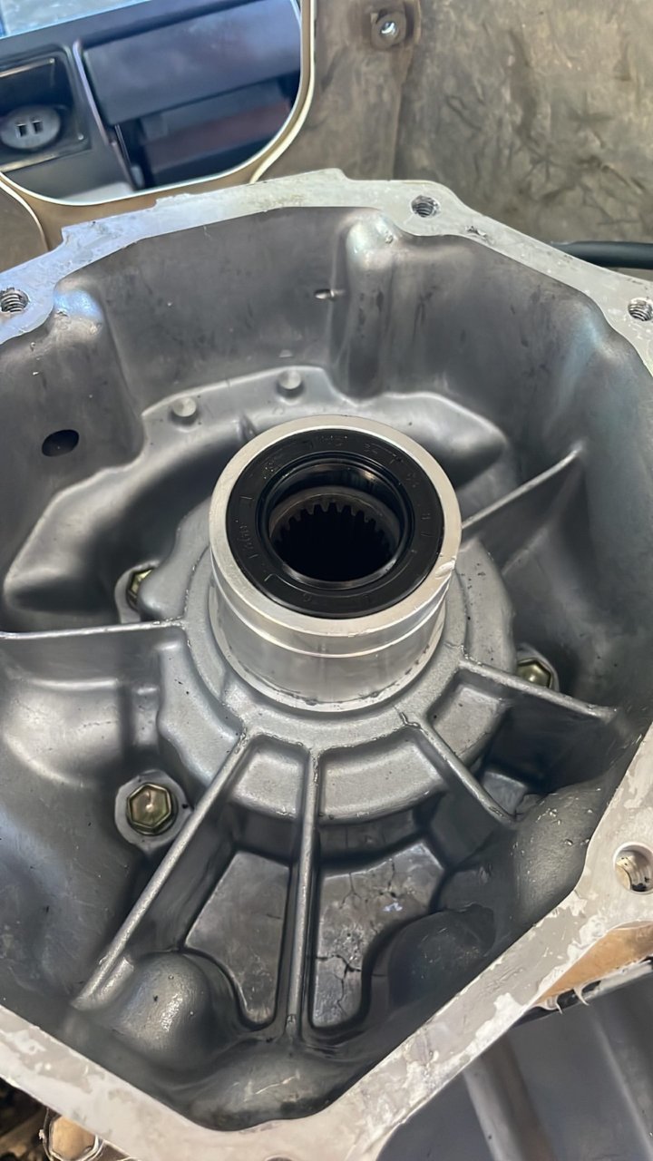

    hit a minor set back this morning, figured out why double low wasnt engaging. It turns out the bearing retainer/front cover that seals around the input shaft for the AWD transfer case is too large and is interfering with the gear that engages low and high range on the Ecocrawler
    My fix was to pull the auto t-case retainer/cover off the cover and see if it’d fit on the AWD case and it turns out it does, and it also allows double low to engage now. So i’m gonna buy another A/T retainer/cover for the EcoCrawler since it needs one too.

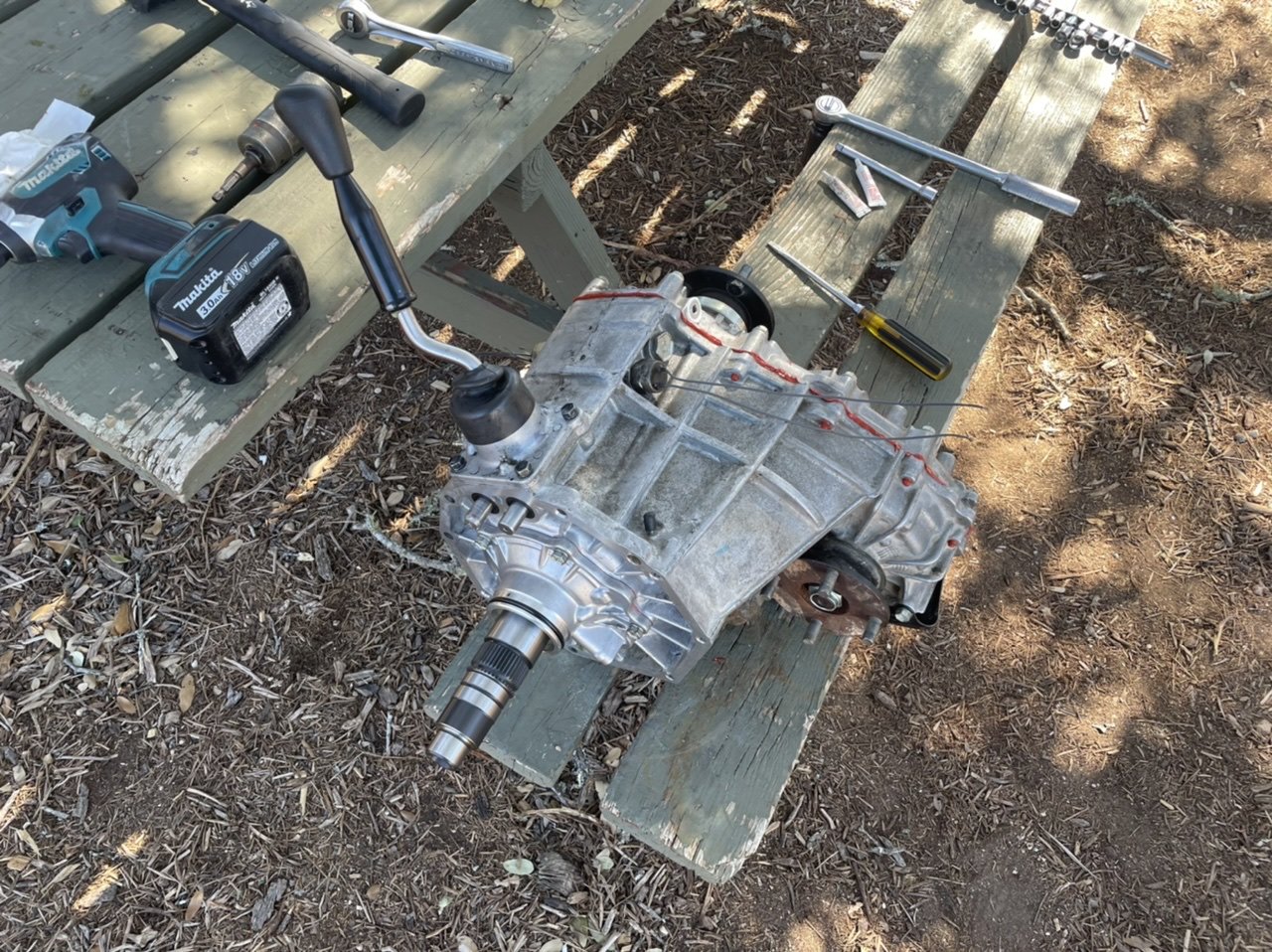

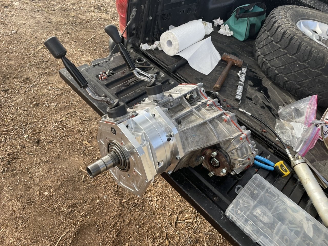

    Both cases assembled and functioning

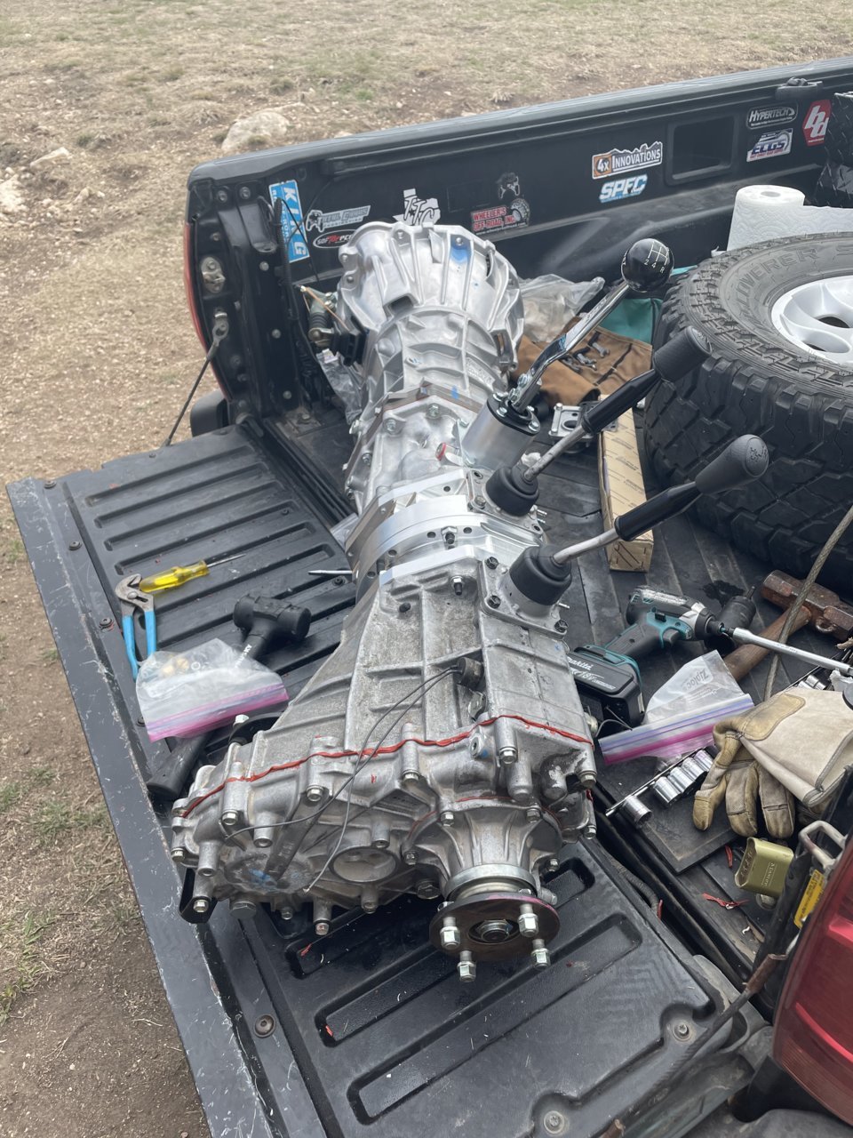

    Test fit with the R156F looks great. With the hurst/core shifter, i dont have any interference with reverse and the crawl box high and low. So the real hurdle to overcome with the shifters looks like for the main T-case placing it to the left of the trans shifter. Getting close to my plan for an AWD 2TR-FE. Overall id say the install wasnt too difficult as long as you have the right tools for the job. Jaw pullers and a shop press were needed in my case but other than that just basic hand tools and some quality snap ring pliers
    And here’s the goods, R156F < Northwest Fab EcoCrawler < VF4B FJ case
