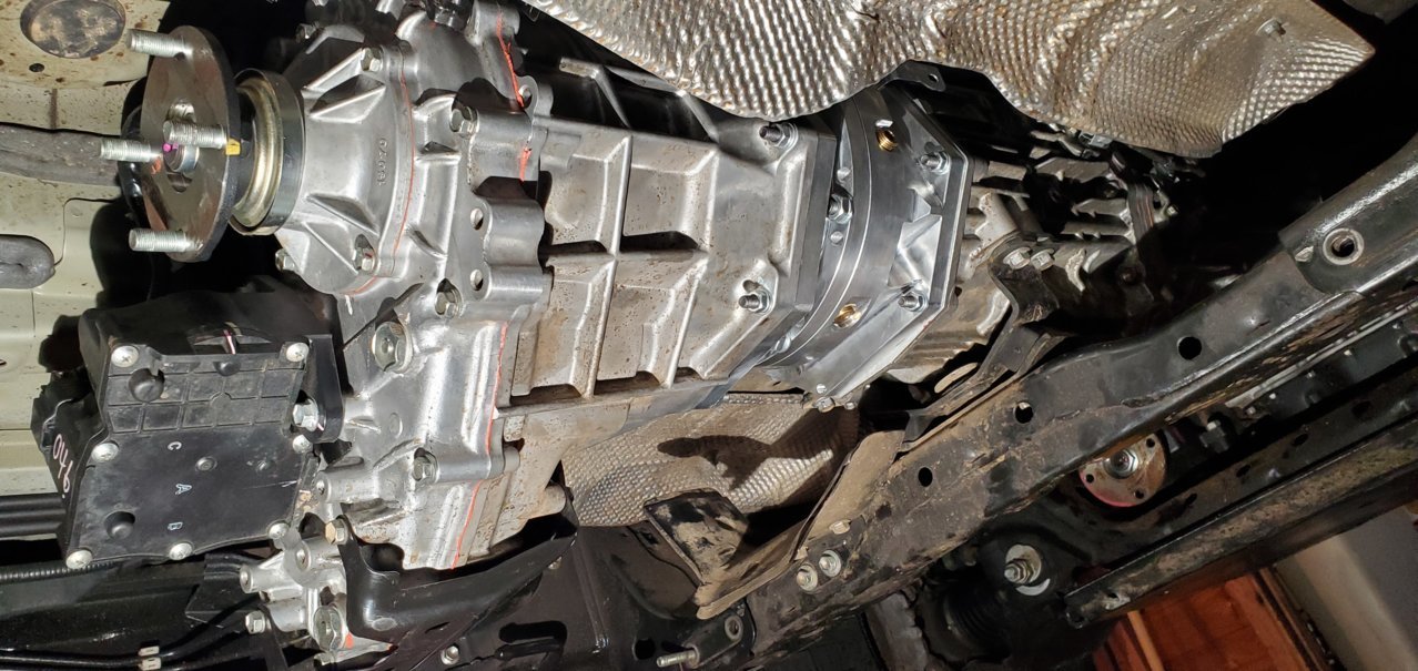

    Hard to get a pic but, got the Eco Crawler mounted under the truck today and it fit like a glove.

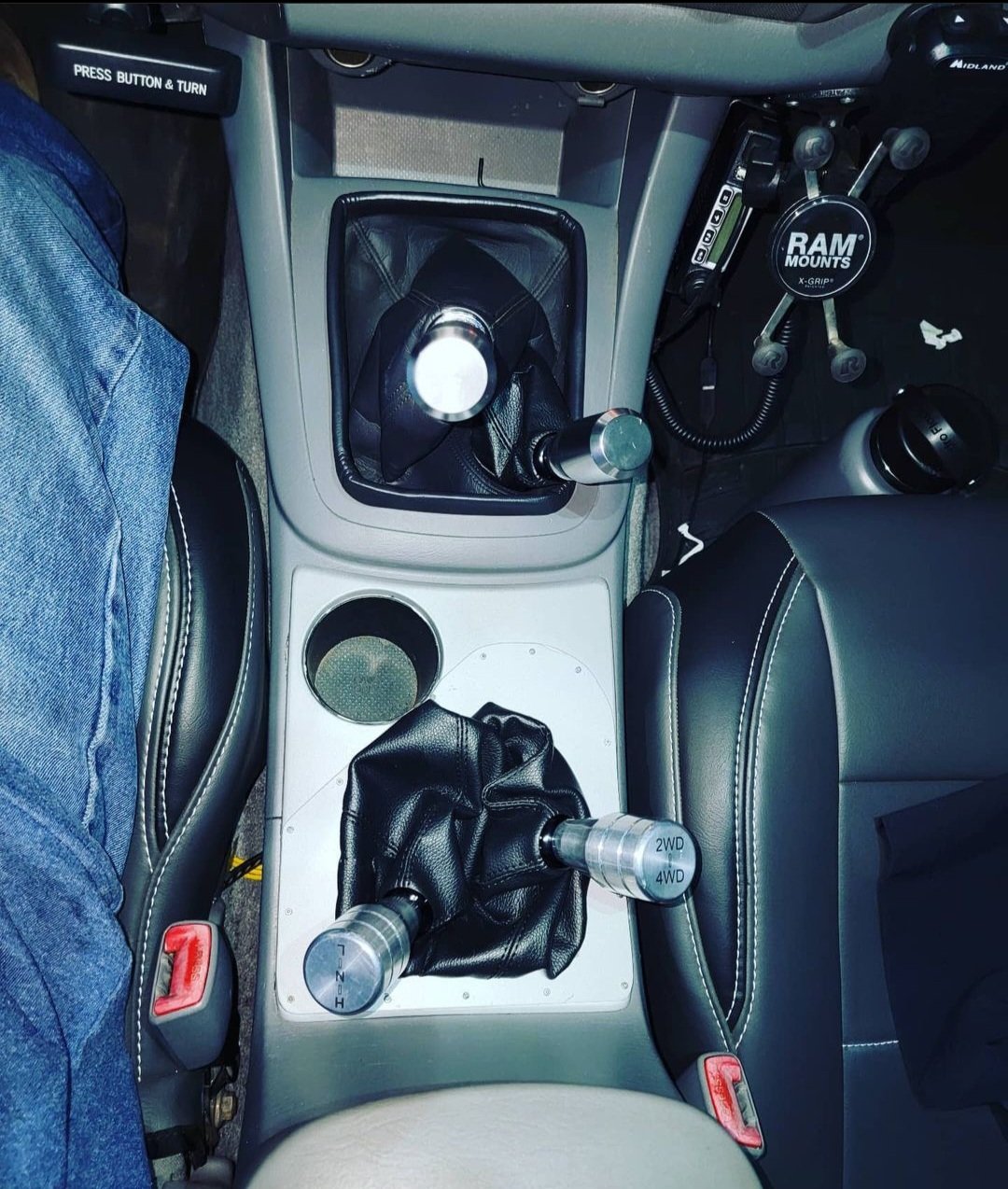

    All pro long travel KING 2.5 remote reservoir long travel coil overs with adjusters Arb front locker with Nitro Gear 5.29 gears Cab mount relocation BAMF sliders Coastal Offroad front bumper Warn VR Evo 8s winch BAMF rear shock relocation KING 2.0 12 INCH remote reservoir with adjusters NITRO gears 5.29 gears with factory rear e locker Old man EMU drakkar heavy duty leaf springs Coastal Offroad rear bumper with dual swing out spare tire carrier and dual gas can holder Prinsu roof rack with light bar and storage cases Midland gmrs radio PRP seat covers Dirty life 17 x9 dt-2 beadlocks with 37 x 12.5 milestar patagonia mt Front and rear extended steel braided brake lines BAMF low profile bed rack Pro eagle 2 ton beast jack and mount Hilift jack and mount BAMF rear HD hangers not yet installed Trailgear crawlbox with FJ twinstick transfer case not yet installed Build continues.......
    Yes, twin stick on the fj case is possible.

    Looks good. Is this the FJ case with the center diff lock, or the Part-time 4wd case found in the Auto Trans FJ's? I have the full time all-wheel drive case from the Manual trans FJ
    Padt
    Sorry, it is the part time 4wd case from an auto trans fj. Looking at your pics, i didnt realize you are using the full time 4wd case in the rear.
