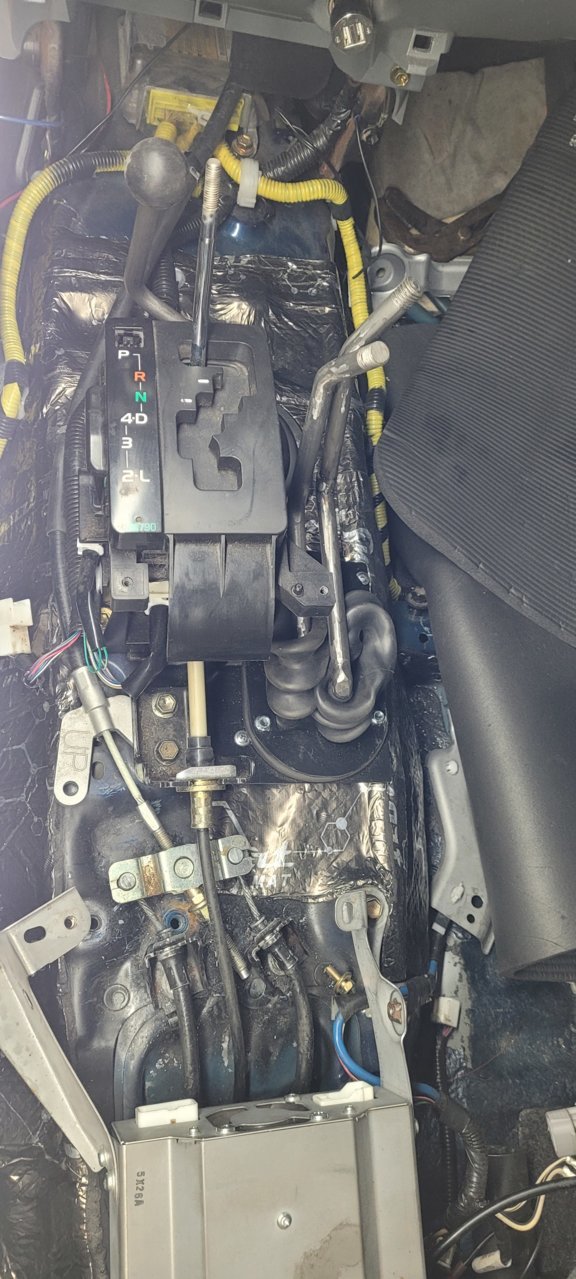

    I dropped the transmission/t-case as low as I could (thanks @Dan8906) which gave me enough room to remove the two side shifters and get access to the two top bolts. Unfortunately, there still wasn't enough room to tighten the top bolts.

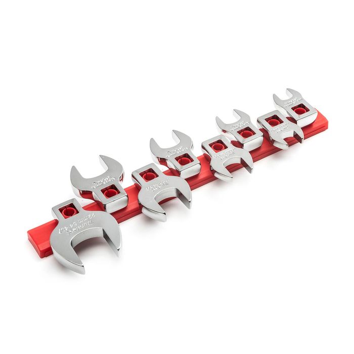

    I contacted NWF to see if they had any suggestions, they had two; the first one was to use a half moon wrench, and second was to use a swivel head ratcheting box end wrench. The swivel head ratcheting box end wrenches were pretty expensive around me, and I could not find any store that had the half moon wrenches in stock. I settled on a set of crowfoot open end wrenches which I got for cheap at AutoZone.
    These actually worked really well and I was able to get these two bolts tight. Got everything buttoned up, the shifters are in and clearing everything smoothly.
    I need to figure out how to make it all look clean and keep the road noise down. I'd don't think the standard triple shifter boot will fit with the way the shifters are offset, I need to find someone to sew me a cover as well.

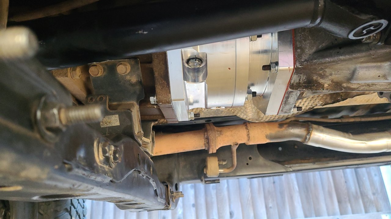

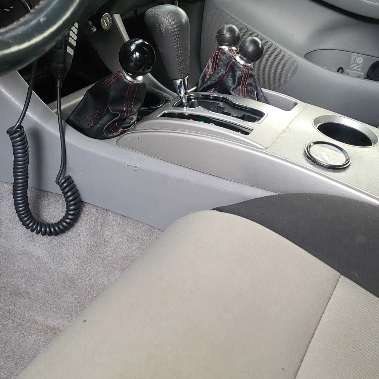

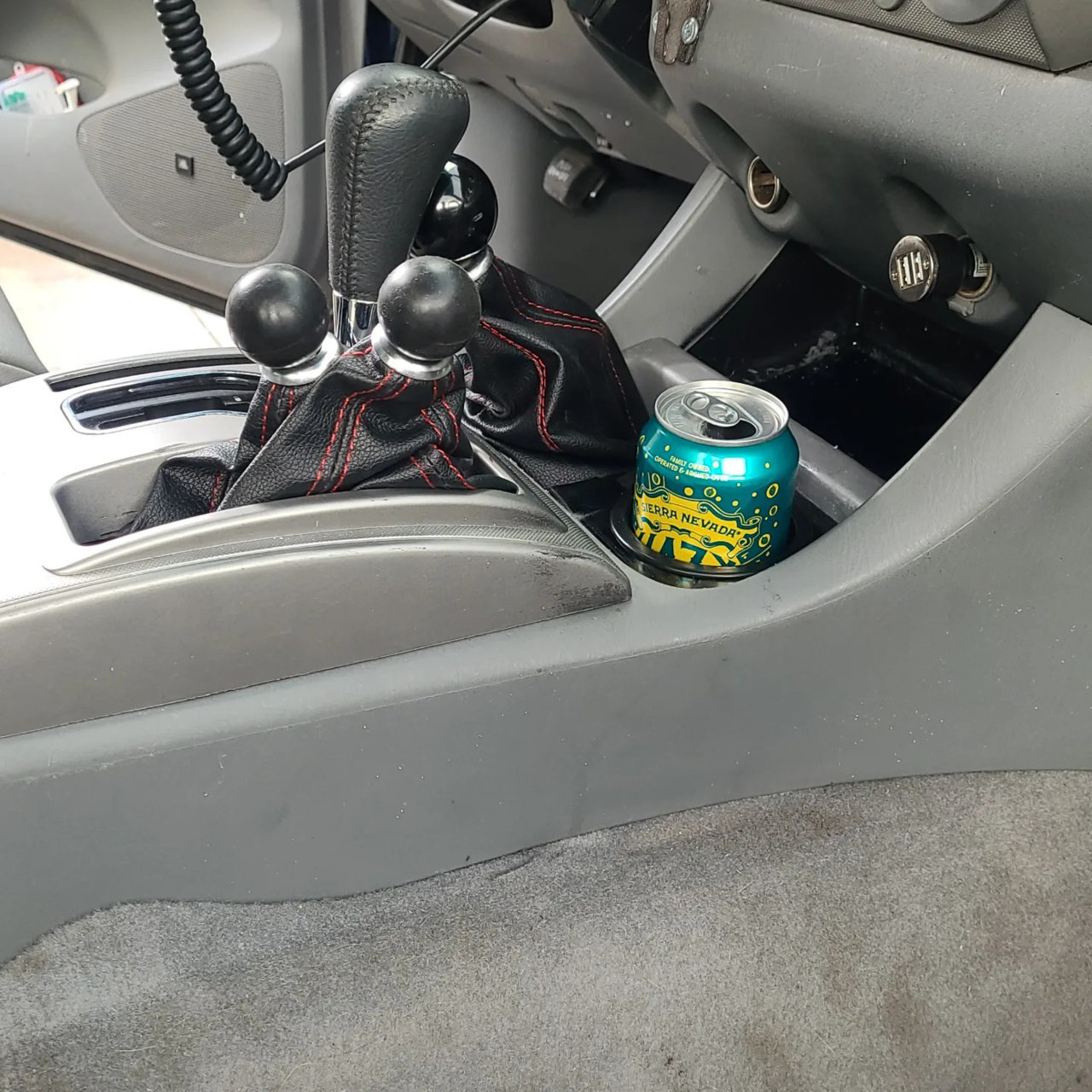

    I finally finished with zero leaks. 2nd install. 1st install leaked from transmission. I stupidity used the fist gen t case input shaft that Is 1/10 smaller then the the 2nd gen and fj. It was a bitch to fit in in a 2bd gen auto with no body lift. I did cut and widen the tunnel and it's clocked max 16 or 18 degrees I see mixed numbers there from NWF Instagram post. But it's maxed out none the less. I wouldn't recommend not using their shifter kit as it really complicated the install. Fab skills and mechanical skills are needed. As for those top 2 bolts mentioned they suck. I had to drop the trans and use the tool mentioned above and even then a pain in the ass. More clearance would be nice like the stock case has. I didn't have the problem of the triple shifter as I didn't wait for it. Their triple shifter would of made the install a little easier IMO.
