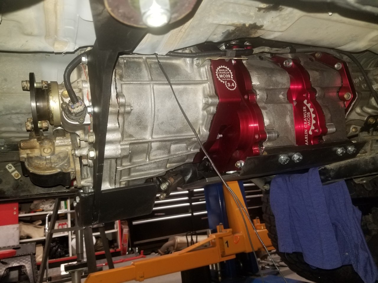

    Any of you 1st gen guys make a skid for the rear tcAse? I got hung up on it today, think I should give it some protection.

    I made these out of 1/4" metal and so far haven't hit anything with it. 1 for the VF tcase and 1 for the 2 RF1A case. I don’t like the fact that I'm using the original 4 mounting hole from the thin factory skid mounting location. But once I finish with my built, I'll need up making one out of 3/8" and run it the full length of the trans pan to rear case with frame to frame bracing.
