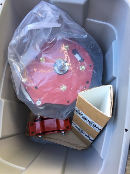

    Having Yodaman in Santa Rosa install it.
    Also forgot to post up the Marlin case:

    My front case is a marlin 4.7 gearset and the back is standard 2.57 stock planetary gearset from the FJ case. I can say that with the manual transmission I usually end up with just using the 4.7 gears on most of the tougher trails and sometimes when you just want to fall asleep wheeling engage both low ranges. The rear 2.57 case I use for less technical shit. It is nice to have the option of both though. If you are going to go with gear driven cases on both I'd go with 2.28 in the front and 4.7 in the rear case, both 23 spline in and out for strength. Last thing you want to do is bust an input shaft on the trail.

    If you don't mind me asking how much to buy all the parts and have him install them? I'm thinking about doing this to

    It was $2200 I think shipped.
    Install was around $1800 or so. They had to build a crossmember and modify drive shafts. You would need to call today man

    Hey man, if you don't mind me asking, did you buy your setup directly from MC? Thanks!

    Yep directly from Marlin.
