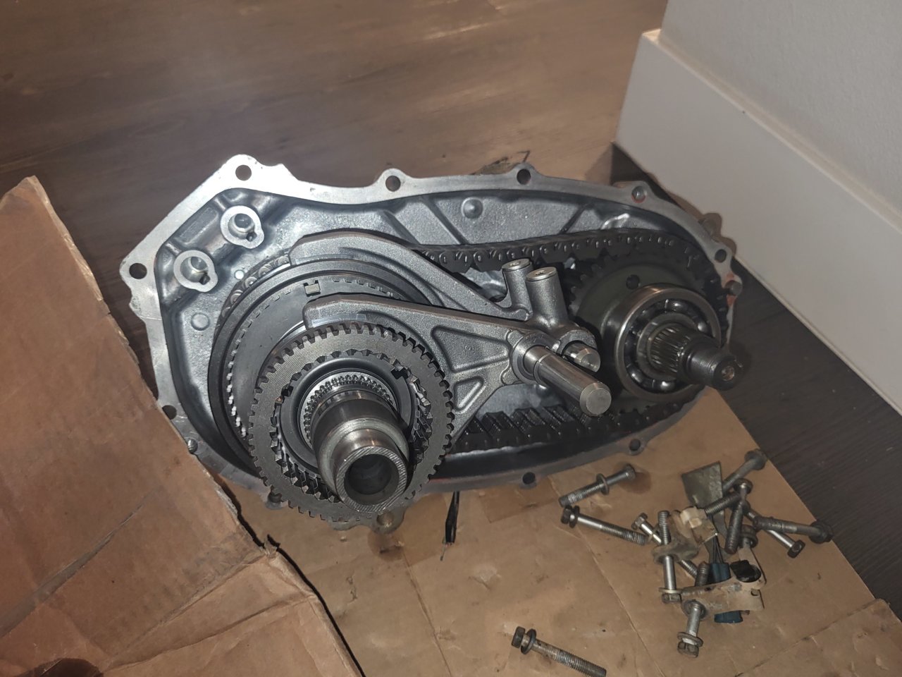

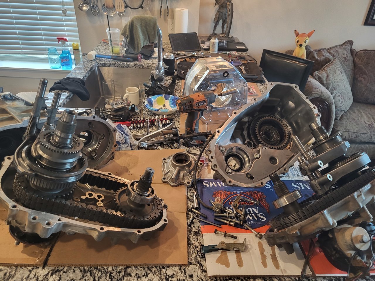

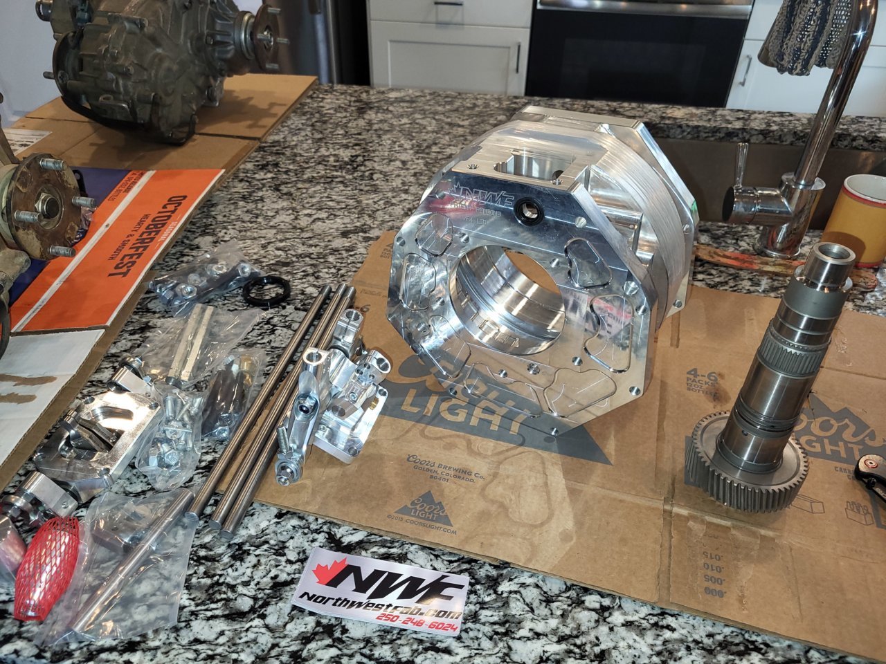

    No. The electronic case has the shifters going through the middle of the case. the J shift case would have shifters at the top. You cannot twin stick the electronic case as far as I know.
    J shift Fj left vs electronic shift right.
    Edit: better pic of the electronic shift head on.
    You should be able to put the electronic case behind the NWF box no problem if you have the correct base and lid. I am in the middle of my build right now but highly suggest you read over instructions on their site and give a call to speak with Kris over there. He will answer all your q's.
