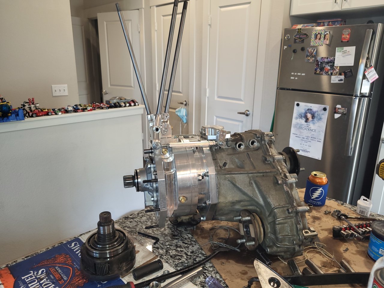

    Just got the NWF setup completed and shifting through everything properly. I'll measure drive shafts this week, install over this weekend and ready to roll after the 4th.

    Should be as easy as measure mating surface to mating surface of the NWF box which I think is 6-1/2” and then add that to the front, and remove from the rear.

    That's how I did it. 7.5" for the TG adapters and case. Sent that off to Tom Woods and had my shafts in the day I did the install. Best feeling when I put it in reverse in lo/lo and it actually backed out of my garage. lol

    I know based on my measurements I can just add/subtract 2" from the existing drive shafts and call it a day, but I am going to bolt it all up anyway for test fitment so there's no reason not to take a proper measurement before I drop off the shafts.
    I have been pretty good about it and taken the cases downstairs to the garage for any serious hammer work. Don't think I've chipped anything or cracked the countertops yet.

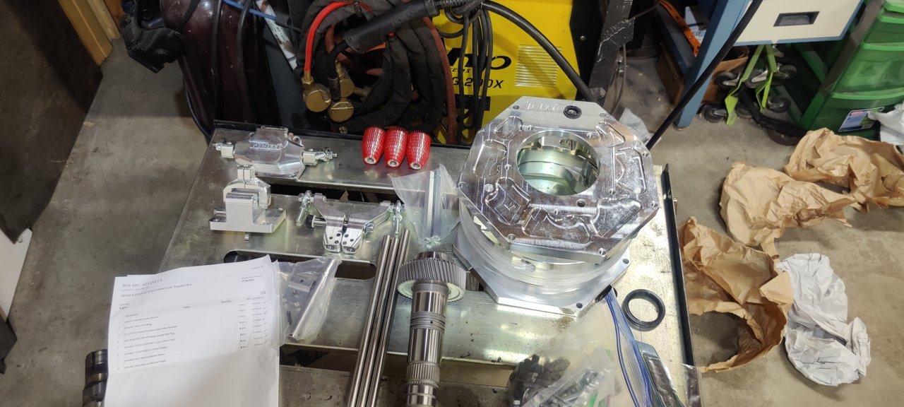

    An atlas requires a lot of cutting incase anyone was wondering. 342C5A58-6A12-408A-9B51-898682CA59FE.jpgA872280A-2E1A-40BC-A771-A579EDC10620.jpg

    I still need to cut a little more but it’s really close there.
