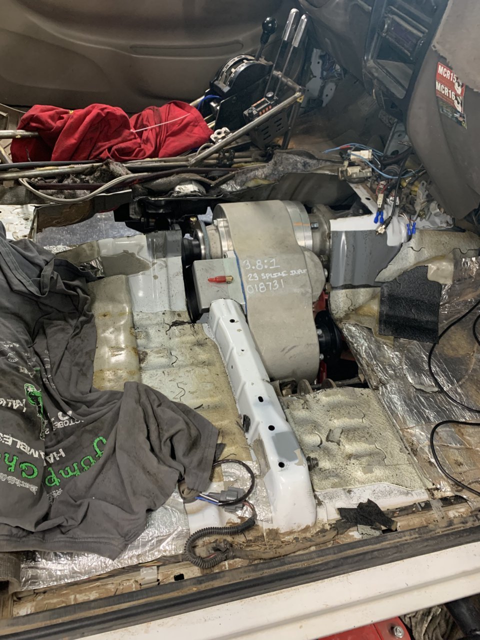

    Yeah both are bent. 2”x.25 isn’t strong enough. Either I’ll get some 2.5x.5 wall and try that or sleep some 2”x.25 wall with aluminum. I don’t remember hitting them either but they’re all scraped up
  7. Jul 20, 2022 at 7:36 PM
    #3027
    malburg114
    malburg114 Well-Known Member
    Dec 26, 2012
    #93766
    3,820
    Las Vegas, NV
    2001 Toyota Tacoma TRD
    Odd question, do 1st gen tacomas need a speed sensor and kickdown cable to move? Mine won’t have either but still have the auto ecu so wondering if that’s going to cause issues. I don’t need the speedometer to work right away but getting short on time.

    Yeah I’ve unplugged that before and ran it without that so I know it’ll work with the transmission unplugged. New transmission doesn’t have any electronics or lockup so trying to determine if the ecu will think something is wrong and put it in like limp mode or not send power without the lockdown to the throttle and the other electronics

    Yeah I had someone else suggest just finding the wiring for the neutral safety switch and wiring that to always on maki g the computer think it’s in neutral all the time which would work

    You won't have limp mode or issues like that, but you will need to do some wiring or else you won't have a starting circuit, reverse lights, or cruise control. When I did my 5-speed swap (not a 1st gen Tacoma but a 3rd gen 4Runner, so I assume it's all the same), I kept the auto ECU in it for a little while before I was able to get the manual ECU working right (immobilizer issues, but that's an entirely different topic). Other than the few CELs the auto ECU threw for "transmission shift solenoid malfunctions" and things of that sort (obviously since the A/T wasn't there anymore), the auto ECU ran perfectly.

    What does the starting circuit do? Based off the name I’m assuming that’s what starts the trucks and it won’t start without doing that wiring? I’ve already stripped the cruis control and not worried about the reverse lights and the cel light is always on from no cats and other things so the main thing I’m concerned about is if the truck will drive without any of the electronics on the transmission (new transmission is a full manual automatic) and an auto ecu.

    Your auto ECU won't allow your engine to turn over unless your transmission is either in park or neutral (hence the name Park/Neutral Safety Switch). To bypass this, it's as simple as jumping the wires at the 5 & 6 positions, just cut those two wires before the switch, and tie them together. Completing the circuit there will tell the ECU it's safe to start, and allow your engine to turn over.
    Note - your switch connector may not look exactly like this (I'm really not sure what they look like on Tacomas, this is how it looks on my 99 4Runner), so you may have to check an EWD for your specific vehicle. It should be the two thickest wires though, all the other wires are a little thinner.
