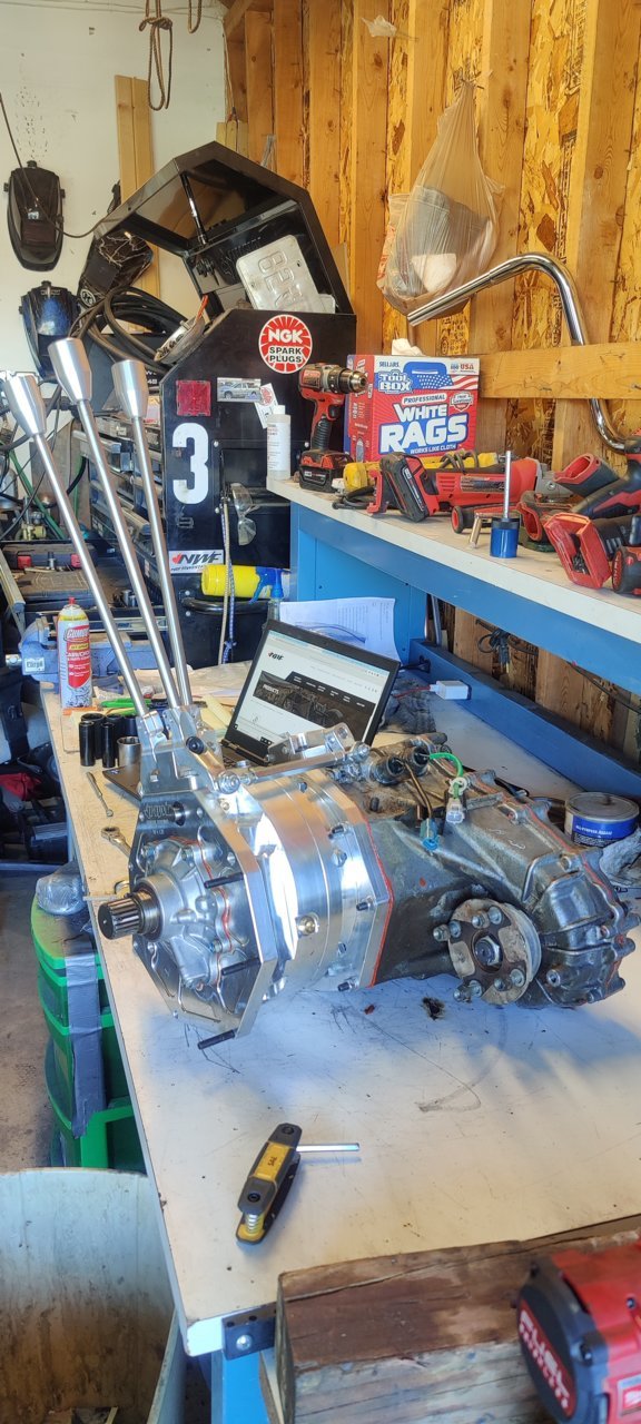

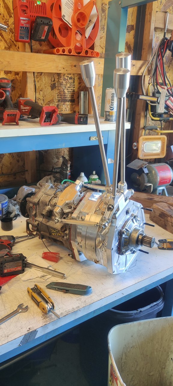

    Finally got the fj case and eco crawler together, new clutch going in, then need to get the driveshafts made up

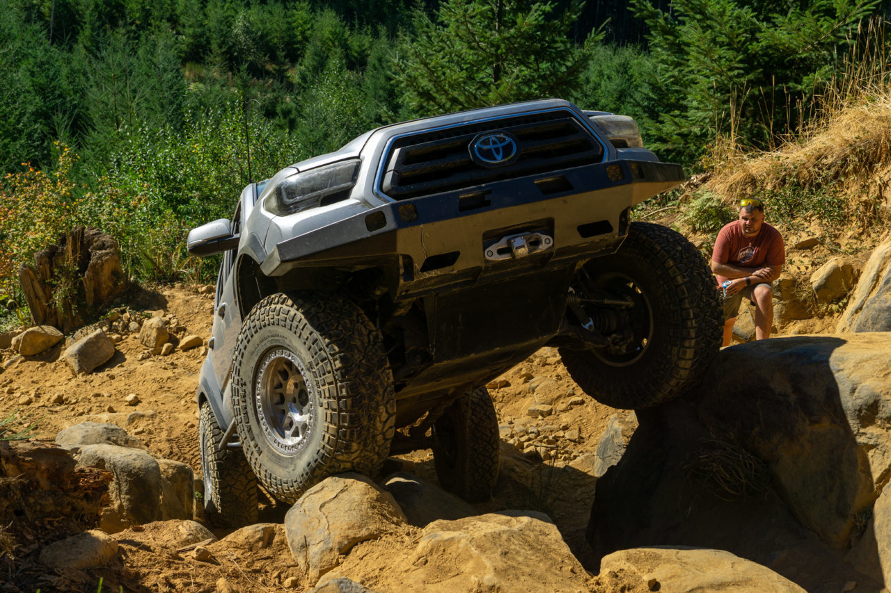

    Couple trips in with my failgear dual setup. Got the adaptor kit off of Poly Performance for $800, picked up a Tcase for $80, 23 spline sumo input for $140, and had new shafts made/retubed for $550 with a 3/16" wall rear. Also put a poly mount under the crawl box. No real extra noise, maybe a hair in high range, with low range being just as noisy as my stock case. Never had an issue with the trail gear stuff on past setups, so went with them again.

    So ya never had any issues with it but call it failgear? Lol

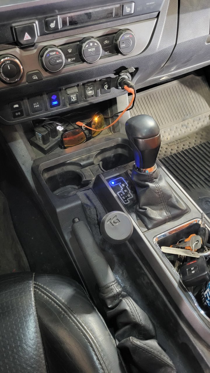

    Everything is in and functioning. Test drove it last night. Ended up just engaging the ADD actuator and then leaving the 4wd ECU unplugged. Everything shifts smooth :burnrubber::turtleride:

    Shifters look great. Congrats on the install, you're going to love it!

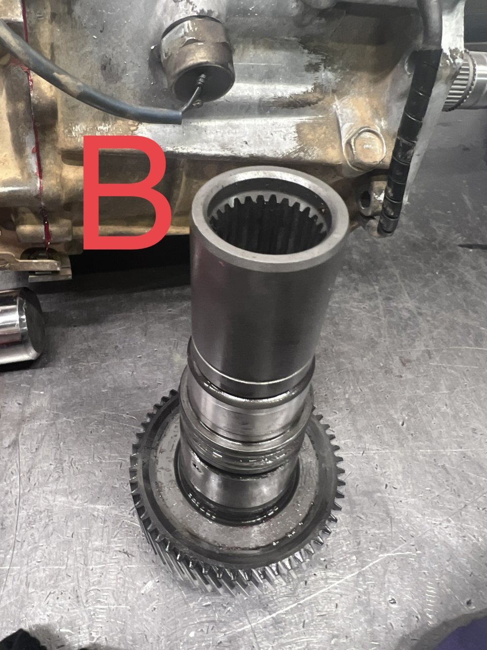

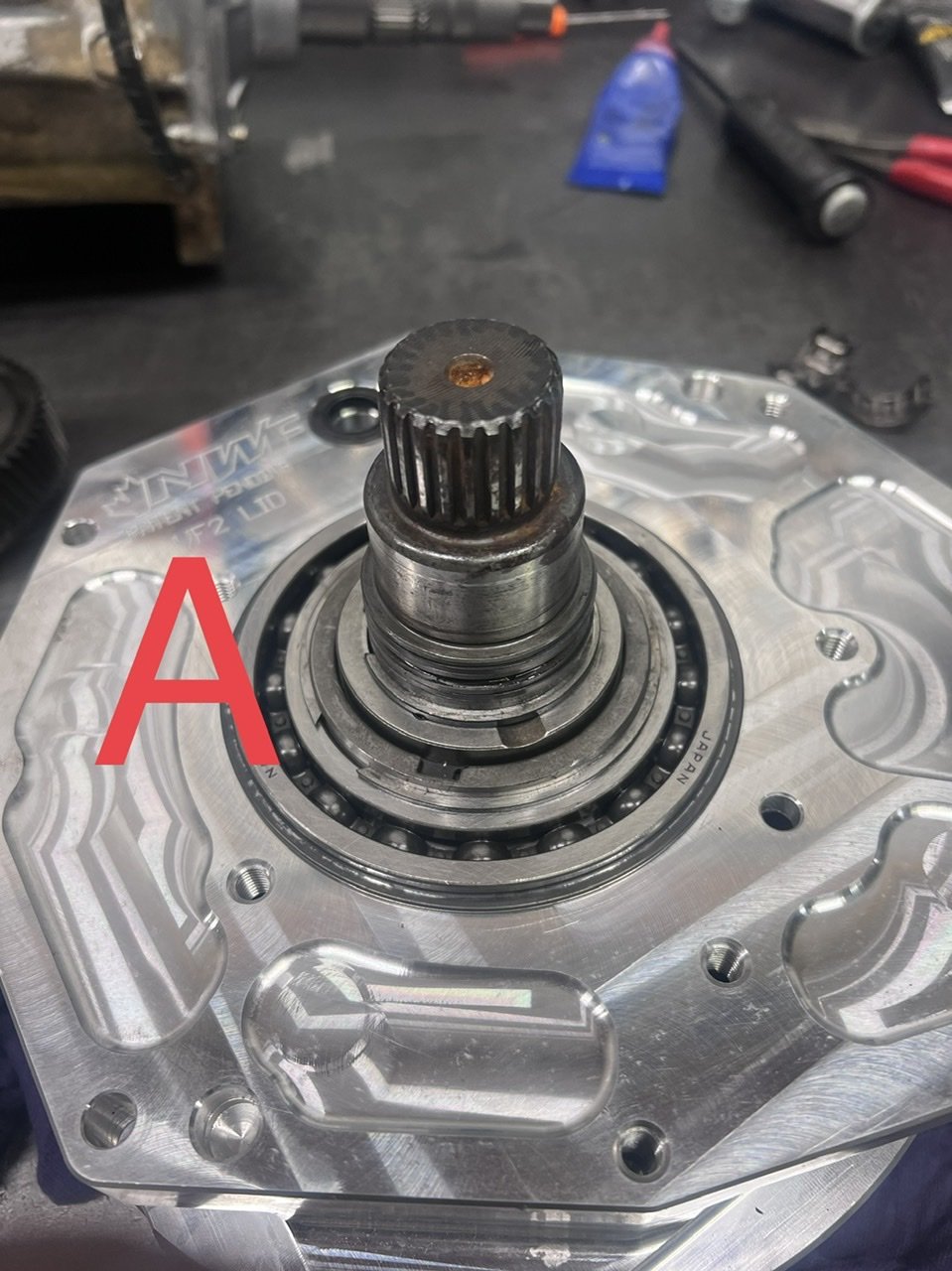

    Which is the correct input shaft for the nwf ecobox into a 2001 Tacoma 5vz automatic?
  20. Oct 18, 2022 at 8:55 AM
    #3080
    Team_Jake
    Team_Jake Well-Known Member
    Jun 18, 2018
    #256764
    136
    '99 4Runner Limited '01 Tacoma Xtracab
    Option B.
    It should look exactly like this when all put together. This is mine I put into my 1999 4Runner 5VZ, R150F MT (which is the same output / mating surface as the A340F AT)
