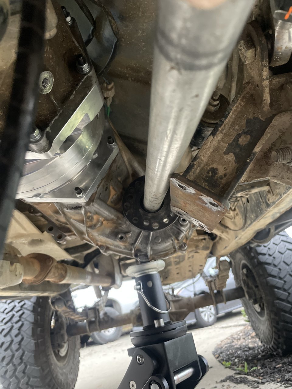

  6. Jan 7, 2023 at 5:49 PM
    #3086
    Tof-Corey
    Tof-Corey Well-Known Member
    Jan 17, 2019
    #279655
    138
    Concord. CA
    2004 silver double cab
    KPD60/14B rear
    Having driveline interference with my wfo crossmember. I have a fror tcase crossmember I can install, but am I able to eliminate the transmission crossmember altogether and just run the tcase mount off the back of the rear case?
    anyone have similar issues and can recommend a work around?
  7. Jan 7, 2023 at 5:52 PM
    #3087
    Tof-Corey
    Jan 17, 2019
    #279655
    138
    Concord. CA
    KPD60/14B rear
    @02hilux did your lunate your transmission crossmember and just run the tcase crossmember?
  8. Jan 7, 2023 at 6:12 PM
    #3088
    02hilux
    02hilux What do you mean there’s no road, I’m here
    Sep 14, 2016
    #197244
    6,481
    Planet: EARTH
    o_O
    Lunate? Or did you mean eliminate?
    If you mean eliminate, yes I did. I cut off the factory transmission xmember. If not, it will bind with the upper link.
    Tof-Corey[QUOTED] likes this.

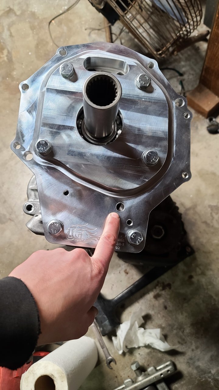

  15. Feb 21, 2023 at 8:18 PM
    #3095
    ForestRunnerFrank99
    ForestRunnerFrank99 Well-Known Member
    Mar 10, 2019
    #286162
    1,108
    Josh
    Rancho Cucamonga, CA
    '99 TRD 4x4 Manual 3.4l v6
    Fox Coil-overs, Dakar Leafs, Intake, Tires, Rims
    Any one know what this hole is for?
    Working on installing my dual cases and can not figure out why this hole is here. The only thing I feel like it's gonna do is dump oil between the transmission and t-case.
    I thought maybe it was a dowel pin hole but the dowel pins are on the left and right and the ID is different.
  16. Feb 22, 2023 at 5:59 AM
    #3096
    ToyRyd04
    ToyRyd04 Taco Transformer
    Aug 5, 2011
    #61217
    1,900
    Greg
    Perryville, MD
    '04 PreRunner
    SAS'd PreRunner Diamond Axles Crawlbox
    Spot on, yep oiling hole as the cavity (transmission extension housing) is now used to increase oil capacity.
  17. Feb 22, 2023 at 6:04 AM
    #3097
    02hilux
    Sep 14, 2016
    #197244
    6,481
    Planet: EARTH
    Work great for MT for increasing capacity, not so much for AT. For the AT owners, if the extension seal is knick or damaged during install, you will likely damage your AT by mixing gear oil and ATF. AT don't work well with gear oil.
  18. Feb 22, 2023 at 8:46 AM
    #3098
    Dan8906
    Dan8906 Well-Known Member
    Jul 26, 2016
    #192977
    5,151
    Daniel
    Concord, California
    2004 Tacoma ext cab TRD 4x4
    CBI sliders, ADS extend travel with compression adjuster coil overs, 9” Bilstein 5125 rear shocks, Icon Tubular UCA, Alcan custom leafs, All Pro Apex bumper and skids, NWTI rear diy bumper, 295/70/17 Cooper St Maxxs and nitro 4.88s.
    I haven’t had any issues with my AT but I wonder if plugging that would be a better option
  19. Feb 22, 2023 at 9:23 AM
    #3099
    betterbuckleup
    betterbuckleup Well-Known Member
    Jun 26, 2017
    #222483
    4,832
    Ian
    Concord, CA
    2000 Tacoma SC 2.7 4x4 5spd
    Fluid is also able to pass through the adapter plat at the top input bearing. The lower passage just gives it another place to flow back to the case at a lower point. Plugging it wouldn't prevent fluid from entering that cavity.

  20. Feb 22, 2023 at 9:29 AM
    #3100
    02hilux
    Sep 14, 2016
    #197244
    6,481
    Planet: EARTH
    When I was researching about crawlbox install, I read a few articles about AT owners blowing their transmission on steep climb/drop causing ATF/gear oil to mix and getting pushed back into their transmission. Typically, this occurs when the extension seal is damaged or installed incorrectly.
