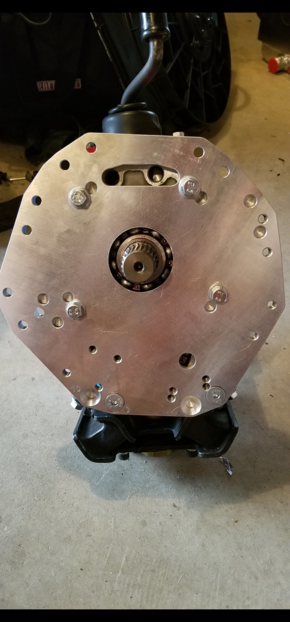

    Something is off. You either have the wrong adapter, or an incorrect tcase/tcase housing you are trying to install.
    Crawlbox housing should be mounted to that adapter and it has a flat bottom like so.
    Yours has a slope with a protruding notch at the bottom.

    Not sure about the flat notch honestly. Pulled it out of a turbo pickup (87?). It's worked fine for the two other trucks I've had it in.
    There is one other hole on the left side I had to fill with JB because half of it was exposed when fitted to the trans.

    Looks like you got a adapter plate for a 2nd gen Tacoma. You have a 1st gen Tacoma right?

    That is correct. I'll be giving Marlin a call when they open up today and talk to someone. I'd like to see a 2nd gen tacoma plate vs the one I have, pictures from the vendors website aren't too informative

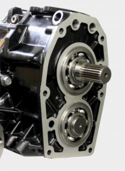

    Here's a MC31 for a 1st gen. Your adapter is different but it might be because it's inchworm. It is wider than normal.
    Tacofire98[QUOTED] likes this.

    Just got off the phone with Marlin. Before I could even finish explaining the problem, he told me they sent out the wrong plate. It's a universal mounting for the 3.4/4.0 applications. The difference being they mill out the countershaft larger for the 4.0s. Returning this plate and having a new one shipped out.

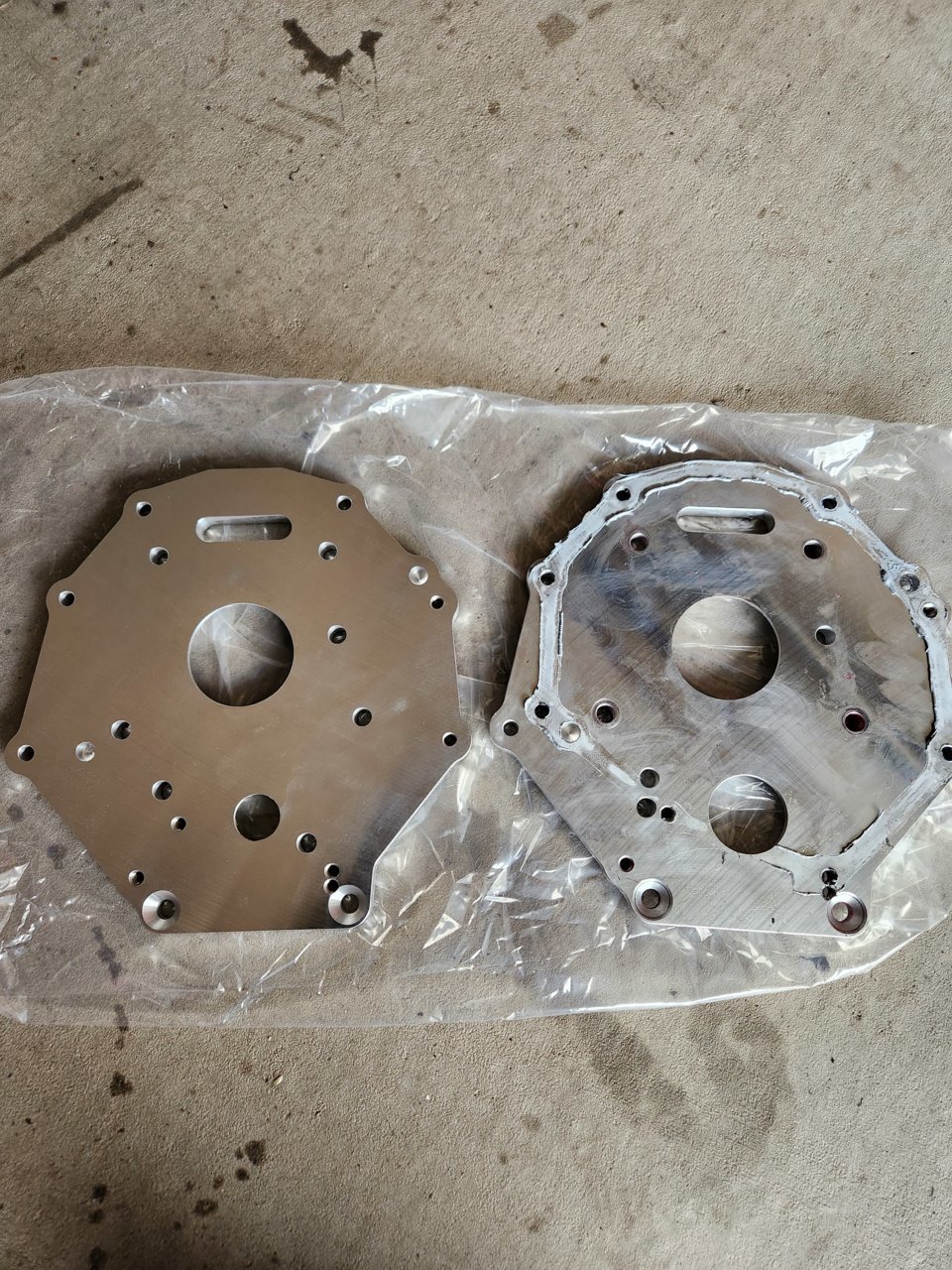

    New Marlin plate arrived. Props to them, shipped to CO in under 24hours from placing the call.
    For future reference, here's a side by side.
    3.4 on left. 4.0 on right.
    26mm vs 43mm countershaft hole.
    Wulf, Wishbone Runner, jubei and 2 others like this.
  8. Mar 15, 2023 at 2:59 PM
    #3128
    02hilux
    02hilux What do you mean there’s no road, I’m here
    Sep 14, 2016
    #197244
    6,472
    Planet: EARTH
    Must be the inchworm designed. Their mc31 don't have the countershaft hole. Interesting

    i dont feel like my inchworm has that hole either. but i dont have any pics and dont rermember
    this pic doesnt show it either and this is from their facebook page when thtey were still around

    They don't offer the mc31. Only the inchworm product. I would've bought the marlin if I could

    Had to look it up (thought it did), my og inchworm does has the hole, that uses the extension housing cavity for additional fluid capacity.

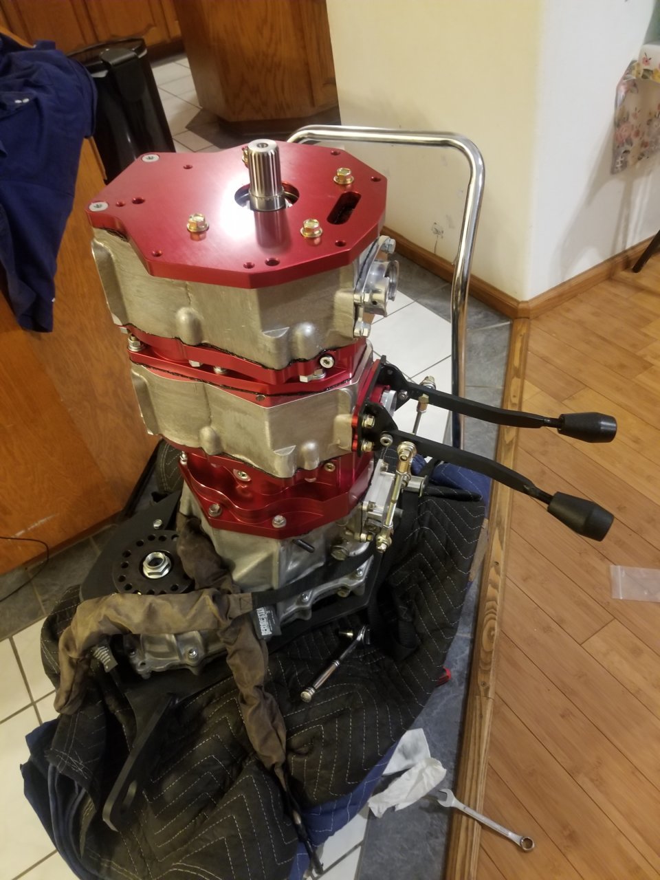

    Finally got rid of my bolt for a shifter and closed off the shift lever holes to the transmission tunnel.
    Also added short throw shifters.

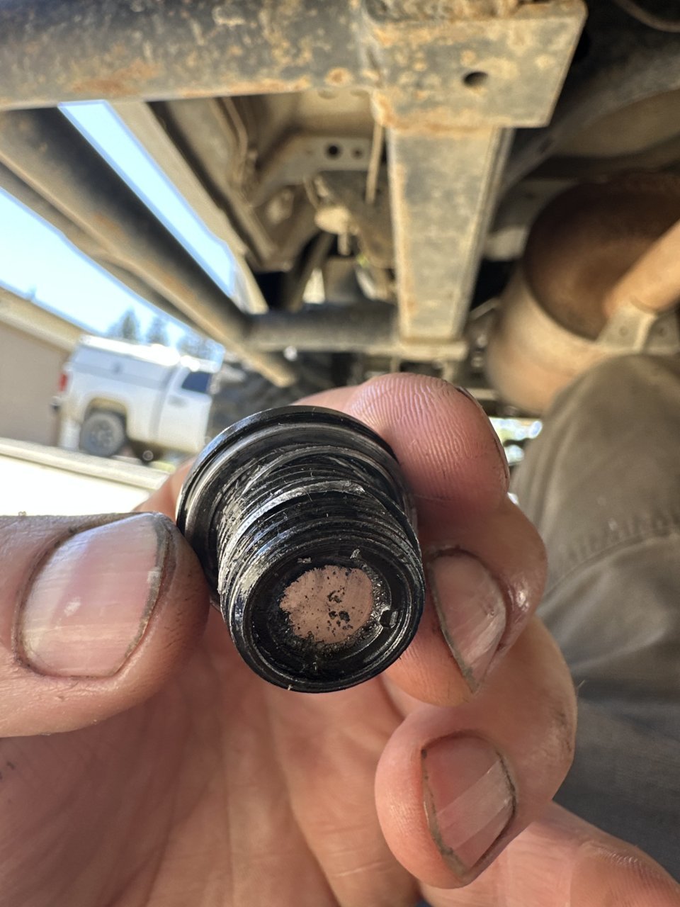

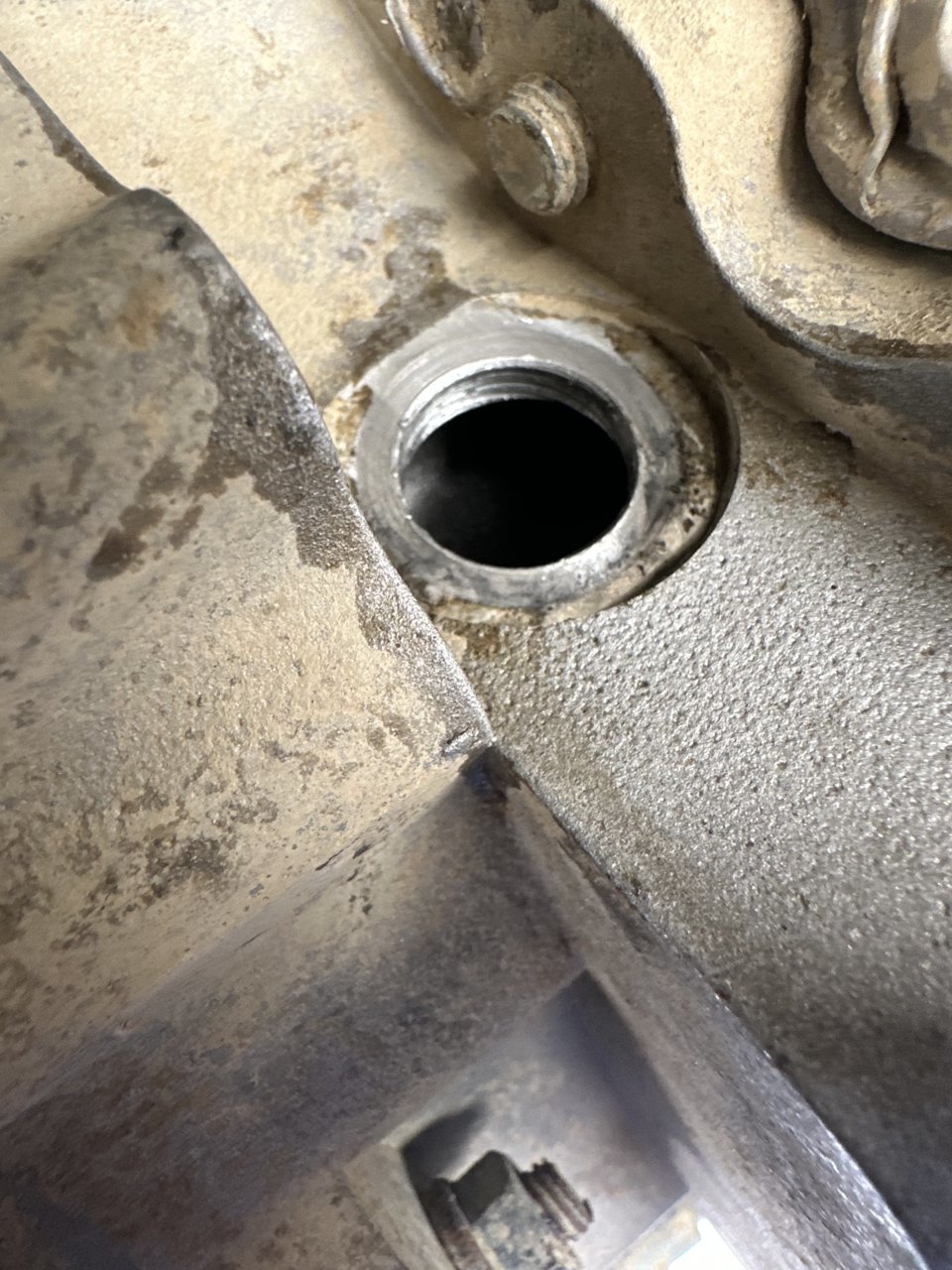

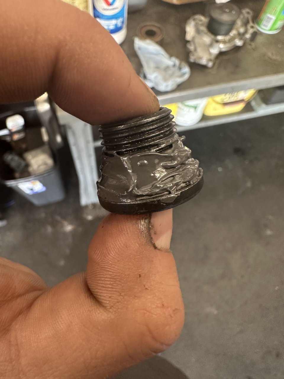

    Had an interesting problem, drained my crawl box and filled it and when I was going to reinstall the fill plug, it literally stripped the threads out. It never got tight. I was ready to flip the truck over lol. Long story short the plug got jb welded in place and I’ll be filling from the top.

    02hilux
    Sep 14, 2016
    #197244
    6,472
    Planet: EARTH
    GOD DAMN TG :annoyed:

  15. Apr 13, 2023 at 8:00 PM
    #3135
    Dan8906
    Dan8906 Well-Known Member
    Jul 26, 2016
    #192977
    5,151
    Daniel
    Concord, California
    2004 Tacoma ext cab TRD 4x4
    CBI sliders, ADS extend travel with compression adjuster coil overs, 9” Bilstein 5125 rear shocks, Icon Tubular UCA, Alcan custom leafs, All Pro Apex bumper and skids, NWTI rear diy bumper, 295/70/17 Cooper St Maxxs and nitro 4.88s.
    Yeah I was pretty disappointed.
  16. Apr 13, 2023 at 8:06 PM
    #3136
    02hilux
    Sep 14, 2016
    #197244
    6,472
    Planet: EARTH
    Got to be careful with the drain plug now
  17. Apr 13, 2023 at 8:47 PM
    #3137
    Dan8906
    Jul 26, 2016
    #192977
    5,151
    Daniel
    Concord, California
    Yeah luckily the drain plug has more threads. The fill is like 3/16” thick. Had like 4 threads
