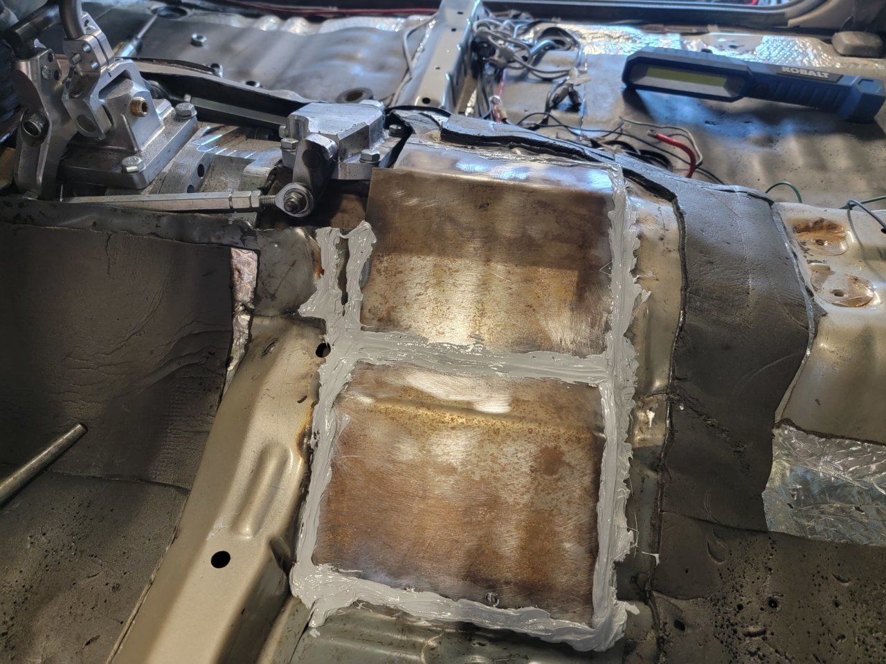

    Did you do any body lift, or just rebuild the entire tunnel and some floorpan?

    No body lift. I had to cut a big ass hole in the floor and patch it back in.

    Any interference to the seat? And I'm assuming you're a manual? I'm hesitant to cut out my floor and re-build it, but at the same time... I'm about to build the crossmember and would rather only do it once. lol
    And did you have any issues on the front end of the tunnel by the bellhousing with the exhaust? I'd think moving everything up that much would cause issues there too. My trans pan is super low..

    This is on my 1st gen manual, so not sure how helpful any of that info would be.

    Mine's a 3rd gen runner automatic, so not far off. I'd imagine it's an almost identical floor pan.

    Ah,
    Seat rail clearance is super tight! I have Corbeau seats and brackets though, not sure how it would compare to stock anymore.
    No issues with the exhuast, aside from deleting the 2nd cat for more clearance for my new crossmember.
    There was a handful of other small issues I ran into like fuel filter and ebrake bellcrank clearance.

    All good info. Thanks! Got my exhaust cut out to re-build to clear the new driveshaft and crossmember anyways, that second cat probably won't go back on as it's some shitty aftermarket high flow and throws a code anyways. Already thinking about moving that fuel filter too.
