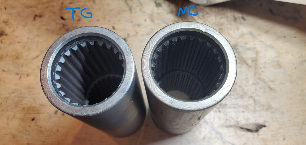

    Just got a new TG 4.7 crawl box for my 3rd gen Tacoma. Anyone have any issues with the splined coupler that goes from the trans to the crawlbox? Brand new mine has some play in the splines. Compared to the factory coupler I removed from the t case it’s about 10 thou larger od. The splined portion on the t case that goes into the back of the crawlbox seems to be a nice fit. I feel like the fitment should be tighter (like factory) to avoid issues on and off throttle when driving, and going from drive to reverse when wheeling. And reading through the thread I should be putting anti seize on all the splines to avoid issues?

    Can't speak to the 3rg gen, but I run MC gears with TG adapters. I had to use the MC coupler because the TG one wouldn't fit over the MC splines. The fitment onto the trans side was also different between couplers which doesn't makes sense. I think the TG quality control just isn't there.

    The fitment is not terrible, just don’t know what it should be or what to expect, it’s not the same tolerance as the coupler I pulled off. So just don’t know if I should be concerned. Of the people that have installed these. Are you guys sealing up these areas on the front/trans side of the crawl box? Or just sealing the mating surface and letting the gear oil fill the area between the trans and crawl box?

    This will make you sleep well at night: https://irate4x4.com/threads/trail-gear-trans-to-t-case-coupler-failure.395717/
    As for sealing it up, just seal around the edges where it mates to the trans. The oil that spits out the top by the shifters will drain back into the crawl box through one of the lower holes. If you have a 5spd you will need to cover the backside of the tapped bolt holes for the trans mount bolts on the trans up with JB weld or it can leak out of there. Scuffing up that smooth surface will help the RTV stick to it. I always use permatex "the right stuff" on my crawl boxes.

    Funny enough, it’s probably the MC side that you had an issue with. I know on the mini truck stuff, MC’s 23 spline is only compatible with MC’s 23 spline because it’s considerably larger than factory or TG 23 spline. I just had this issue with my NWF ecocrawler to RF1A where the sumo gears 23spline is a copy of Marlin and had to be machined down to fit into the factory 23 spline output.

    When I compared them, they were roughly the same size. the spline profile is what was different for me. the MC splines also had a larger major diameter preventing the TG coupler from fitting.
