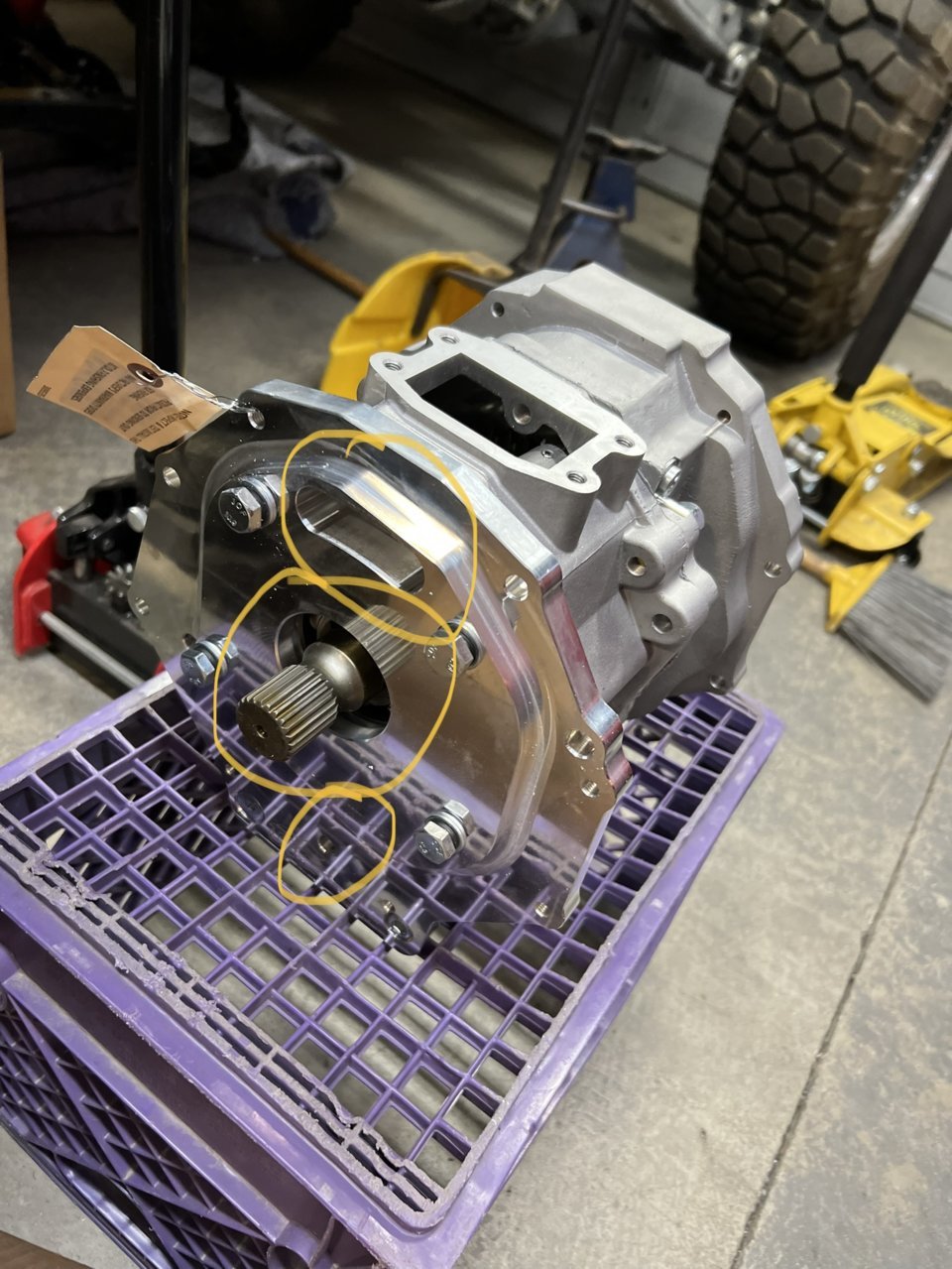

    It really sucks that I’ve already cut a hole for my shifter and sent my driveshaft to be resized and I’m only now realizing this issue. I don’t really want to install it now after reading that pirate tread unless the adapter is better fitting like the stock one I pulled. Do we know what material is used to possibly have one machined out to the correct spec?

    Tested it, mounts right up no issues. The splines on the t case seem to fit the crawlbox nicely, but the other side is the issue.

    So the only issue with TG is the coupler? What do I do about that? Get a marlin, or custom made? We do know the material used, I assume it heat treated and needs to be pretty tough. I’m already into this case money, time, driveshaft, hole in the floor, beat the hell out of my body. Need this to go in asap for my rubicon trip at the end of the month. Anybody have any suggestions on what to do?

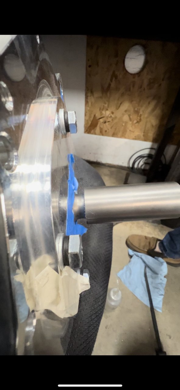

    I called marlin and spoke with Kyle. Cool dude. He gave me specs on their coupler and sent me one. His measures 3.75” vs mine at 3.72”, the od is 1.375 on his vs 1.57”
    On mine. And the 23 spline is a slight interference fit so it should be nice and tight. I don’t think the od matters because nothing rides on the coupler. I don’t see why it wouldn’t work. I can easily take it down to 3.72” if that would even be needed. Will update with my findings when it arrives.

    Ok update on my issue. Marlin coupler came in, I got it yesterday and right away the fitment was a little too tight but the spline interference was not much. I spun the trailgear box and cleaned the OD of splines with a scotchbrite pad. Took the slightest bit of material off, roughy a thou and now the coupler fits perfectly. Absolutely ZERO play in the coupler, fits like it was made for it. The length is slightly longer than the trailgear 3.72”vs Marlin 3.78”. But the coupler fits properly with all of Trailgear’s stuff, I’ve test fit the crawlbox and it doesn’t bottom out or interfere in anyway. The trans side is a press fit and t case is now a very tight slip fit. So for anyone wondering, if you TG crawl box splines/trans splines are still in good shape and not damaged you can get the Marlin to work. Taking off the slightest material did not change how the TG coupler fit because of how the splines engage. The TG splines come to more of a point vs the Marlin more squared off like the factory coupler.
