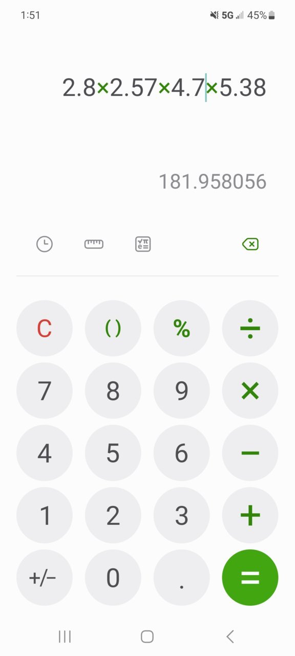

    the 2.8 is the auto 1st gear ratio? If yes then yeah that makes sense. I was hoping for someone with some real world experience might say a setup like that wil work good or if I should definitely use a 4.7 type option in one of the cases (or even the NWF with a 2 speed 3.8 or 4.3 atlas)
    I know it comes down to how slow and how strong

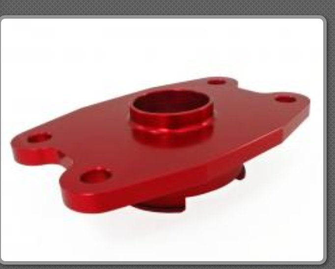

    Crawlbox is leaking like crazy out of the shifter housing. Clearly coming from the shifter/ball area. Anyone have a fix for this? Doesn’t seem to be a pressure issue, seems like oil is being directed right at the shifter while driving full time. Truck is covered in oil from about 100 miles. Canceled my rubicon trip because of it.

    Do you have an oil slinger installed?

    I do not have that. Will order one right now. Trailgear is useless when it comes to questions or issue with literally anything.

    I’ll Order this one. Looks nice, if it solves the leak I’m 100% for it. You daily your rig or put street miles without issues/leaks?

    I run the same shifter, just had a 200+ mile drive to an off road park this weekend and back no leaks. Nice shifter base and oil slinger combo, make sure to rtv/seal the shifter base to the tcase and you'll be good to go.

    Hell yea, thanks a lot!! All this work, trip canceled, I was getting really bummed out with the truck covered in oil all on my new stuff.

    Just to clarify, the duals with 4.7 would use the gear driven case with is 2.28:1 so I believe the math is 2.8x2.28x4.7x5.38 = 161:1
    (Still a lot lower than 99:1, but just wanted to point that out in case anyone else is looking at this to help make any similar decision)

    Thats if you are using two gear drive cases. His math was retaining the chain drive case which has a lower stock ratio of 2.57.

    So you're ditching the chain case and switching to both gear driven passenger drop rf1a case with the 4.7s in the rear and 2.28 front? If that's the case, yes.

    You are correct. The chain case will have a lower ratio vs the gear.
