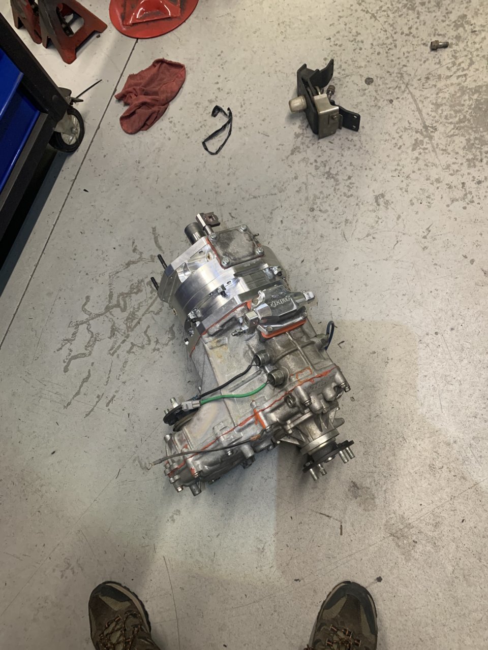

    She goes back in tomorrow just got my new shifter housing, what gear oil weight you guys running?

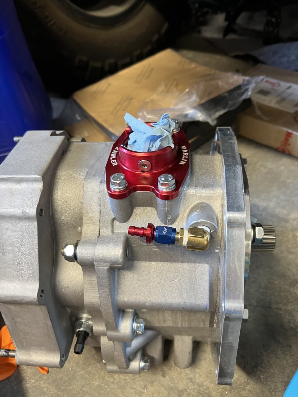

    Vent?

    Yes the lower was a BS test to see if it would help stop the oil coming out of the shifter. Fill plug will go back in. But the upper is now the vent. Lower was put in while in the truck. Now that I pulled the case to attempt to stop the leak out of the shifter I used that top hole as the vent.

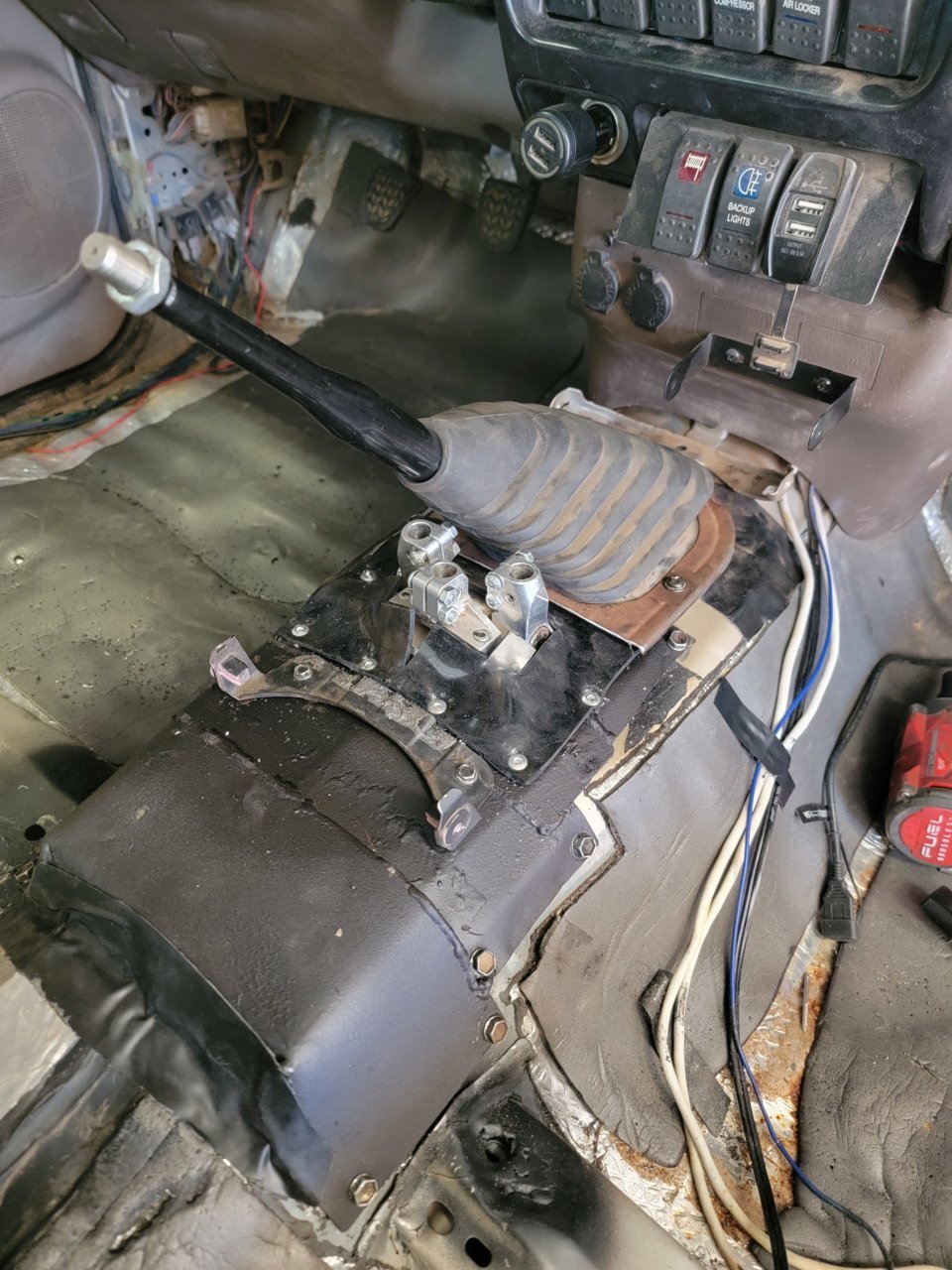

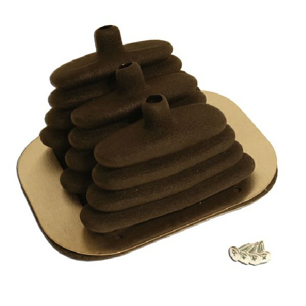

    Take 2 at sealing up my hacked up floor and trans tunnel. Much better this go around.
    Still would like to find a proper shifter boot that works with the NWF setup.
    Speaking of which, I have a triple stick shift boot that didn't work. I would be happy to send it to someone who can use it.

    Tagging @Kerleyfries since he just got his NWF triple stick setup installed and might have the boot worked out.

    I used a boot from wildhorses.com it worked well for me.

    Yeah, I think that's the one I bought. Unfortunately no way to make it work on my 1st gen.

    Ok, I didn't realize you had a first gen. It worked pretty well on my second gen. I had to do a little modifying but not much.

    I need a new boot after I cut mine up. I need to do the same as you. Can't have my windows down on the highway without hot air funneling into the cab through some small holes.

    I thought these vented with the chain case?
  15. Aug 9, 2023 at 9:38 AM
    #3275
    Anderson5290
    Anderson5290 Well-Known Member
    May 30, 2018
    #254979
    758
    Brandon
    Corona, Ca
    2018 Tacoma TRD OR 4x4
    Tuned Fox 2.5 resi with dsc, JBA HD UCA, total chaos knuckle gussets, rear trd pro fox shocks, Deaver U402 stage 1 rear leafs, archive garage u bolt flip with fox 2.0 air bumps, White knuckle off road rock sliders, BAMF 1/4” steel skids, Magnaflow exhaust, Archive Garage Hammer Hangers, Cbi high clearance rear bumper, 285/75/16 tires.
    They do not vent with the chain case on my 3rd gen. The chain case is completely sealed. Trail gear tried to tell me it vented through that case as well which is absolutely not the case. I believe adding this vent and the oil slinger as others told me to add is the reason my case is no longer leaking out of the shifter area.

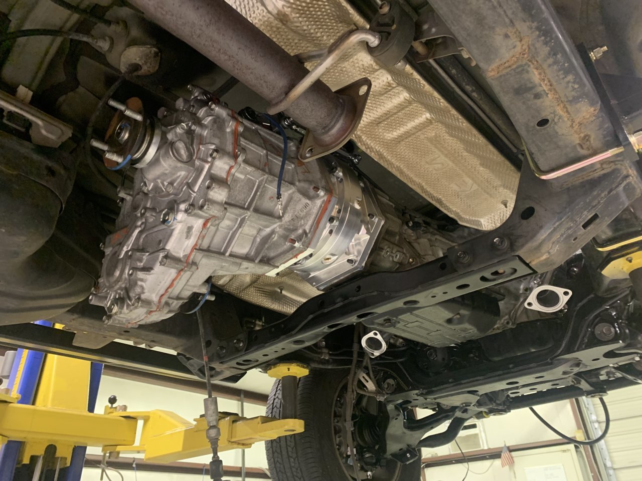

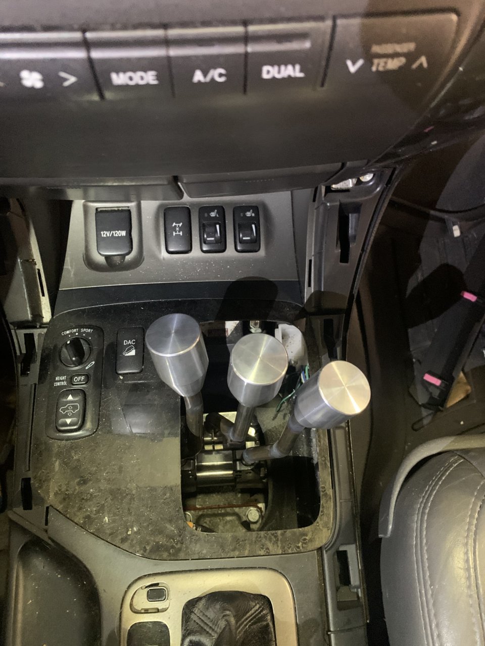

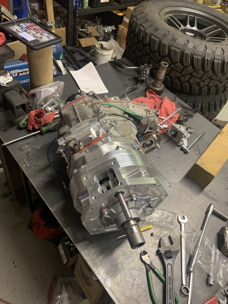

    I guess I can contribute to this thread now.
    GX470
    NWF eco box with trident shifters
    4R/FJ rear case

  18. Aug 10, 2023 at 1:50 PM
    #3278
    cynicalrider
    cynicalrider #NFG
    Jul 25, 2012
    #83399
    17,196
    Jersey
    01 SR5 TRD 4x4, '23 Bronco Wildtrak, 2017 HSQV FE350
    Drop bracket lift and booger welds
    Body lift? Seems like everything sits super low.
  19. Aug 10, 2023 at 1:57 PM
    #3279
    SearArtist
    SearArtist GX poor
    Jan 5, 2016
    #174151
    18,981
    NC
    GX470 & GX460
    Things
    correct. 1” body lift. No way it would have fit otherwise, without some serious BFH action.
    the 2nd to last pic you can see the trans is resting on the crossmember. The mount hadn’t been installed at that point.
