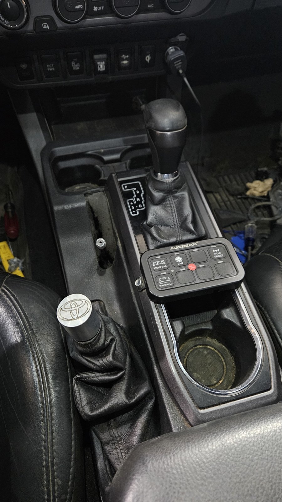

    Just over a year and around 40k miles on my Tg crawlbox in my 3rd gen, still runs pretty quiet. Same shifter leak like stated a couple posts above, and eventually stops once its below the fill level haha. Fluid hasnt been changed since put in and was about the same dirtyness as a diff fluid change.
    Just threw in a Fj manual tcase to add another shifter in. Still need to make a crawl box boot (been saying that for a year)
