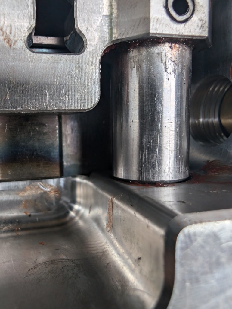

    Do you remember the case design on the NWF box? Pretty sure there is a design flaw that lets the pin come all the way out of its hole in the new revision of the crawl box. I welded a stop to not allow it to over throw but I'm calling NWF tomorrow to see what the deal is.

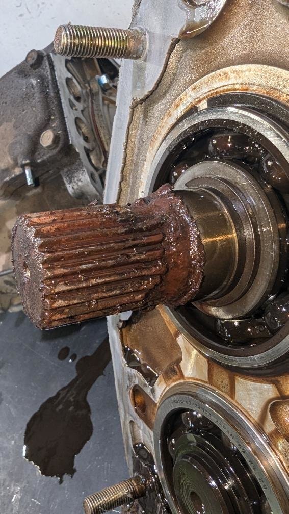

  4. Aug 25, 2024 at 4:04 PM
    #3324
    TacoEspecial
    TacoEspecial SSSlow
    Jul 19, 2017
    #224500
    1,642
    Mark
    Sacramento
    13 Sliver TRD AC
    BAMF RCLT Deaver Fox 2.5 StopTech Dana 60 37s 475:1

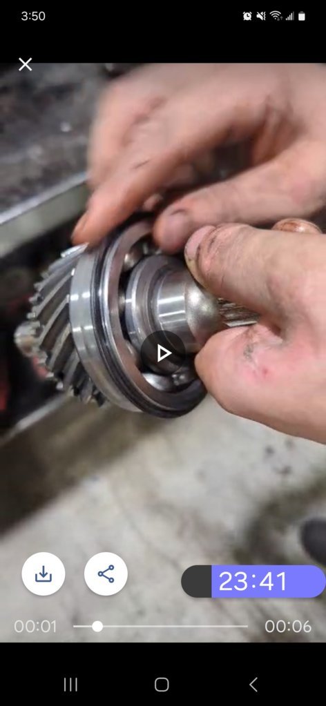

    This bearing sounds pretty bad
    Replacing all the bearings and seals

    I'm pretty sure it's the new revision as I didn't receive the crawl-box until the end of May.

    Yup mine did the same thing. Luckily it happened on the bench before I installed it.

    Pretty sure it happened to me coming down from Red Cone Pass. Paying for the tow from Breckenridge was enough to get me to sign up for AAA.

    On mine the pin in the eco crawler falls out of the hole

    Calling today. I found it over the weekend doing the install.

    that’s bad. the spline fretted and
    broke apart?
