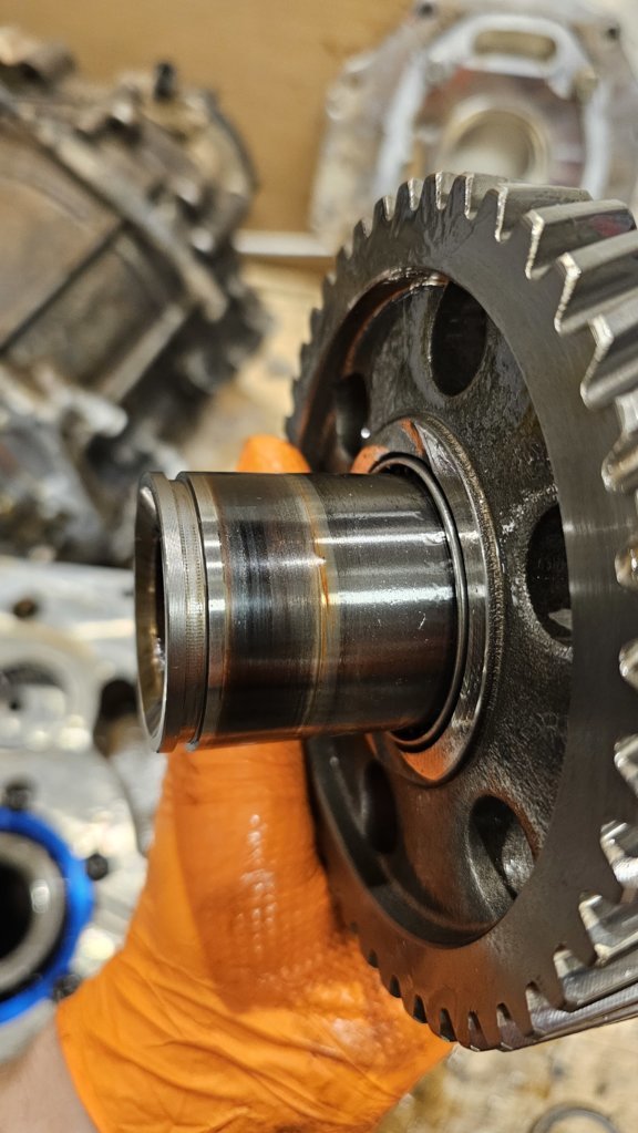

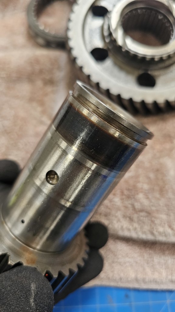

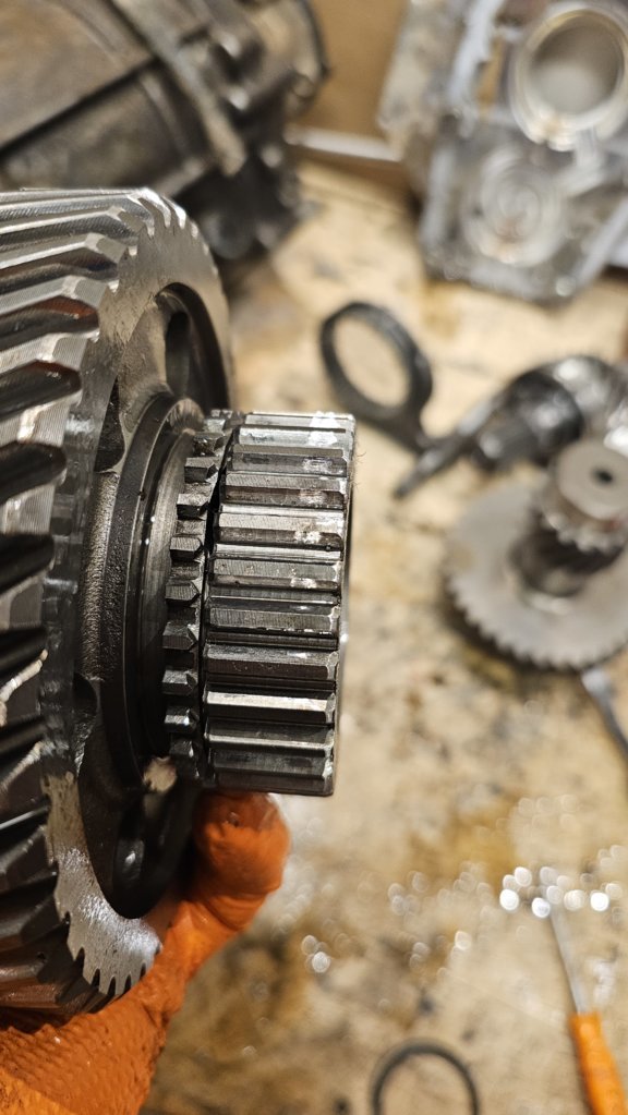

    Finally got my cases out and broken apart. Nothing blatantly broken, so I dunno what was causing the original new recent noises I was hearing.
    Not sure what to make of this what looks like heat affected zone on the end of the rear case coupler that rides in the bearing on the rear adapter. Looks like the coupler was spinning inside the inner race of the bearing.

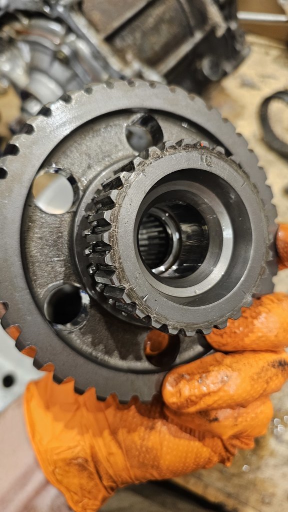

    Also some wear on the other male spline end of the coupler.
    It's my first time pulling these back out after my initial install ~30k miles ago, so not what the norm is as far as wear goes. Any opinions/advice welcome. As of now, I'm planning to just throw it all back in.

    Rear coupler is most definitely spinning in that bearing.
    At a minimum I would get that bearing out of there and replace it.
    If the truck can be down for a few days, I would look into if the TG adapter can handle/fit a dual row bearing.
    https://www.marlincrawler.com/docs/mc07/index.htm Good read, don't focus on the 101% better but more on the research and measurements which are good.
    How does that shift fork coupler that rides on the male coupler look? What's the teeth look like? Appears to be a lot of back and forth abnormal wear.

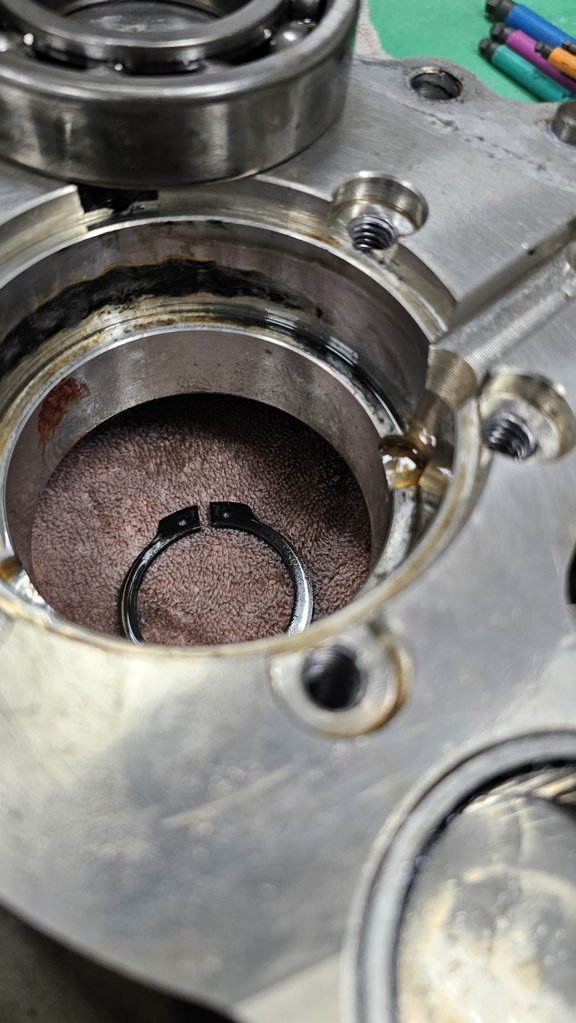

    Biggest thing on the the double row is to not use the fill slot type as that was known to have issues. MC was big on it not being issue, but had a few customers proved otherwise on forum posts. Tried clocking the fill slot at 12* position but still had issues. So the MRC 5209CG was tested and tried in Inchworm adapters to remedy this problem before that got out of the business. I know MC still sells adapters under Inchworms design, but not sure which bearing style they use now.

    Wym fill slot type?

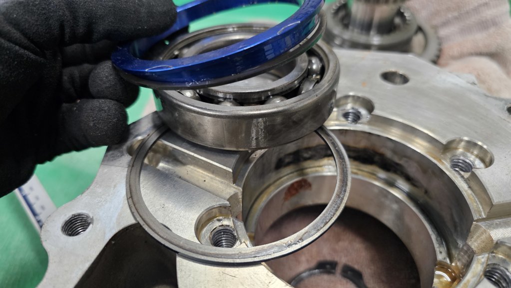

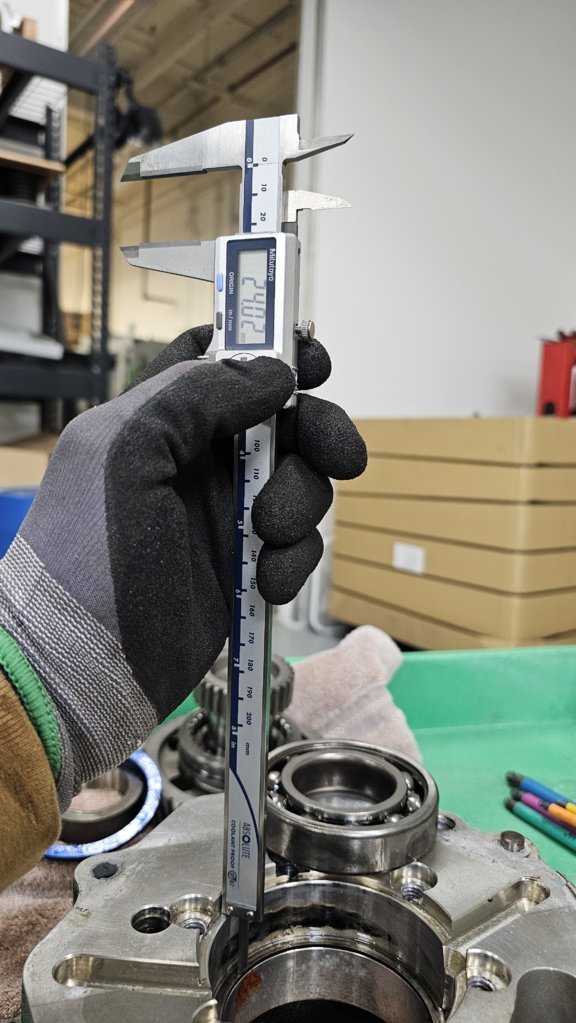

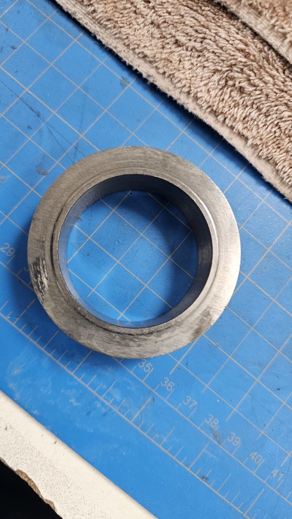

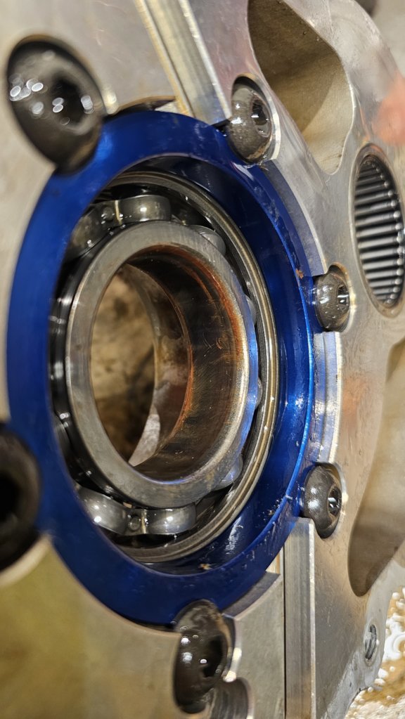

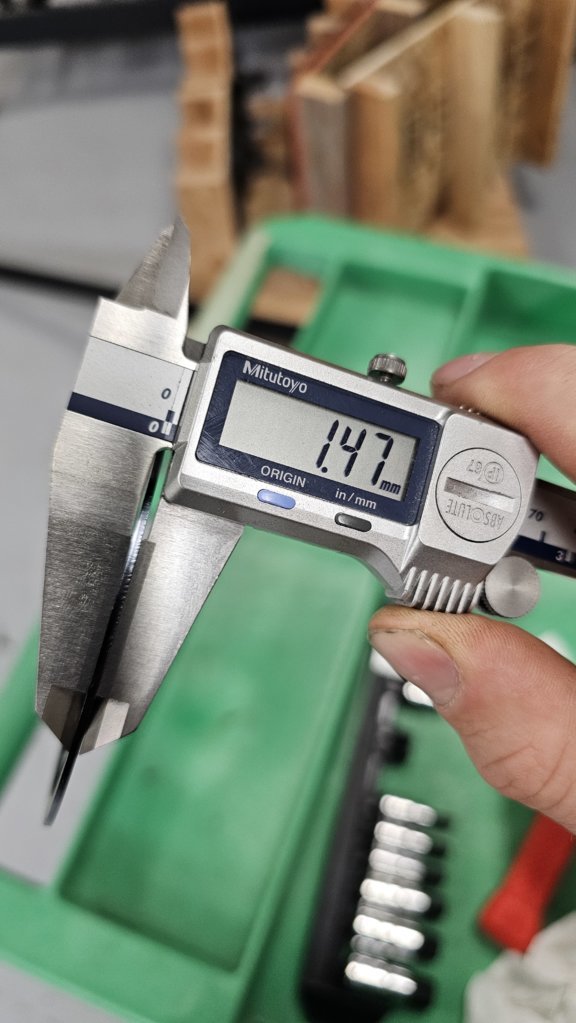

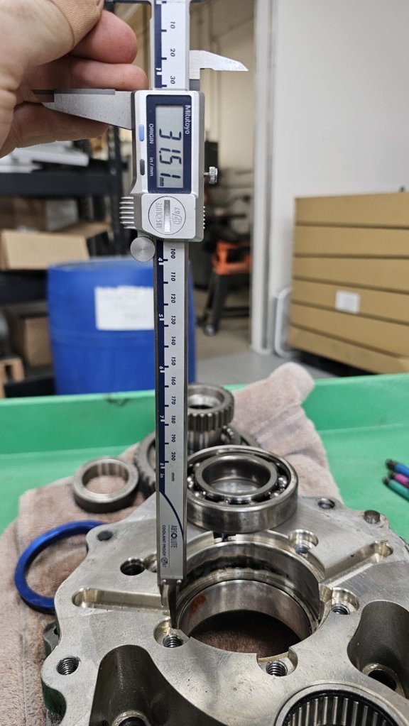

    So my measurements confirm it'll fit height wise. But the question is how the retention mechanism will work. The TG adapter uses two shims on either side of the bearing and then a blue stepped ring that gets clamped down via the allen head bolts.
    In the marlin pics, looks like the external bearing snap ring sits on the face of the adapter and gets held down with those same style bolts. But since I don't have any dimension on where the snap ring groove is on the bearing, I'm not sure where it will sit and if it'll land perfectly on that shelf where the blue ring fits into.
    Regardless seems like I'll have to machine down the height of the solid spacer that goes between the rear coupler and bearing to account for the added bearing height.
    Note these measurements are with that bottom shim in the bearing pocket.
    Guess I'll just order the $120 bearing and find out myself...

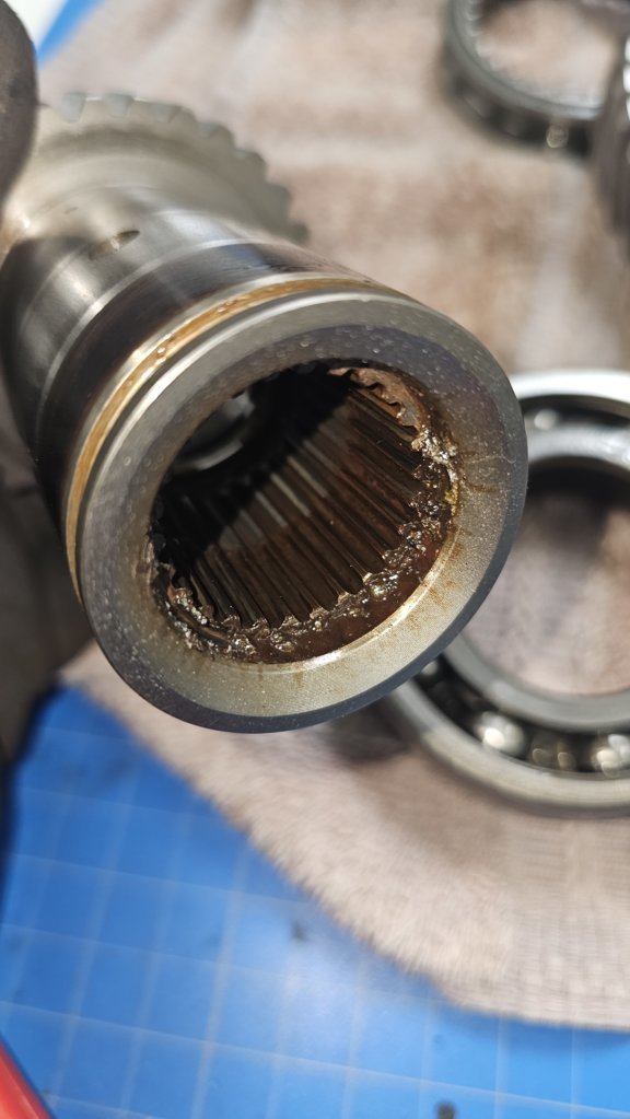

    Okay I was wrong. The coupler does have a spot for it, but the thrust washer doesn't have a receiving end so there aren't any provisions on this setup to accommodate that detent ball as far as I can tell.
    The splines on the rear case input look sort of rusty almost too. Not sure if that's because they were starting to fret, or from maybe using coper anti seize when I initially put it together. Can't remember.

    Interesting, that a thick spacer being used instead. Is this a complete TG crawlbox with 4.7s? Or a TG adapter with MC 4.7s? Original owner?
    That's definitely fretting on the coupler/ rear case input.

    Glad I caught the fretting now rather than getting stranded. I hope the splines aren't too far gone. Feeling them with a pick, I don't notice any pronounced steps in the length of the profile where the male and female splines engage with each other.
    If I can get the dual row bearing to work, hopefully that helps prevent any future fretting. I assume there's just too much deflection going on there....
