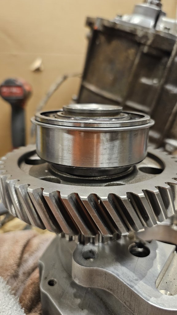

    I've never seen that, I mean the spacer is pretty thick way thicker than the washer with ball.
    I definitely think you'll gain some support using that dual row bearing. Worth it to machine down that spacer for it to sit in the adapter.
    How's that input coupler that saw some heat? Put a straight edge and make sure it's not warped.

    That's the plan as of now. I'll know more when I have the bearing in hand to test tomorrow.
    I'm wondering if it's worth it to machine a pocket into the spacer as well for that detent ball
    checked with a precision straight edge and nothing looks to be warped or OOS.

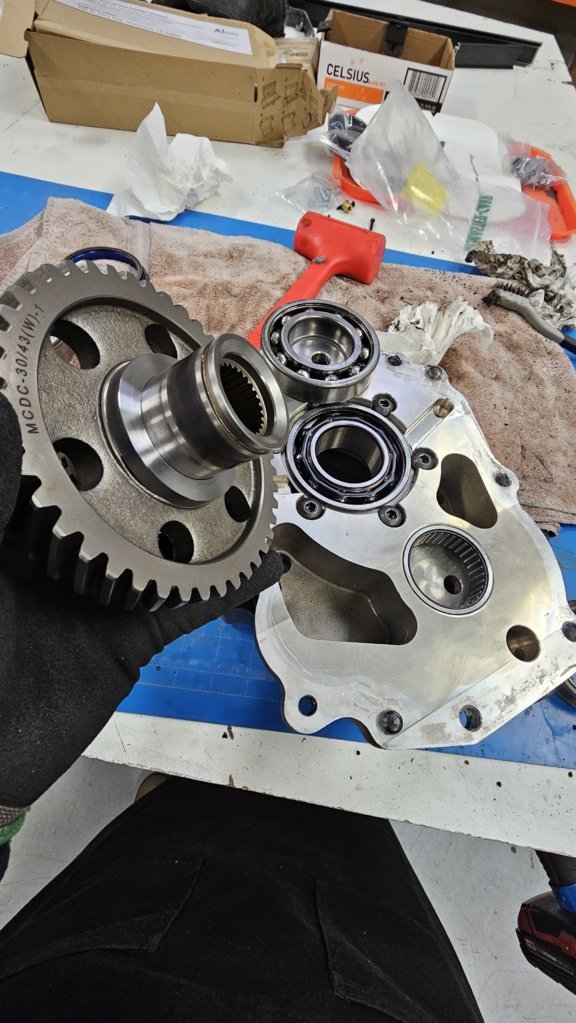

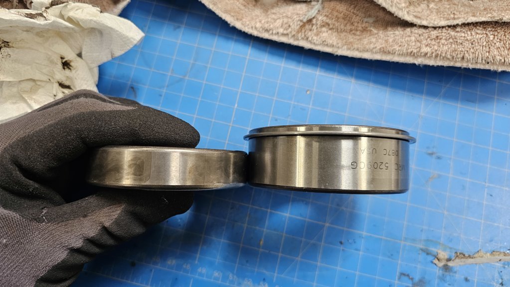

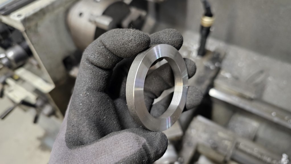

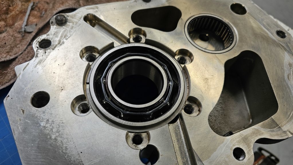

    5209 bearing confirmed drop in replacement for the TG adapter other than machining down the spacer/washer to a new 7.67mm thickness. 11.2mm height difference between both bearings, so took that off the 18.87mm original thickness. Dunno why TG doesn't ship them like this to start, seems like a no-brainer.
    Gotta do some cab sheet metal work, then time to find out if any other parts don't want to play nice.
    20241220_122639.jpg 20241220_122919.jpg 20241220_161328.jpg 20241220_190313.jpg 20241220_162452.jpg

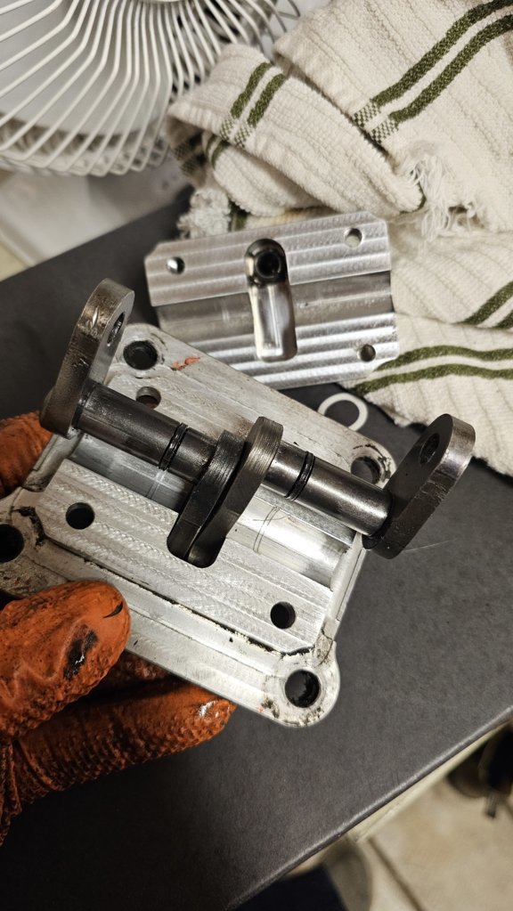

    Anyone got any tricks to keep the rad designs shifter from leaking out the sides? My rear case has always had a perpetual film of gear oil on it since install. Current thought is to pack it with grease and make an oil slinger plate.

    Less oil.
    I think this is just a generally accepted consequence of these cases. My marlin case puked out anything over about 1.5 quarts through the shifter. Seems like that's par for the course.

    I know that's the case for the crawlbox, but it doesn't share oil with the rear case. That shifter goes onto the rear chain case and is the only one that pukes. I thought it would stop, but somehow hasn't for the last couple years

    Ah...sorry wasn't reading carefully. Didn't realize you were talking about the rear case. I didn't have issues with the toyota case puking out the shifter, but I recall somewhere in this thread others have had that problem. I don't think I have a slinger, but dont really remember. I did use the same Right Stuff on the shifter that I used to seal up everything else.

    For sealing, I have the same RAD shifter, scuff up both sealing surfaces and I always use black fipg. Sometimes a factory paper gasket in the mix helps too.

    Hm that's what I had done as well. Black rtv on both sides of the metal gasket that goes between the shifter and case. Maybe I'll try loosing the gasket and see if that does anything.

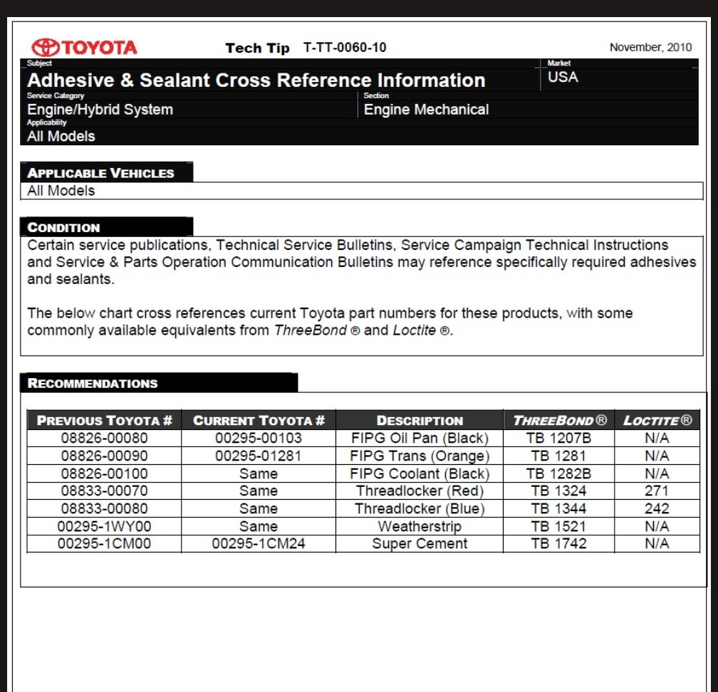

    This is a good part of setting up sealant. I use the black toyota fipg and you let it start to dry for a few minutes it will start to have a light grey tint and that's when I'll finishing tightening up. Expensive, but the amount a crawl box needs to be sealed, its worth it. The pink and orange fipg on the other hand havnt liked as much (used in the elements they were suppose to be).

    what are the pink and orange fpig supposed to be used for?

    It's less Tacoma and more mod
    orange is transmissions, or really anything that's metal on metal with ATF in it
    black is anything with gear or engine oil
    pink, im not sure, I never use that one

    Pink was the old Orange for trans/atf. I bought some when I rebuilt my transmission. Didn't seal well at all.

    I would be curious on what kind of testing they do to their sealants to determine which is correct for each application.

    They're all made by ThreeBond, just like Honda and Yamaha use. ThreeBond does all that work so the manufacturers don't have to
