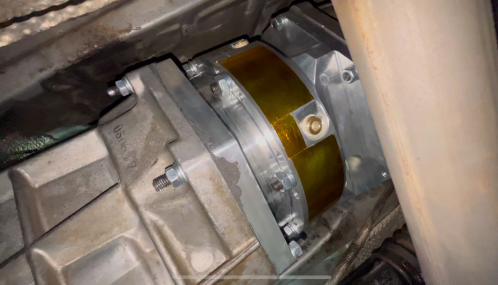

    that picture is not mine. it’s BigMike from Marlin Crawler with his third gen, he’s also triple case

    Yup I’ve seen his truck before. They had this one at their booth at previous hammers IMG_6076.jpg their set up hinders the ability to leave exhaust at the typical location

    Heat deflection tape, why? Why not?!:rofl:

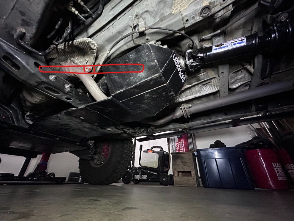

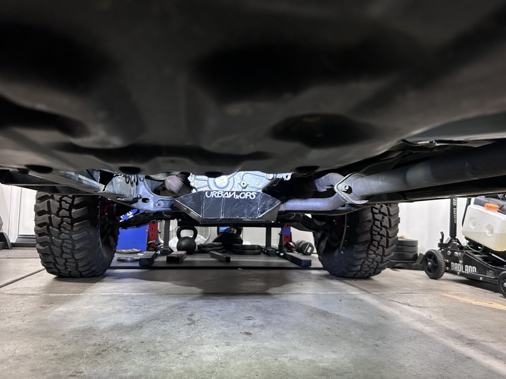

    Is the back of the skid supported at all?:confused:
    Ricardo13x[QUOTED] likes this.

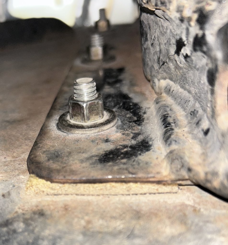

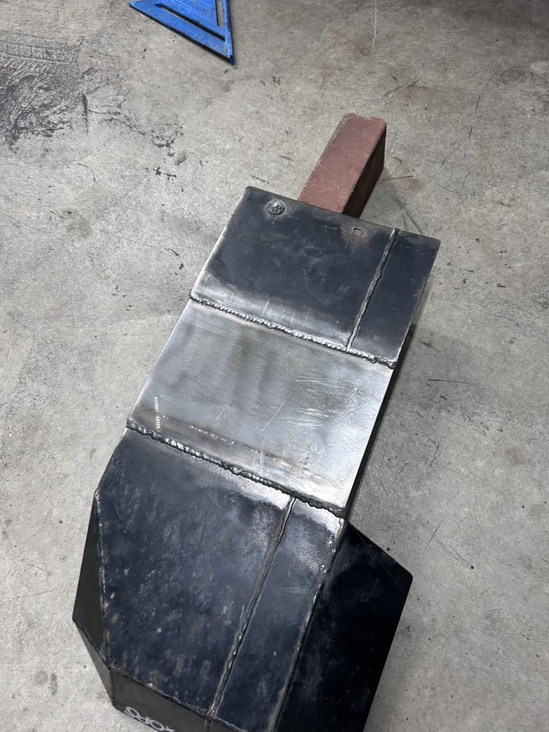

    Nope, she’s made out of 1/4” mild steel and my goal for the skid is to just skid over shit and not take solid hits on the transfer itself, in between the skid and the transfer there’s 3/4” industrial rubber(like the ones used on horse mats). It has work wonders so far. I don’t plan on changing the design so far.

    I’d be worried about break over, dual cases ended up being pretty close to high center point, I’d be worried about the deflection of that skid without a rear support

    Gotcha I’ll weld something over weekend i guess:fistbump:

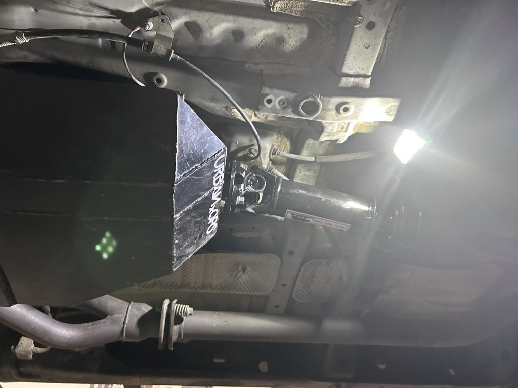

    If it were me, I would land a tube like this and add a 2 piece bung in the middle so the cross member is still removable. Would add a lot more support than just the welded plate.

    Solid! I got a bunch of 1.75” square 1/8” wall and a bunch of 2” 1/4 plate laying around.

    The “tcase skid” is a great concept but it can potentially become its own worst enemy. Factoring in how long it is, its total weight, and held in place by 2 carriage bolt only, I can see the skid collapsing and impacting the factory case from flex/deflection. You must also consider what the add on skid is bolted to as well, which is probably not the best placement IMO. If guys can bend 2.00x.250 DOM tube by hitting rock, the skid will have no issue bending or breaking completely by means of pulling the carriage bolt off where it’s mounted.
    But hey, what do I know. I don’t even have a skid. :rofl:

    Gotcha, good observation. The center portion of my cross member if fully fabbed up out of 3/16” and 1/4” mild steel. The whole goal of that crap is to have something in between the rocks and the transfer not to serve as a jack point. The transfer skid as mentioned before has been put to use and honestly it gave me a little peace of mind knowing I was not dragging on the transfer. Floor to frame height is 18 1/4” and floor to bottom portion of transfer skid is 15 1/4”. Trans skid to ground is 15 1/4” and ground to engine skid is 12 7/8” in case shit gets destroyed I’ll have some lights to work with :rofl:IMG_0349.jpg IMG_0350.jpg IMG_0351.jpg
    It’s like a different approach to this type of skid https://www.asfir.com/transfer-case...A9WJcQk-kwSHECcS2tR9FBUC9K8LWdeEaAvR2EALw_wcB but on this one I consider it to have a lot a force transfer and I feel the hardware will damage the case housing itself.

    Me, personally, I would bend 2 - 1.5x.120 HREW round tube (can use square tubing) @ 45 degree at each ends and weld tabs to the inner frame to mount the round tube end with poly bushing/sleeve (leaf spring style mount) or square tube. By having tabs, it’s removable. Then get a square sheet of 1/4” metal (2’x2’ or 2’x3’) and weld the sheet to the fab crossmember. You can add 2 or 3 piece of 1” angle metal and weld that to the top portion of the sheet metal for added rigidity.
    I prefer that method if I was to slide over rock vs attaching the skid to an existing skid.

    Gotcha, the transfer skid it’s not only attached to the transmission skid. the cross member has a 1/4” plate the protrudes about 2” fwd that’s where the transmission/transfer skid attaches to.
