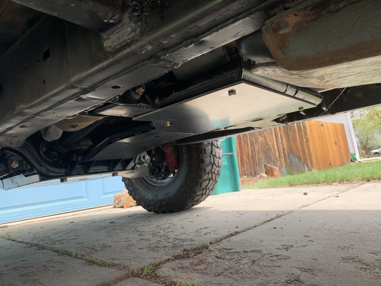

    Heres my skid situation, rarely hit it now that it is tucked up, but welded to the new tranny crossmember with a few braces and removable skids.

    this pic makes it look like if you going to drag anything, its the catalytic converter :rofl:

    Yep, but see the second pic.

    yeah i did. thats why i only quoted the first one. weird how in the first one it looks lower tho. like the crossmember. its pretty much what i wanted to do with the tacoma. maybe one day soon.

    That's because it was chopped and tucked in the second one :p
