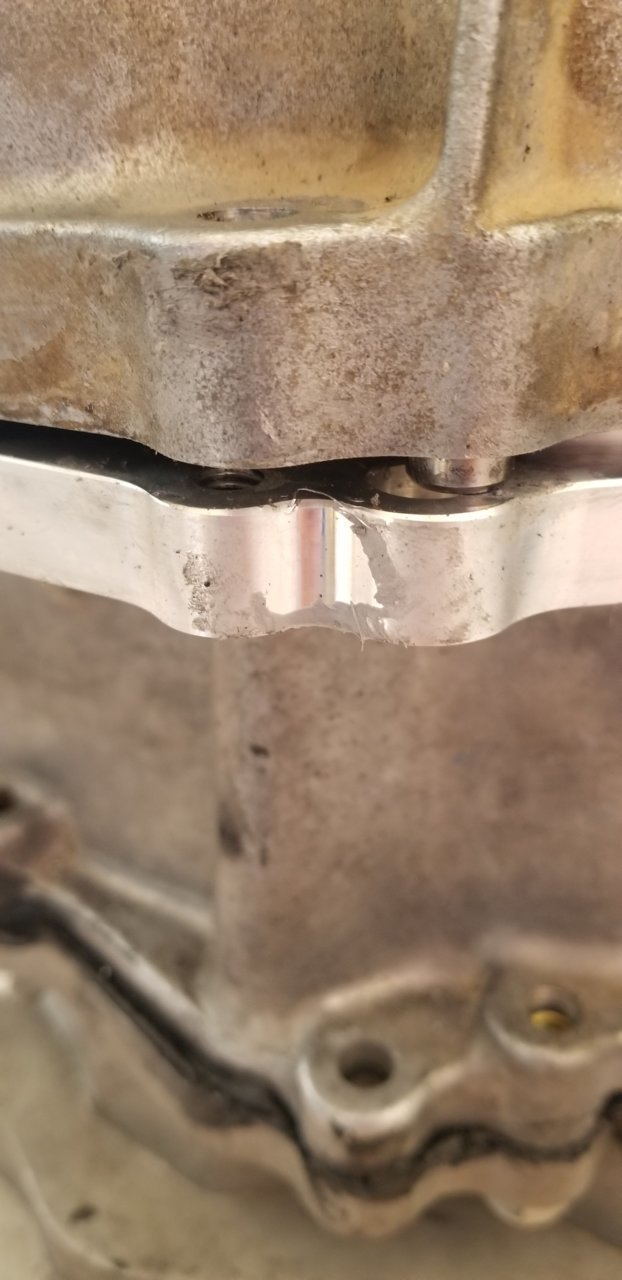

    Okay, no need for the typical 'well you bought trail gear' but has anyone else had fitment issues trying to mate the transmission to crawl box adapter to the back of the transmission tail housing?
    1 dowel will line up and the internal machined portion wants to line up but it leaves the 2nd dowel and some bolt hokes 3/16" off.
    Machining is a pass / fail grade. It either fits or it doesn't.
    I bought the tg because inchworm is no more and wont be supported and marlin will a) never have it in stock and b) wo t sell adapters seperate so you can use your own crawl box. 20180826_115812.jpg

    First time I’ve seen a fitment issue like that.

    That sucks! I would pull the pin and run it if it was me. That's really dumb marlin isnt selling adapters only anymore. Seriously F them, I'm buying an atlas for my next Toyota build....
    Unless my marlin/inchworm stuff is still together then I'll use that.

    That’s strange, mine all lined up perfectly. I’d call TG and send some pictures
