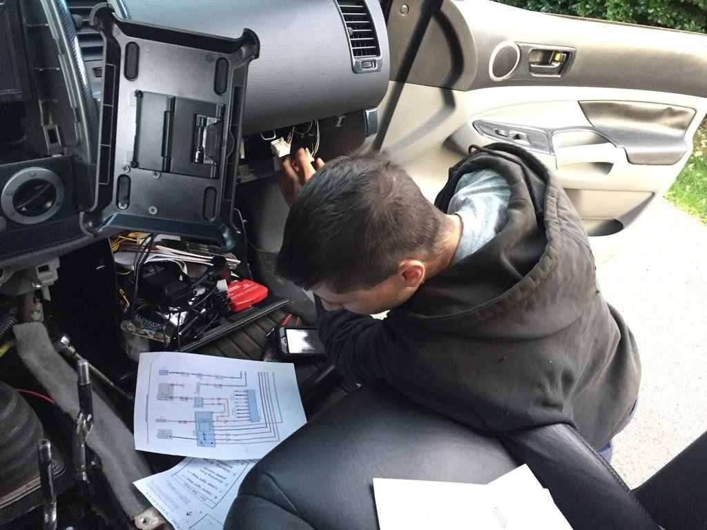

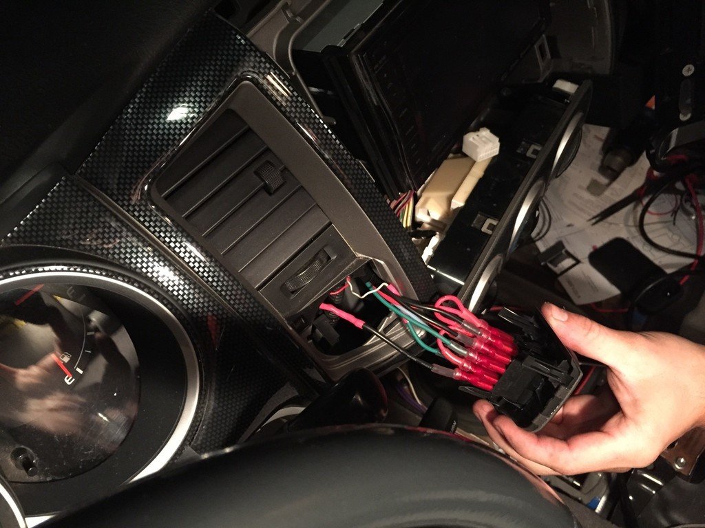

    Couple of shots of the wiring in action. FWIW, I did Craigs in my driveway in the dark without a schematic since his truck's wiring colors didn't match mine, studied briefly in the light :D
    31FFB1EA-31CE-4513-A4B1-19017C2DD3B3_zps_9a1a6673801ec03b1c3cb8c77842ebc42d175ae9.jpg
    6B5CADF5-1E3F-4150-A980-B581E8365C02_zps_44eff394c09a7de8a937e75896d0efae81100ecb.jpg
    My switch that I developed the schematic for and still works flawlessly from day 1

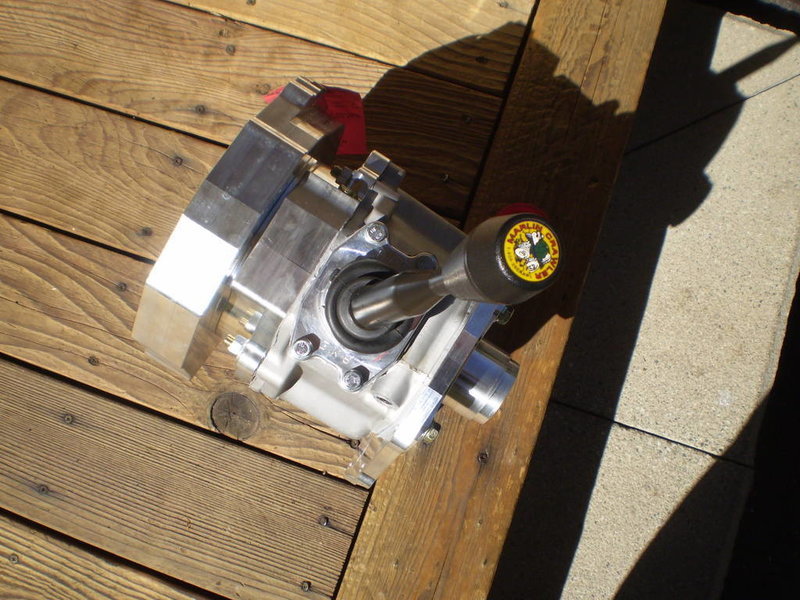

    dude don't scare people like that. I spent $3,200 on mine from Jess at high angle drive line came with everything i needed to put it in and the only extra cost was the 4x4 switch, speedo and drive lines. doesn't matter what route you go you'll be spending money on drive lines.
    If you're worried about breaking do the atlas they are tough.
    i ran the 1.0:1/ 2.78:1/ 3.0:1 i did this because total low is still stupid slow and i like having that .2 gearing split for when just rolling off road again a lot has to do with what axle gearing and tire size you are running Im running a 5.38 (perfect for a 39.5" tire) gear and 42" tires so that 2.78:1 damn near puts me to factory 4low and if im doing a long up hill trail and i want to make it a little easier on the trans and engine i can shift to 3.0:1 with out loosing 10 MPH of speed. Like i said if i hit an obstacle 8:1 is still stupid slow.

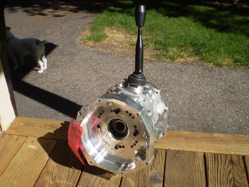

    2WD trans adapter?
  17. Mar 17, 2016 at 7:05 PM
    #57
    malburg114
    malburg114 Well-Known Member
    Dec 26, 2012
    #93766
    3,817
    Las Vegas, NV
    2001 Toyota Tacoma TRD
    Yeah inchworm prerunner adapter with lowranges 4.7 transfer case and 2.28 crawl box.

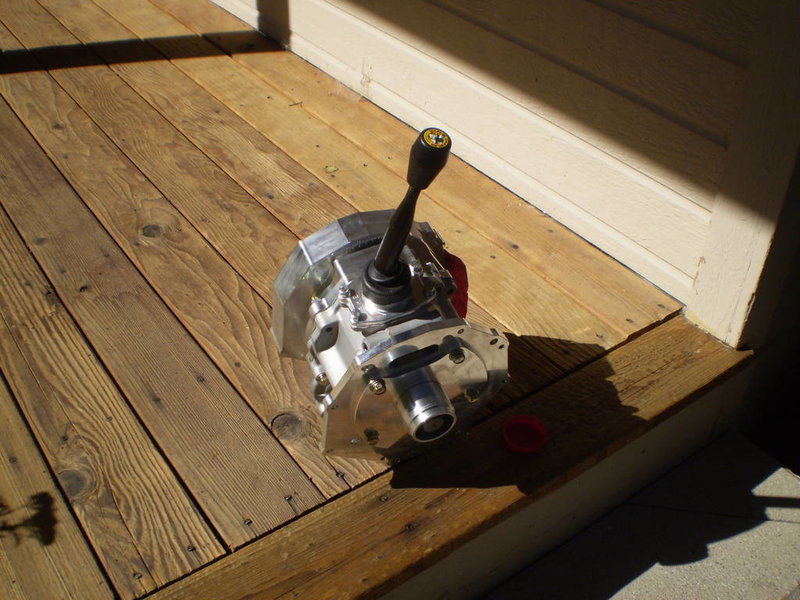

    On that note, the single shifter goes in the crawl box and the dual shifters go in the transfer case. Correct? Single in front, Dual in the rear?
  19. Mar 17, 2016 at 7:21 PM
    #59
    rctoy
    rctoy It's about to get real!!!
    Feb 13, 2012
    #72789
    6,981
    konstantenos
    Pocatello Idaho
    First gen 4door monster in progress
    TRD super charger, URD fuel mods and 2.1 super grip pully, Headers, 2.5" glass pack, Dana 60 front 4 linked, 14bolt rears on chev 63's, 5.38 gears, ARB locker in the front, PSC full hydraulic steering, 18" SAW 2.5" triple rate coils overs, FOA 2.5 air bumps, B&M launch controls, B&M trans cooler, 4 alpine 6X8 type R's amped, Red led rock lights, CBI front and rear bumpers (my design) CBI sliders, 4 riggid dualys front 2 in the rear, custom track bar, ARB snorkle, warn VR8000 winch, Viair 480c twin compressers..
    Yes. I mean why would the front box ever need two sticks? ;)
  20. Mar 17, 2016 at 7:22 PM
    #60
    malburg114
    Dec 26, 2012
    #93766
    3,817
    Las Vegas, NV
    Thought so, just wanted to make sure.. The dang prerunner adapter pushes the shifters so far back. May lose my center console possibly
