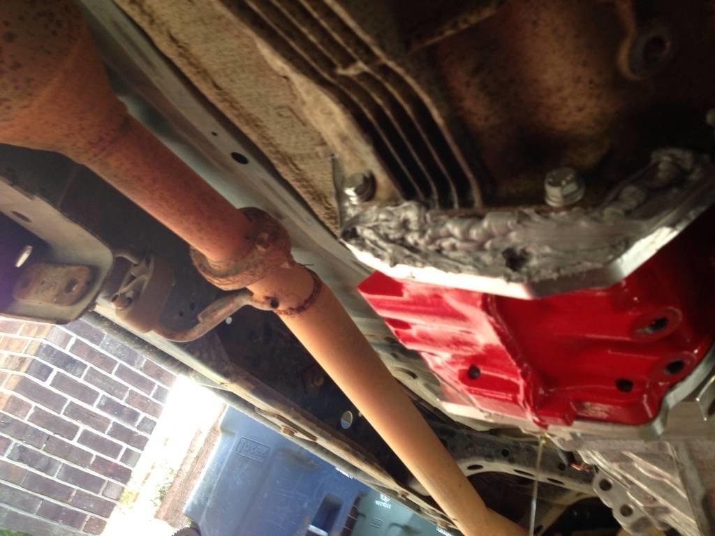

    Herculiner Hootus
    I miss judged the sealing area where the adapter plate seated when dry fitting so I missed a spot of RTV, after about a week or so of driving around fluid was seeping out between the crawlbox adapter and rear housing of the transmission. Rather than take it all apart again I goobered up a bunch of RTV and that's held for the last 7 years :rofl:

    :eek: it stop the leak right :thumbsup:

    yes, when I get to putting a new clutch and throwout bearing sleeve kit on this truck I'll fix it right but I've been lacking on my part to drop the drivetrain for a couple of drips a year lol

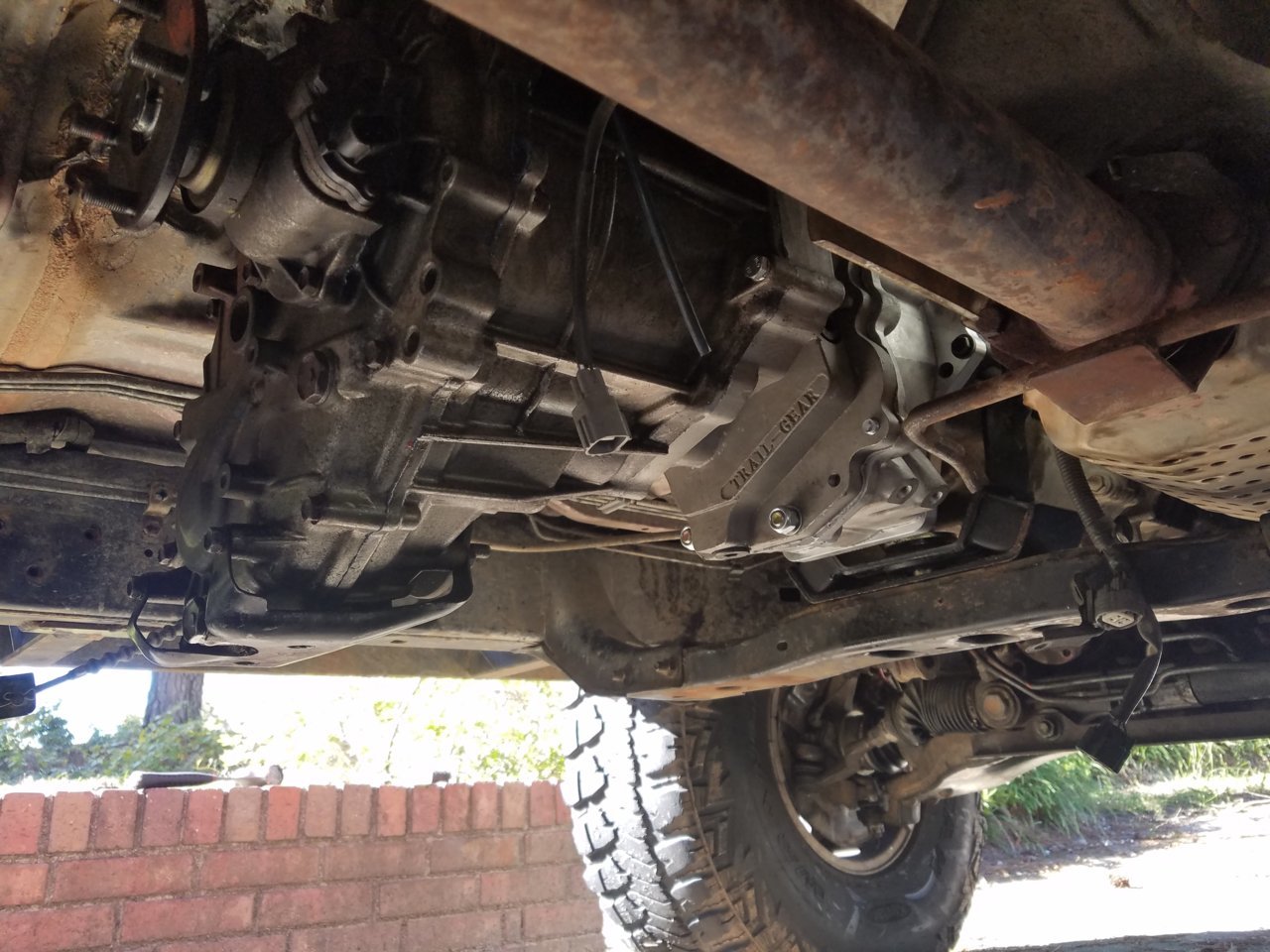

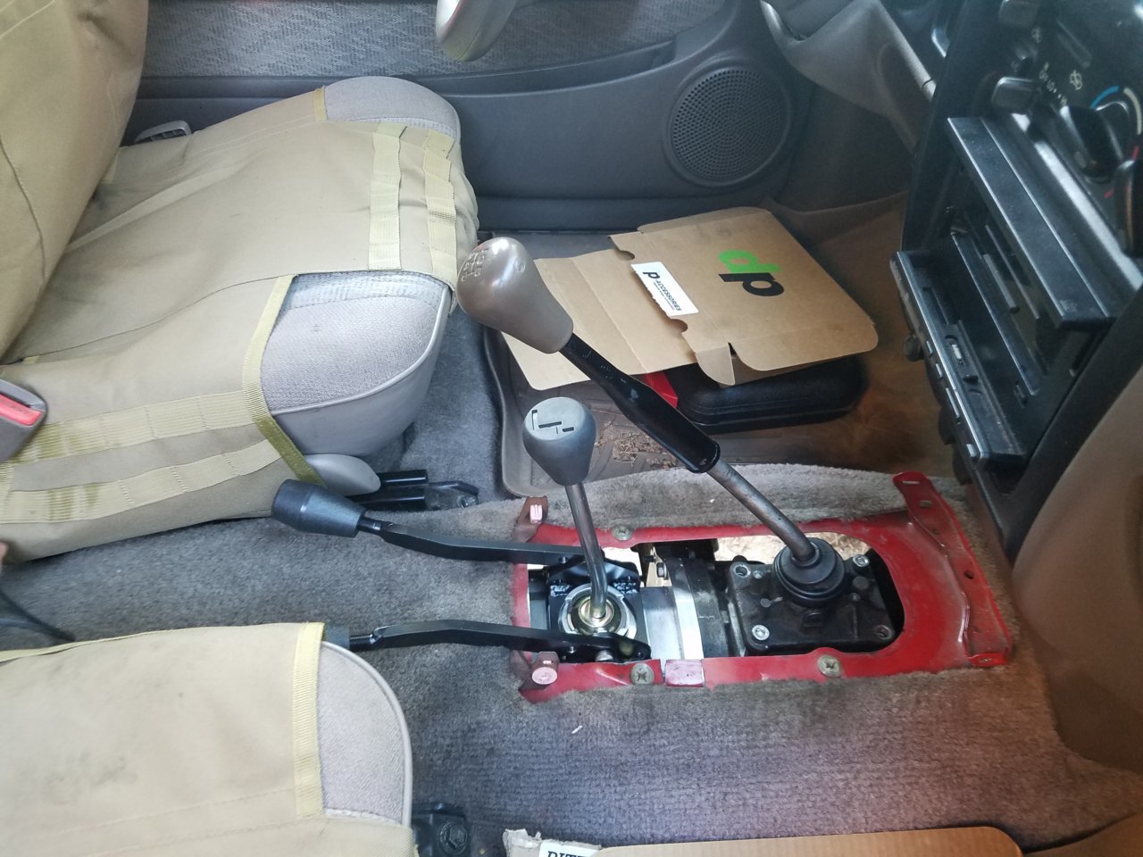

    Still have some work to do with the shifters, crossmember and wires but I joined the club this weekend! I've been wanting to do this mod for 7 years and I have to say that it sure was absolutely worth the wait
    https://youtu.be/0Ql8neBd6eo
    I know the 1st gen is supposed to be easy but I'm terrible at wiring so hopefully i wont butcher it. haa
    Question? What's the point of the red loctite on the seal extension? Are they prone to falling out?
    Thanks

    Looks good, wires are a breeze, only 3 to extend.
    That housing seal extension should be tapped into the adapter pretty snug, mine was. With the vibrations my thought would be the red loctite makes sure it does not wobble out for any reason. Don't think a rtv or the like would be up to the job for that part.
    Spy a few other good parts! RAD shifters and some GEAR seat covers. Got both of those in mine as well.

    Good eye. I had RAD's twin stick in there for 5 years which was my favorite mod outside of my 35's so there was no way I was passing on their tripples.
    My first set of GEAR seat covers deterriated so I threw in another pair a couple of months ago.
    I didn't put anything on my seal extender but you have me thinking that I will the next time I drop it. Which at this rate will probably be tomorrow. I lost count after the 10th time.

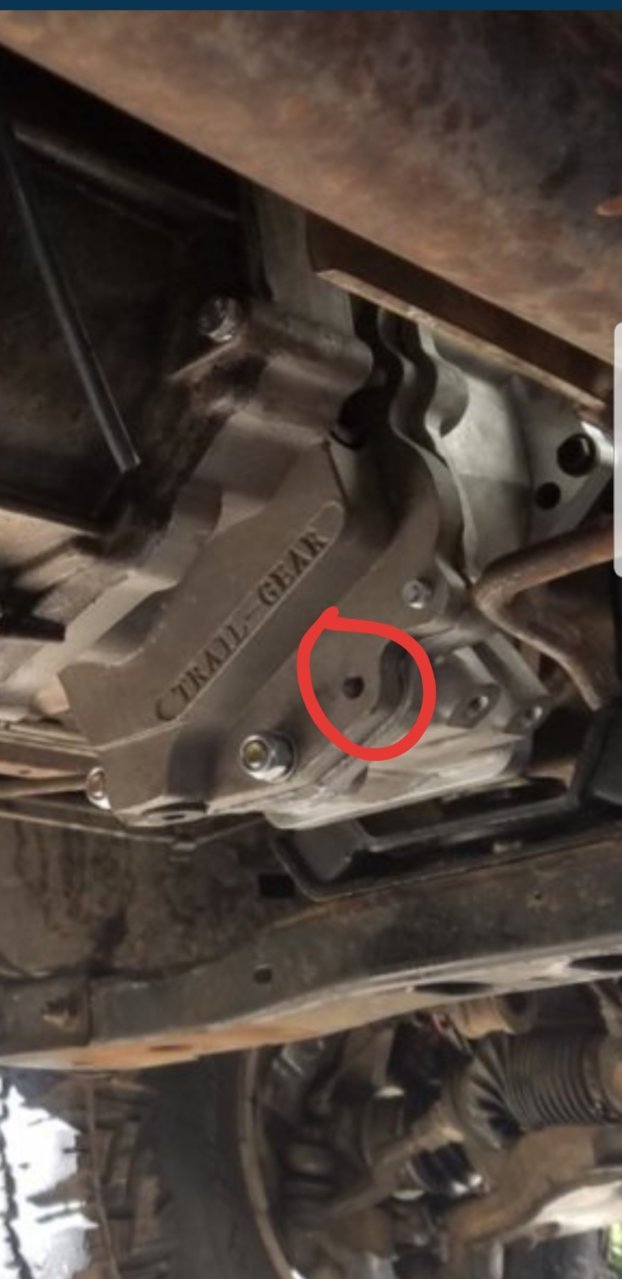

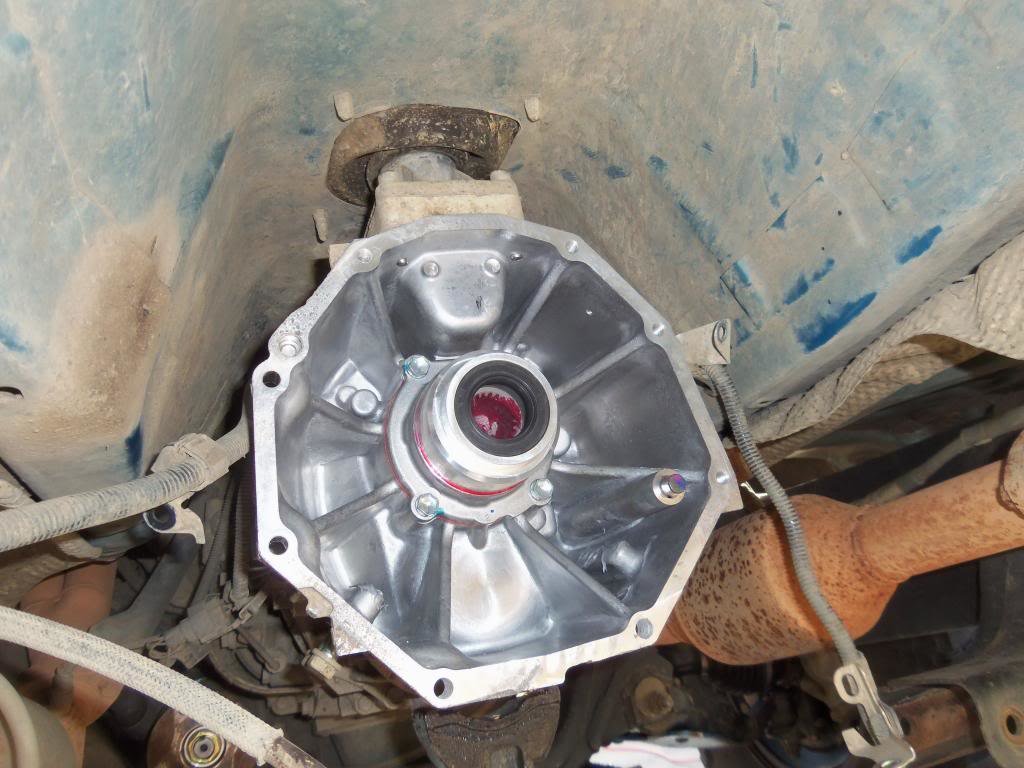

    Missing a screw?
  19. Nov 4, 2018 at 4:09 PM
    #599
    theesotericone
    theesotericone Well-Known Member
    Jul 27, 2018
    #260800
    12,379
    Bishop CA
    They're bolts. That hole is for an alignment pin. There's one in that location and one on the top on the other side of the case. They get plenty of RTV on install but it sure doesn't hurt to RTV the hole also.
    Jonyd182 likes this.

    Thanks for the tip....
