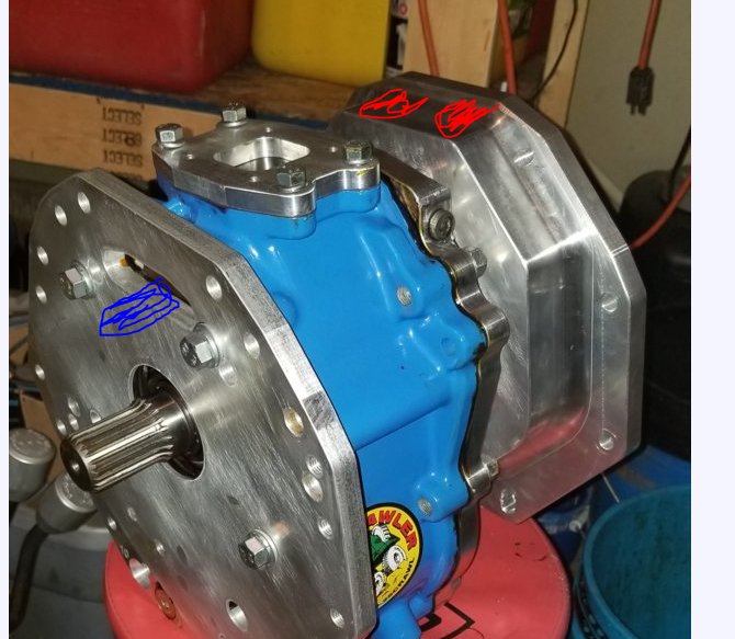

    Would not be binding, OP says he can smoothly shift H-N-L. I'd be curious to see if the crawlbox shift rail was too long and is bottoming out against the transmission housing. Its obviously engaging enough to go into low, but the snap back to neutral really appears that the shift detent ball isn't fully seated into the notch.
    The two transfercase shift rails do not interfere with each other. Seperated by an adapter.
    Red would by the factory chain tcase shift rails, and blue would be the single crawlbox shift rail.

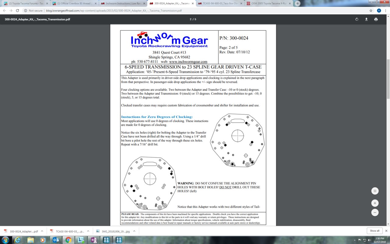

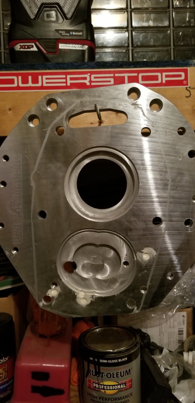

    I was about to screw this up majorly, as I plugged all the holes. Glad its still on my bench so I can fix it. I downloaded the instructions but they aren't real clear. You didn't clock yours. So did you plug the holes mark 0 or leave them open?
    Here's the page from the instructions
    That read locktite is gonna be a bitch to get loose again.

    All the 0* are open.
    This pic might help for a better visual.
