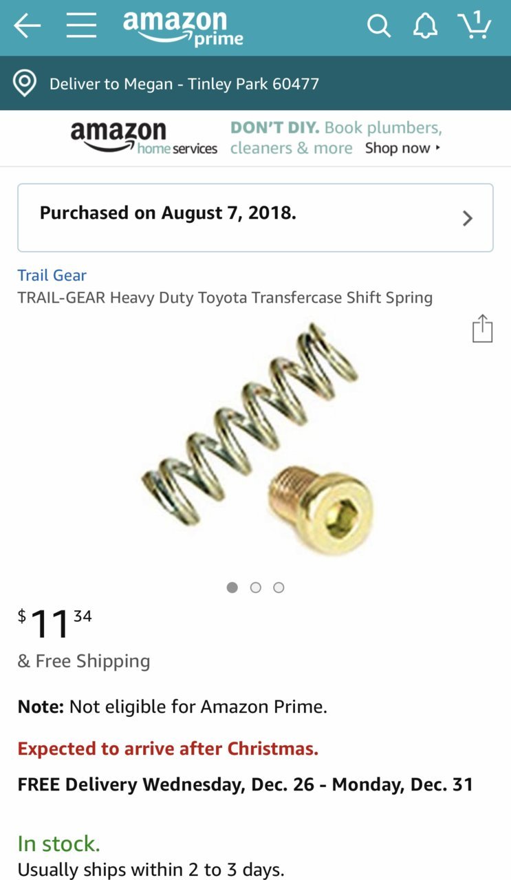

    Wheres everyone ordering this spring from?

    Amazon here
