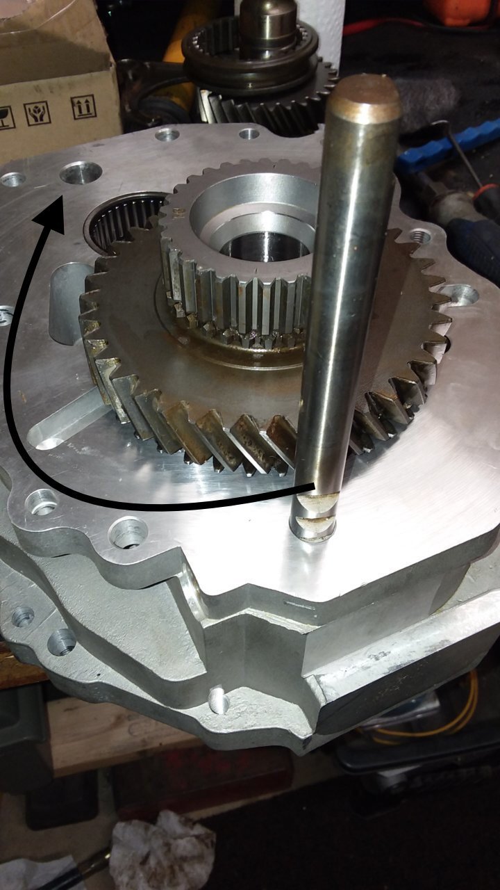

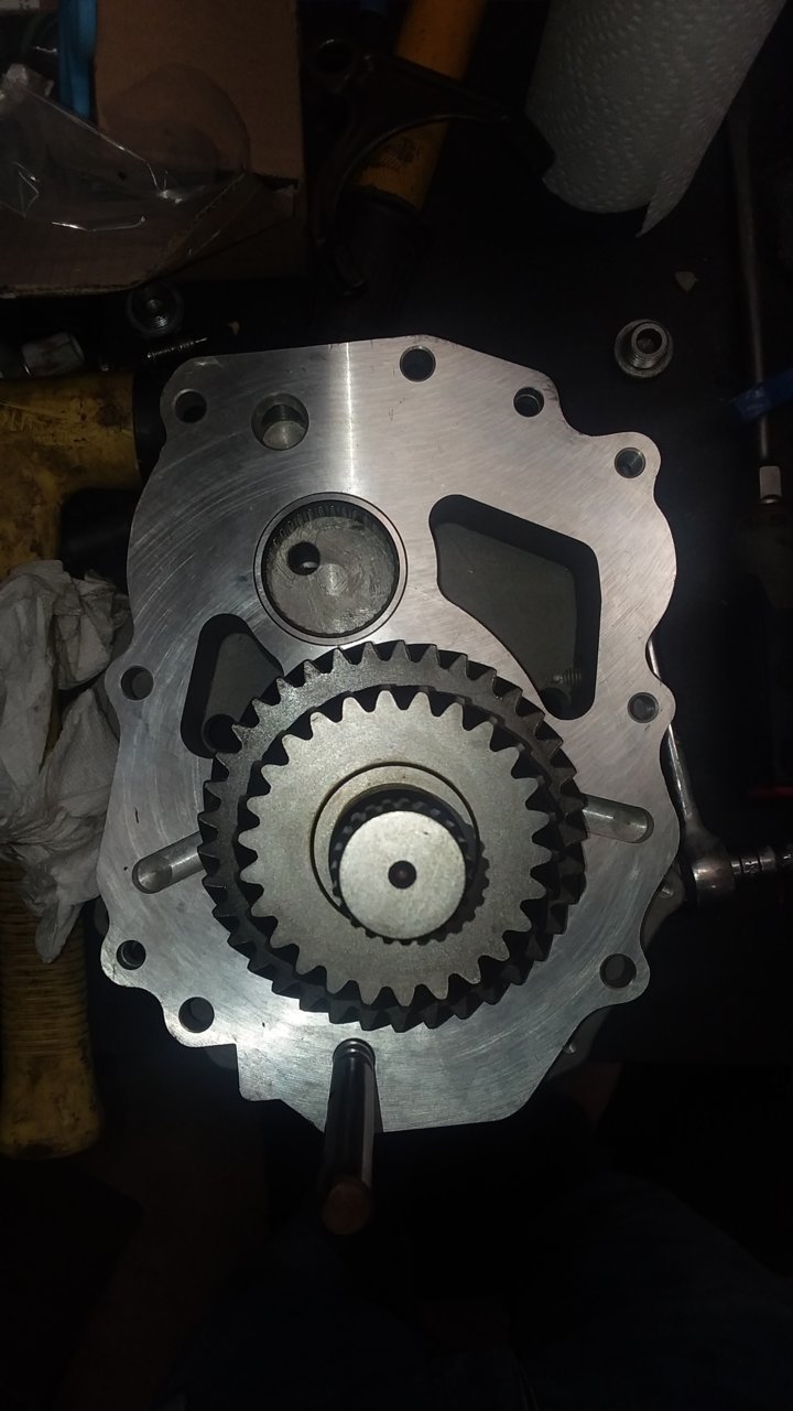

    A few tweaks
    Checking in with the experts to make sure I'm not doing something dumb.
    Got my TG adapter today and was working on it tonight.
    The shift rail does not fit. I tried both ends, and tried the other shift rail. They all go in this same amount.
    I tapped it lightly with a mallet, but it wasn't a simple burr.
    Anyone else experience this?

    Mine went together fine with an 85 top shifting case rails

    Hard to tell the orientation from that pic, you sure you have it in the right hole (no pun intended). Maybe that one is for a dowel pin?

    Looks like you’re in the wrong hole.

    I think thats the drain plug hole over there.

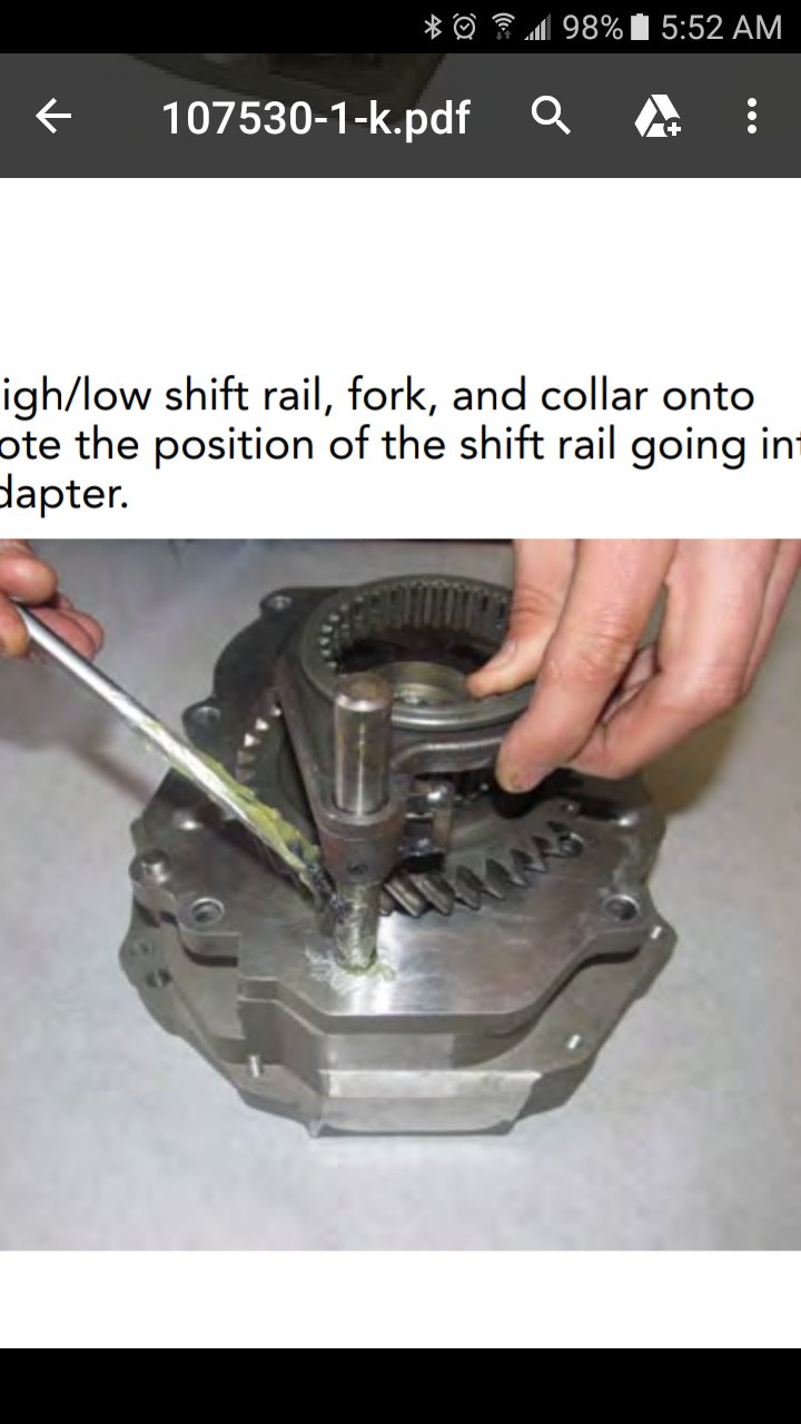

    From the TG instructions -

    Thats the correct hole. Can confirm by that allen bolt that lines up with the shift rail as this is where the detent ball and spring go. Try turning the shift rail so that the notches face that allen bolt.
    If it still doesn't fit, either slightly open it or warranty exchange it.

    I don't think it is as simple as turning it. It is TIGHT.
    I emailed the place I purchased it, their comment is that they usually use oil and clean the shaft with steel wool.
    I am not happy with that response, but I'll try it. I think it is WAY tighter than that.
    Planning to take some pin gauges home tonight to measure it to see just how much small it is.
    Seems to be a 14mm shaft, worst case, McMaster has 14mm reamers for $40.
    EDIT: Found a cheapy on Amazon for $10. Will have Friday.
