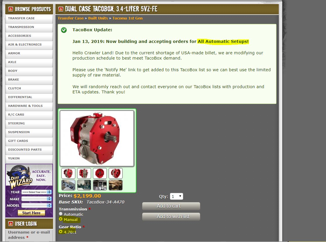

    Just seem to be selling complete units and the adapters from transmission to gear driven tcase.
    But looks like a no go for Manual's at the moment.
    https://www.marlincrawler.com/trans...oma-1st-gen/dual-case-tacobox-34-liter-5vz-fe
    I'd go with the assembled TG box with the 4.7s if your looking to stay Toyota vs. who knows how long of a wait for 5spds.
    Also with an assembled box, you'll get the snap rings, seals, etc. that you would have to hunt down and buy seperate when pieceing together your own.
    Main reason why I bought my Inchworm 2.28 box and then swapped over the Marlin Comp 4.7s.
