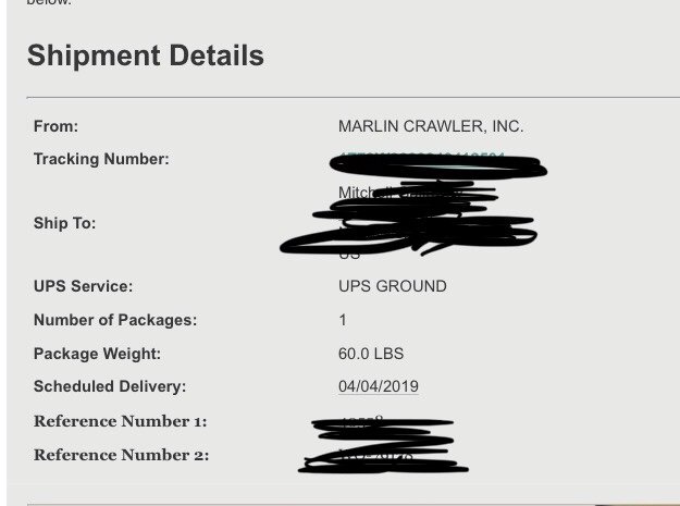

    Crawl box has shipped :anonymous:

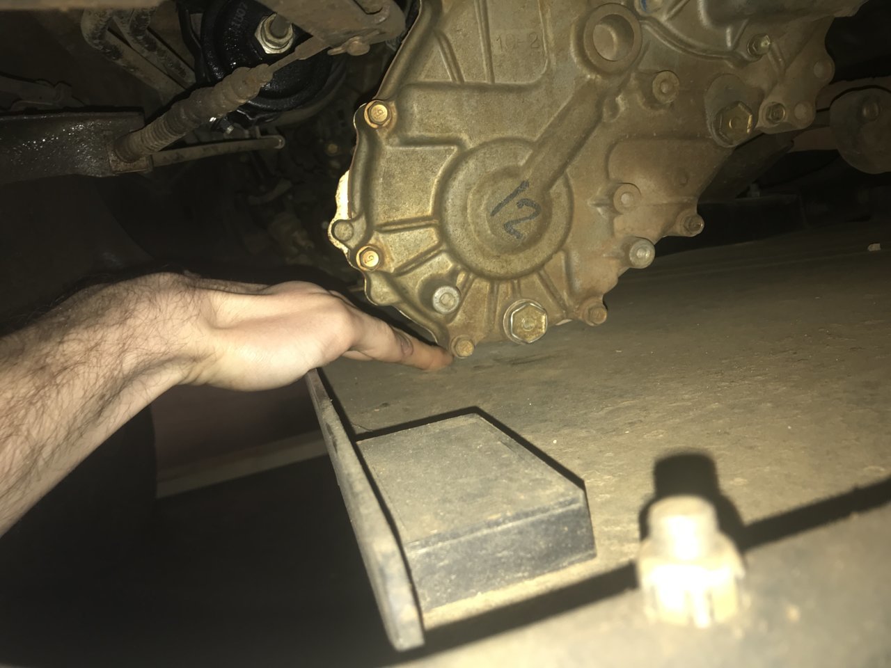

    So I have some noob questions before I get my crawl box in the mail.
    Just FYI I have a 1st gen 3.4L j shift with 5 speed manual tranny.

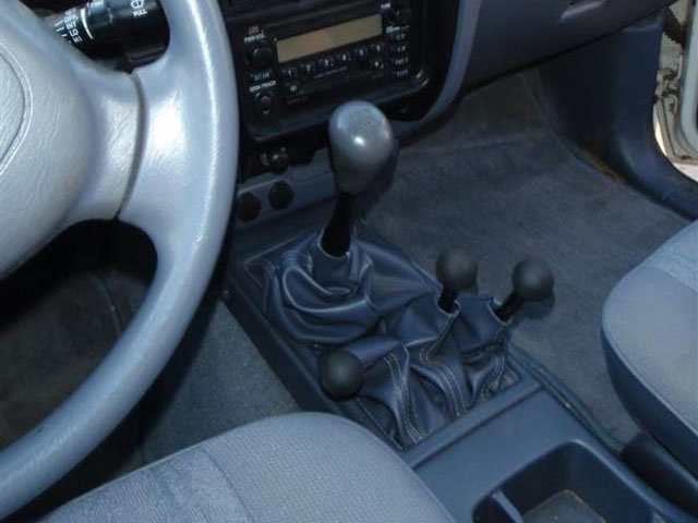

    Can you clock the tcase in various positions? I'm guessing this has the double effect of a) changing how much it hangs down and b) dictating where your shifter will end up?
    Wondering if there's any good pic threads of different shifter configs for the 5 speed. I'm assuming the crawl box shifter goes where the original j shift goes and then the j shift goes wherever you clock the t case? Ideally I would like to stuff all the shifters in the same area as the stock location but not sure if possible. I've seen a 1st gen triple stick config like this on marlins website. Tacoma all seems to all be pics of the shifter in the cup holder which is doable but wondering what other possible configs there are.
    Pics I'm talking about
    This pic is supposedly a 1st gen taco but it's triple sticks
    Ideally looking for a config where I can still use my bud built belly pan and also look clean on the interior. Maybe asking too much?

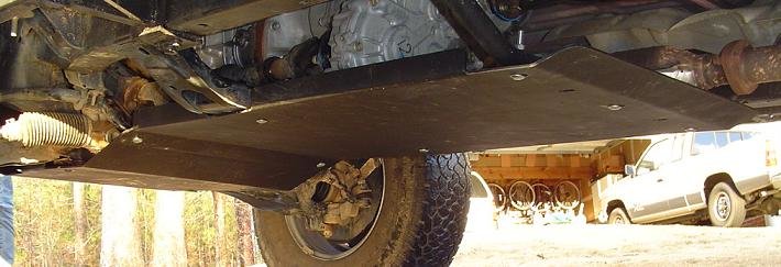

    Here's a pic of the BB bellypan (not mine). As you can see goes pretty far back and just barely clears t case in stock config with little to no room to spare (I just checked).
    I can't even get my finger under the tcase. Guess I may need to drop the belly pan a bit no matter what?

    in a short word about clocking the tcase: no
    Tacobox is not clockable
