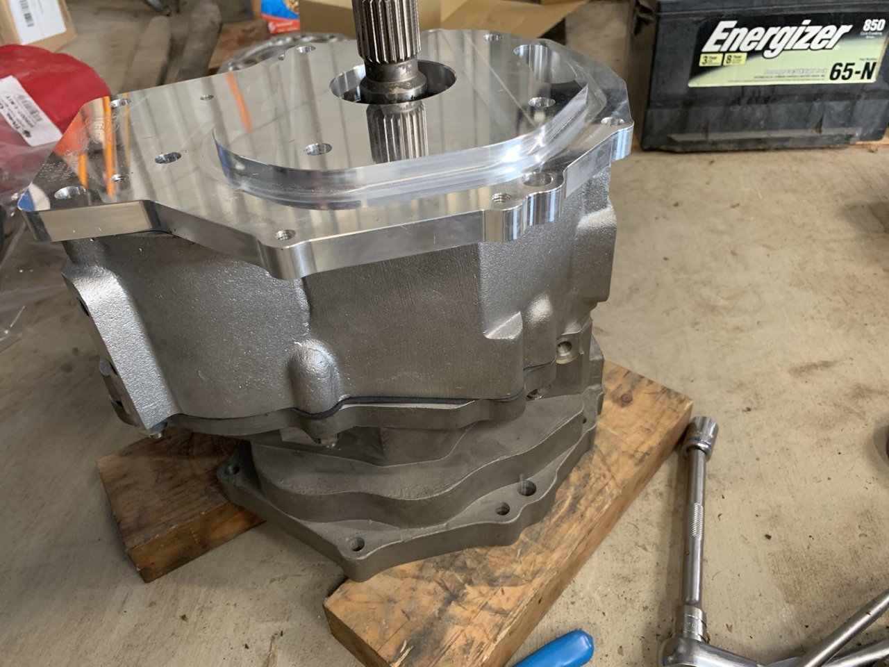

    Don't remember seeing too many other than the final install pics with the console installed etc.
    I modified the transmission tunnel just a bit by making a removalable access panel. But already had a 1.5" body lift to help clearance.
    I didn't like that shared breather idea so I just ran a union fitting and relocated the breather even higher to match my transmission breather.
    Edit* @ThunderOne
    You can see the outline of the rectangle shape I cut out of the floorpan. Put in some nutserts and made a removable cover that bolts in.
    Also you can see how I created a new bolt in plate where it attaches to the crawlbox and how I rewelded the left and right shifter pivots in order to locate the shifters through the cupholder.

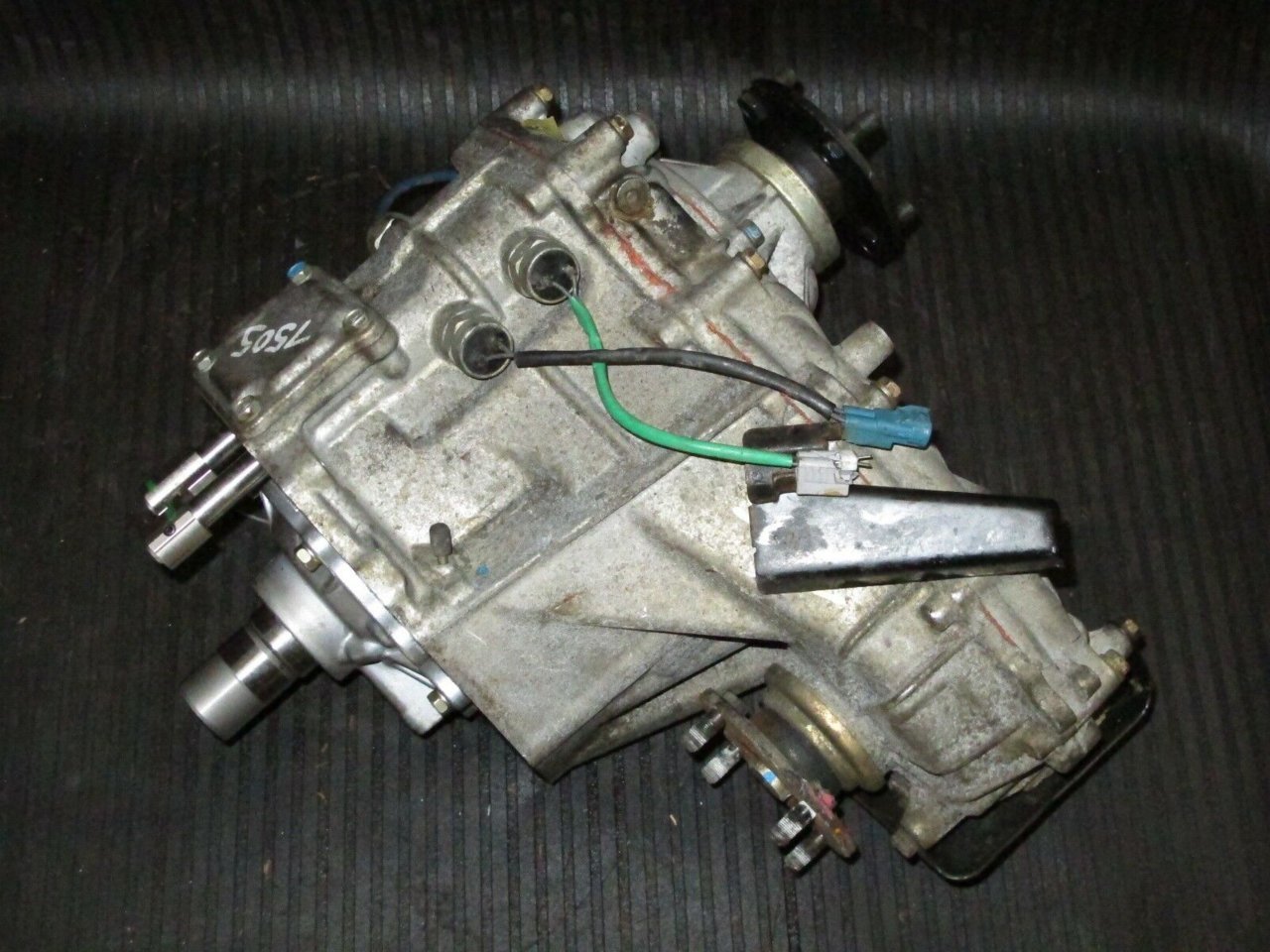

    @Snowy does foxrcing07 case look like yours? This tcase looks like its from a 5spd that has the jshifter where the autos have the port block off bolted in aka Forward shift vs top shift.
    @foxrcing07 you may need a different tcase from a 3.4 and either get a 26-23spline coupler or swap out the tcase input from your current tcase to one from a 3.4.

    Definitely a forward shift case. My 3RZ/W59 came with a top shifting case. I knew T100's came with forward shift cases but I had no idea that 3RZ/A340f's did too. @foxrcing07 will have to source a top shifting case, I'm not aware of any conversion to make a forward shift chain drive case into a top shifting. I'm sure it can be done, but its just easier to get a new case. If you have a 3RZ/A340f, you have a 23 spline tcase input, so you just need to source a top shifting one from a 3.4 auto or manual and you'll be good to go.
    The best I can tell for tcase compatibility over the years
    3RZ/A340F - 23 spline input, forward shift
    3RZ/W59 - 26 spline input, top shift
    5VZ/A340F - 23 spline input, top shift
    5VZ/R150F - 23 spline input, top shift

    @foxrcing07 you need to get a different tcase from a wrecker, make sure you grab a tcase from a 3.4 auto/manual and make sure its a j shift and not a push button shifter. Easy way to tell is by the actuator mounted on the back of the tcase housing between the rear output and the fill hole.

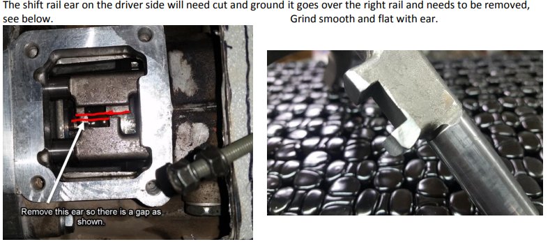

    I think I'm going to pull the twin stick from my brother truck and compare them side by side and see it I can see any other differences, if they appear the same I might try to move the shift forks back the the rear location and if that works I'll trim the rails down (nothing to lose with that case)
