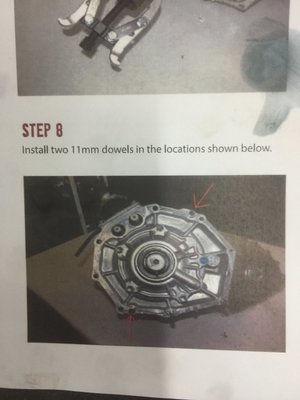

    Where did everyone get these dowel pins from? Did they come with your crawlbox hardware or did you source them elsewhere. My TG case didn’t include them, and none of the parts stores here had them either.

    02hilux
    02hilux What do you mean there’s no road, I’m here
    Sep 14, 2016
    #197244
    6,323
    Planet: EARTH
    Reuse the original

    rngr
    rngr Aix sponsa
    Jan 13, 2015
    #146258
    9,244
    01 SR5 4x4 2.7L
    The originals are still in the back of the transmission.
    If I’m thinking correctly, they will remain there and love between the crawlbox and the trans.
    The dowels the instructions are calling for go between the crawlbox and rear case.
    What am I missing here?

    foxrcing07
    foxrcing07 KO7FOX
    Aug 12, 2016
    #194389
    4,024
    Morgan
    Modesto, CA
    2019 Raptard 2001 TJ
    Dirt
    My trail gear kit had them
    4 dowel pins total
    rngr[QUOTED] likes this.

    rngr Aix sponsa
    Jan 13, 2015
    #146258
    9,244
    01 SR5 4x4 2.7L

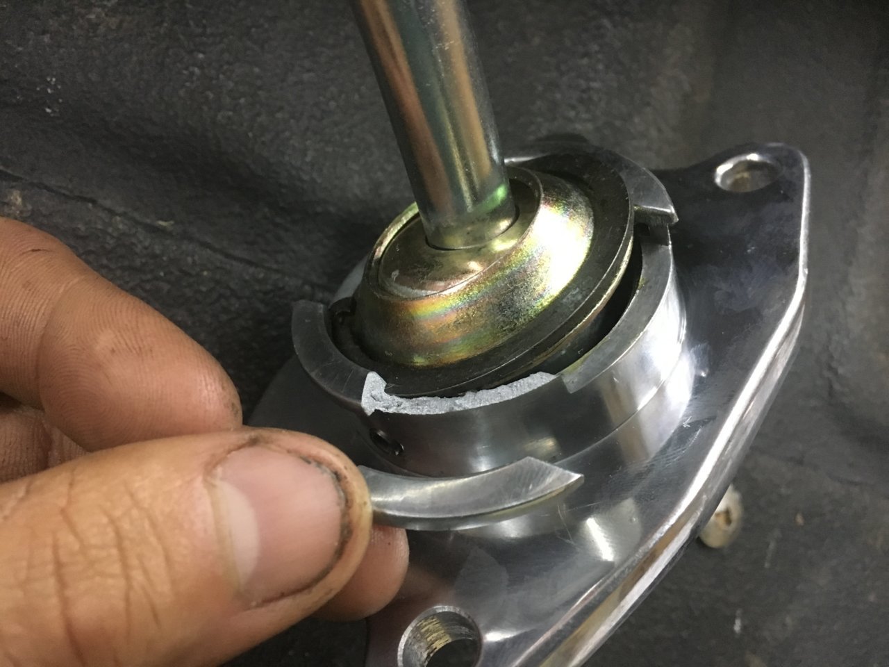

    Guess I’ll call them tomorrow... again. They just had to ship me a replacement shifter today because they sent a broke one with the case. Haha.

    02hilux
    Sep 14, 2016
    #197244
    6,323
    Planet: EARTH
    Spoke too fast, i tho you were referring to the tailhousing and adapter.
    Not sure about TG, but marlin mc09 came with them

    02hilux
    Sep 14, 2016
    #197244
    6,323
    Planet: EARTH
    How did that happen? Maybe it was meant to break since they forgot the dowel pin? That s#ck @ss tho.

    Just came like that out of the package. The replacement shipped today.

    Snowy Is neither here nor there
    Feb 5, 2014
    #122349
    3,466
    Connor
    Winnebago, IL
    3 linked 98 Xtra cab
    Stock-ish
    Probably was broken during shipping. CA to TN is a long ride and the rule of thumb for me is that any package will experience a drop from about waist high.
    Yep, exact same ball and spring detent.
    SGTCap[QUOTED] likes this.
