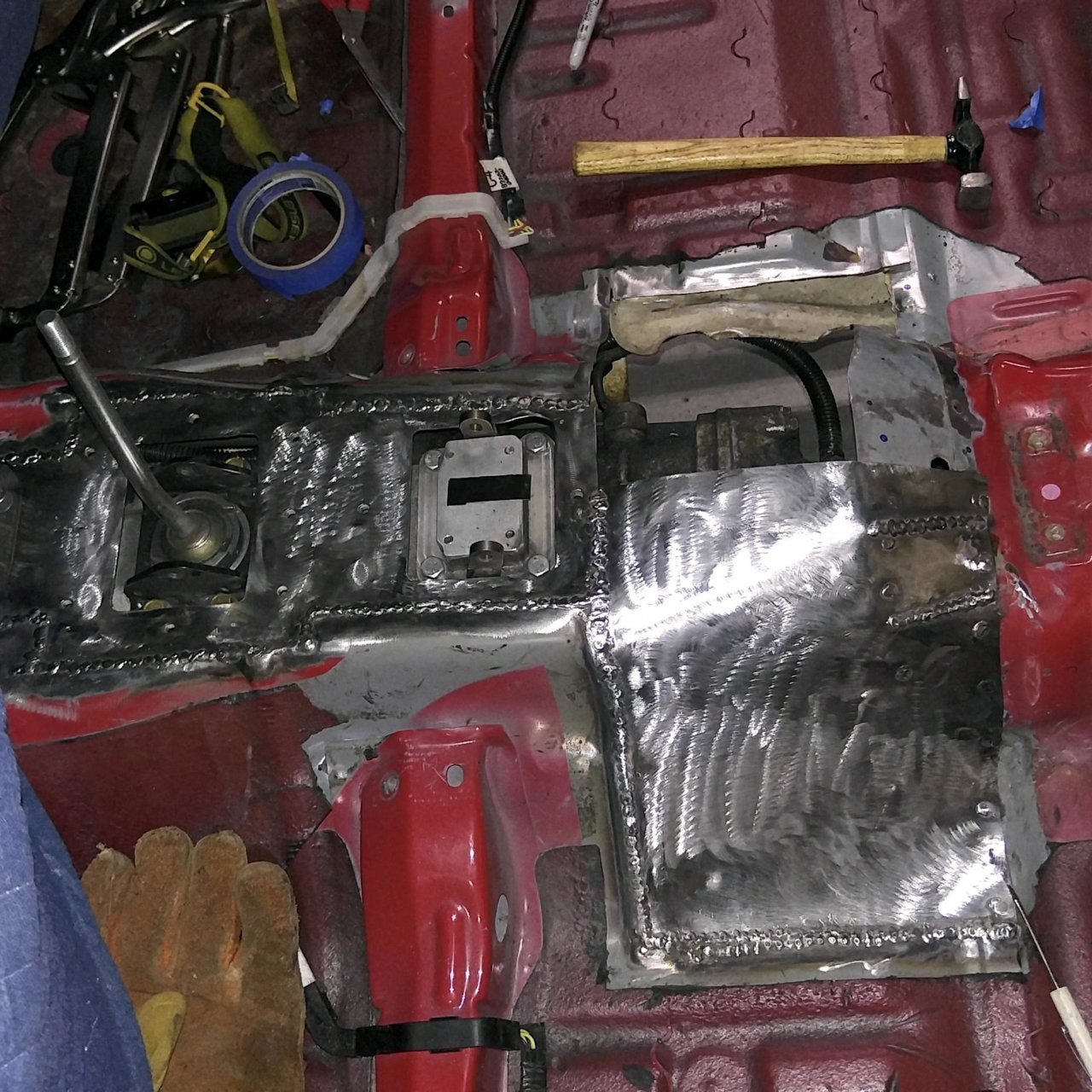

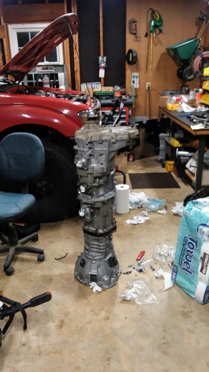

    A few tweaks
    So I'm finally ready to put this beast back in, but I have a small concern.
    The rear transfer case only has about 1/2" of spline engagement into the dual adapter. Is this normal?
    I don't think I could have done anything wrong!
    Seems a little scary to me - this is the most critical mating - or sees the most torque...

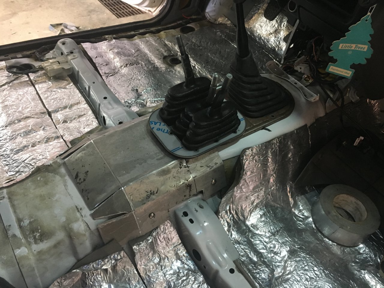

    finally getting around to putting the center console back together and building the new crossmember....
    Better and more pics to come!

    01 SR5 4x4 2.7L
    I don’t know about that, but either way, I would not want it if you don’t have to cut a huge hole in your floorboard.
    With the number of times I had to put everything shifter and linkage related together and take it apart to fix something, I would have had to pull the cases every time if there wasn’t a gaping hole to work through.
    Cutting the hole takes 5 min. Dropping the cases...
    My $0.02

    did you have any problems with fitting the console over the new floor?
  10. May 28, 2019 at 1:00 PM
    #870
    rngr
    rngr Aix sponsa
    Jan 13, 2015
    #146258
    9,244
    01 SR5 4x4 2.7L
    Doesn’t bolt up exactly the way it used to, but it’s in there and it’s solid. Wasn’t a big deal at all.

    how much clearance do you have between the shifter linkage and the fabbed floor?
    I have a feeling doing the floor stuff will be my least favorite part
  12. May 28, 2019 at 1:10 PM
    #872
    rngr
    rngr Aix sponsa
    Jan 13, 2015
    #146258
    9,244
    01 SR5 4x4 2.7L
    Maybe 1/2 - 3/4” above it and a couple inches on the sides. There is a ton of movement to the passenger side from torque.
    ToyRyd04 likes this.
