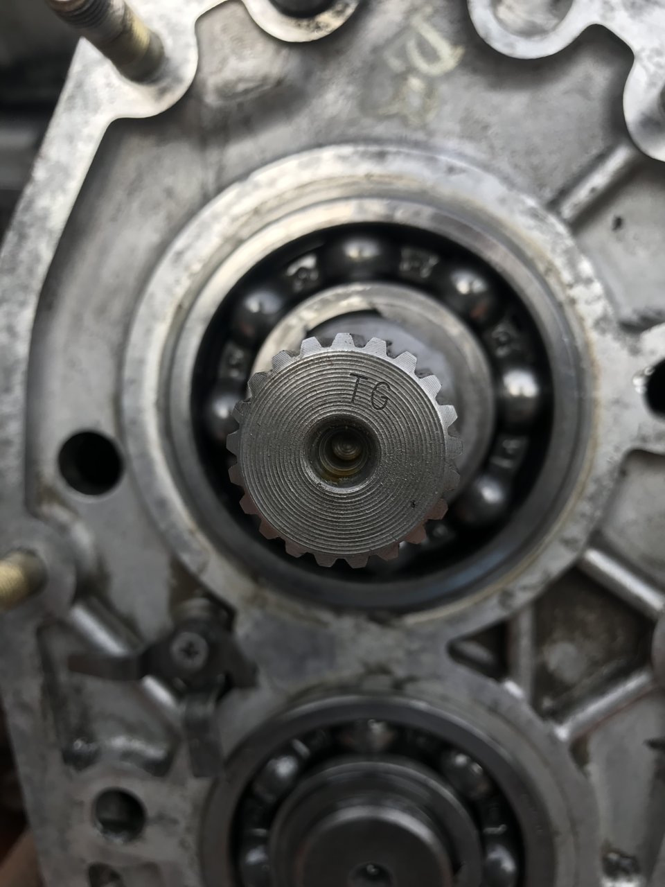

  3. Jun 5, 2019 at 4:09 AM
    #903
    ToyRyd04
    ToyRyd04 Taco Transformer
    Aug 5, 2011
    #61217
    1,884
    Greg
    Perryville, MD
    '04 PreRunner
    SAS'd PreRunner Diamond Axles Crawlbox
    Wow that's an oooooooooold 21 spline gear set.
    Do you plan on r&r the bearings and seals? I'd recommend doing so.

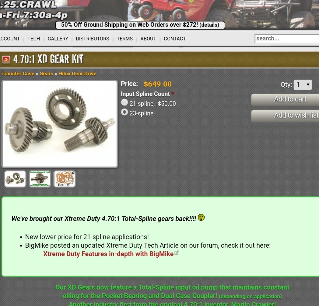

    So for the rear 21 spline 4.7....
    You have a few options. (Cost $-$$$)
    1. Just run what you have and then later decide if it breaks, how to replace. Which is probably the most reasonable. (Free $)
    2. TG now only makes a 23spline 4.7 gear set. Not a bad option, few guys here are running the TG crawlbox setup with these 4.7 (some Inchworm boxes came with these as well) and no issues.
    There have been a few reports to where some folks have snapped the input right where it "necks" down. It's considered to be a failure point by some. Factory 23 spline 2.28 has this same design. ($$)
    3. Marlin Crawler makes 2 different version of it's 4.7 gear design. This first option does not have the "neck" down design, instead they refer to it as a total spline design. Stating that this increases strength X amount. ($$)
    Currently in stock, but does not stay in stock long fyi.

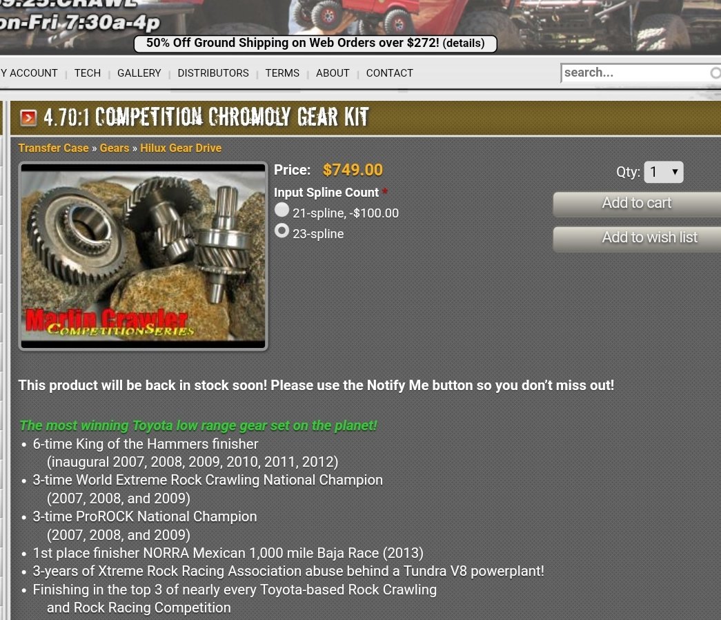

    4. Marlin Crawler's second option is the 23 spline 4.7 competition chromoly. Again, does not have the "neck" down design. IMO the strongest 23 spline 4.7 option out there, and what I currently run in my crawlbox. ($$$)
    Hope that helps, not cheap, but there are still a few options out there.

  4. Jun 5, 2019 at 10:27 AM
    #904
    BlackPearl
    BlackPearl Well-Known Member
    Apr 17, 2017
    #216527
    1,362
    Alex
    Toyota Tacoma TRD
    3” lift. Sway a ways 2.5 on 285 75 16 and much more
    Well looks like im down to 1 option. Ill keep it all as 21 spline until something brakes.
    Ill install new gaskets but all the bearings look good. Whats R&R? sorry kinda new to this gearing stuff..
    Also what brand would you recommend for the adapter plate? Looks like there are a ton of different option.

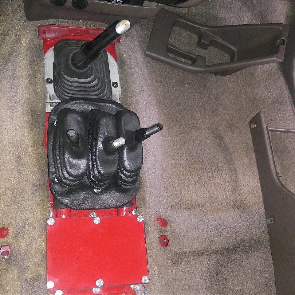

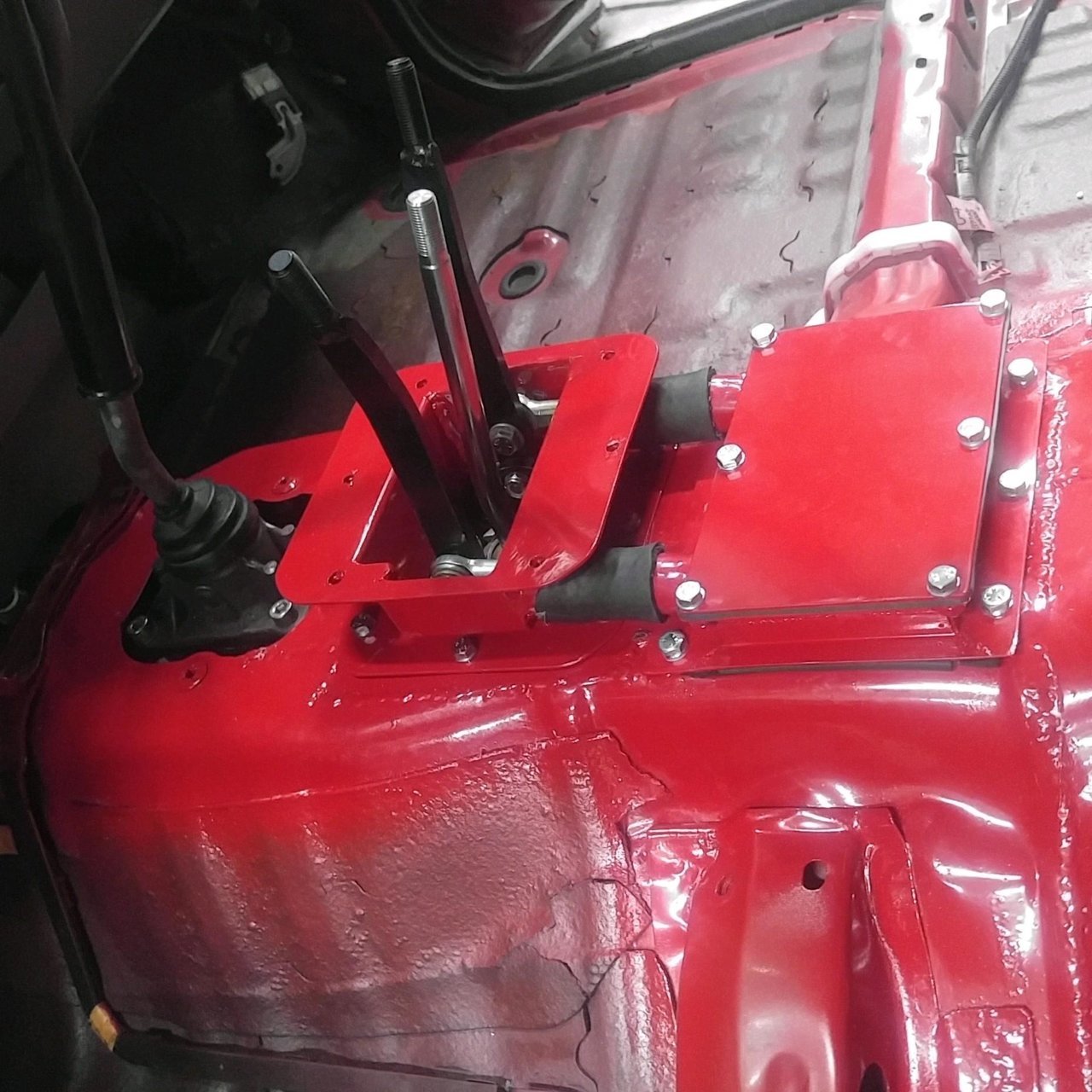

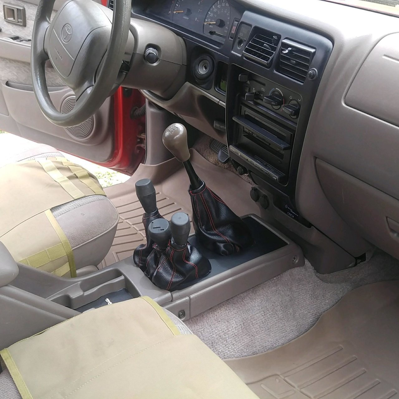

  12. Jun 24, 2019 at 12:52 PM
    #912
    Jonyd182
    Jonyd182 What do you mean I can't go up there...Watch this!
    Aug 9, 2011
    #61443
    684
    Jonathan
    Columbia, SC
    '99 SR5 TRD 3.4
    Armored to the teeth, 35's, Crawlbox, Boxed Frame
    Super excited over here:dancingbacon::broccoli::goingcrazy:

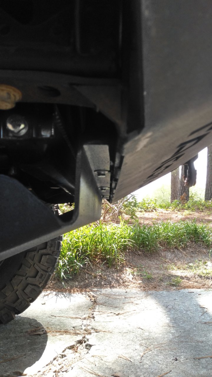

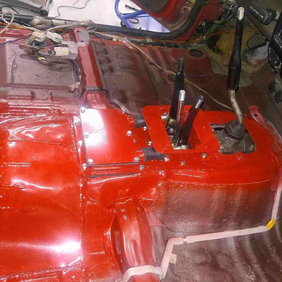

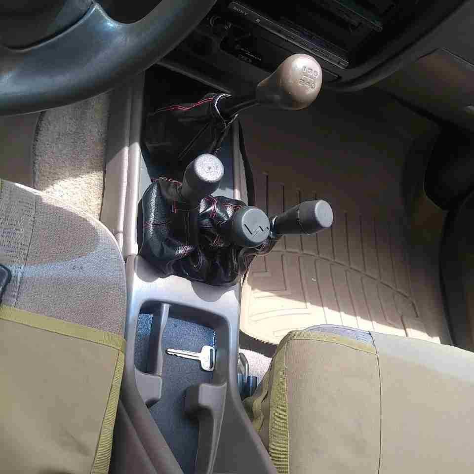

    I picked up the Taco from my buddy's shop a few days ago and I have some brand new bits to show off! Couldn't be happier with how everything turned out! Might just be the first waterproof triple stick crawlbox out there
    Along with the new center console I had him install a proper mounting plate between the front IFS skid and Bumper, Plus a new crossmember for the crawl box.
    hoverlover, Prayn4surf, G.T. and 11 others like this.
  13. Jun 24, 2019 at 1:05 PM
    #913
    ThunderOne
    ThunderOne Well-Known Member
    May 20, 2009
    #17473
    10,043
    Mitchell
    Nashville
    1ST GEN OR GTFO
    Toyota NERD
    omg, this looks friggin amazing. Can you elaborate on how you went about this? Also where did you get your boots from? How did you make that center gap filler area in the shifter area?
  14. Jun 24, 2019 at 4:11 PM
    #914
    HomerTaco
    HomerTaco [OP] also HomerTaco Vendor
    Mar 28, 2010
    #34129
    45,874
    HomerTaco
    HomerTaco
    HomerTaco
    Finally! A 1st gen twin to me! Great work!

  17. Jun 27, 2019 at 4:05 AM
    #917
    HomerTaco
    Mar 28, 2010
    #34129
    45,874
    HomerTaco
    HomerTaco
    HomerTaco
  18. Jun 27, 2019 at 5:03 AM
    #918
    eimkeith
    eimkeith Well-Known Member
    Jan 8, 2017
    #206925
    452
    J Keith
    '96 4Runner, '03 Taco
    Are you concerned about vibration/rattles? Seems tight for drivetrain movement/twist?

  20. Jun 27, 2019 at 5:34 AM
    #920
    rngr
    rngr Aix sponsa
    Jan 13, 2015
    #146258
    9,244
    01 SR5 4x4 2.7L
    My triple stick linkages rattle like crazy on the hwy. I just consider it an audible reminder that my truck is a badass. :cool:
