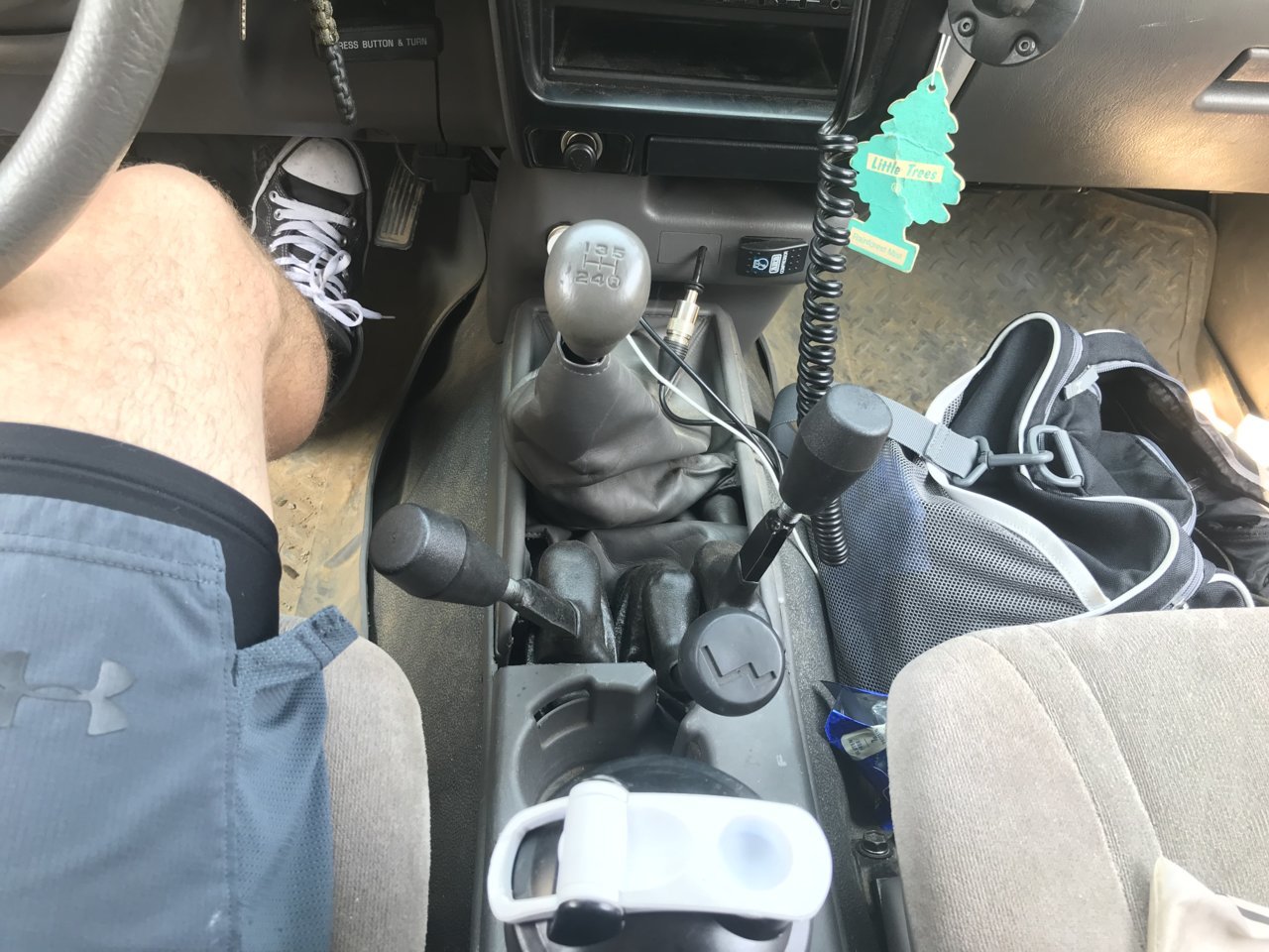

    Has anyone done this or would know what would be involved in doing a conversion from J shift to electronic shift?
    I know most people do this the other way around - however when I plan to install a crawlbox the Electronic shifter would be much easier to relocate as it doesn't require four sticks in your shifter area, only 3 (I have a 5 speed manual so 4 sticks would get a little crowded)
    Thanks
  12. Jul 12, 2019 at 8:43 AM
    #932
    rngr
    rngr Aix sponsa
    Jan 13, 2015
    #146258
    9,244
    01 SR5 4x4 2.7L
    No idea about that, but It’s really not bad. You should come sit in mine.
