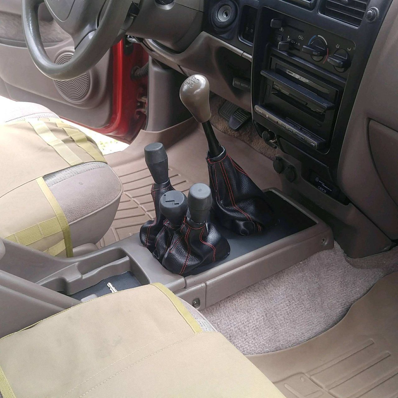

    Thief deterrent is what I call it. When parked and in doubt, shift tcase to low low. And I think it look better all cluster together

    Would be quite entertaining to watch a thief try to run off with your truck in low/low. Haha.

    Revving to 5k rpm and moving just a few feet per minute. Imagine the look on they're face when they think they hit the jackpot but can't drive off with it.

    Care to elaborate on this? Either you're just trolling or you've figured something out the rest of us haven't:bikewhoops:
    Not sure about the conversion but the triple stick setup is just damn sex appeal in my book...I might give up a kidney before I convert one of these beauties. :burnrubber:
    Sorry for being no help at all....Good luck on the mod :fingerscrossed:

    Yeah after some taking about it I figured out I'll just stick with J shift haha

    you haz a crawlbox.

    You need to put yours in. Quit slacking. It's an 8 hour job. An hour of that was driving to my local welder and back for the shifter work. lol
