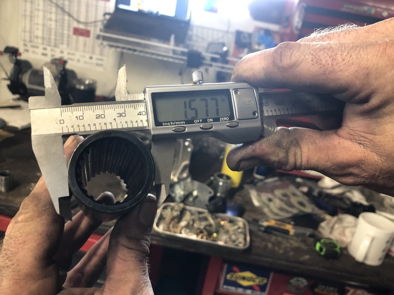

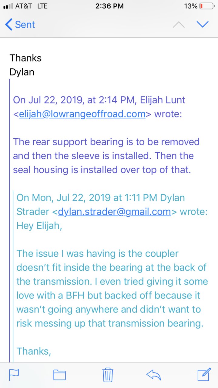

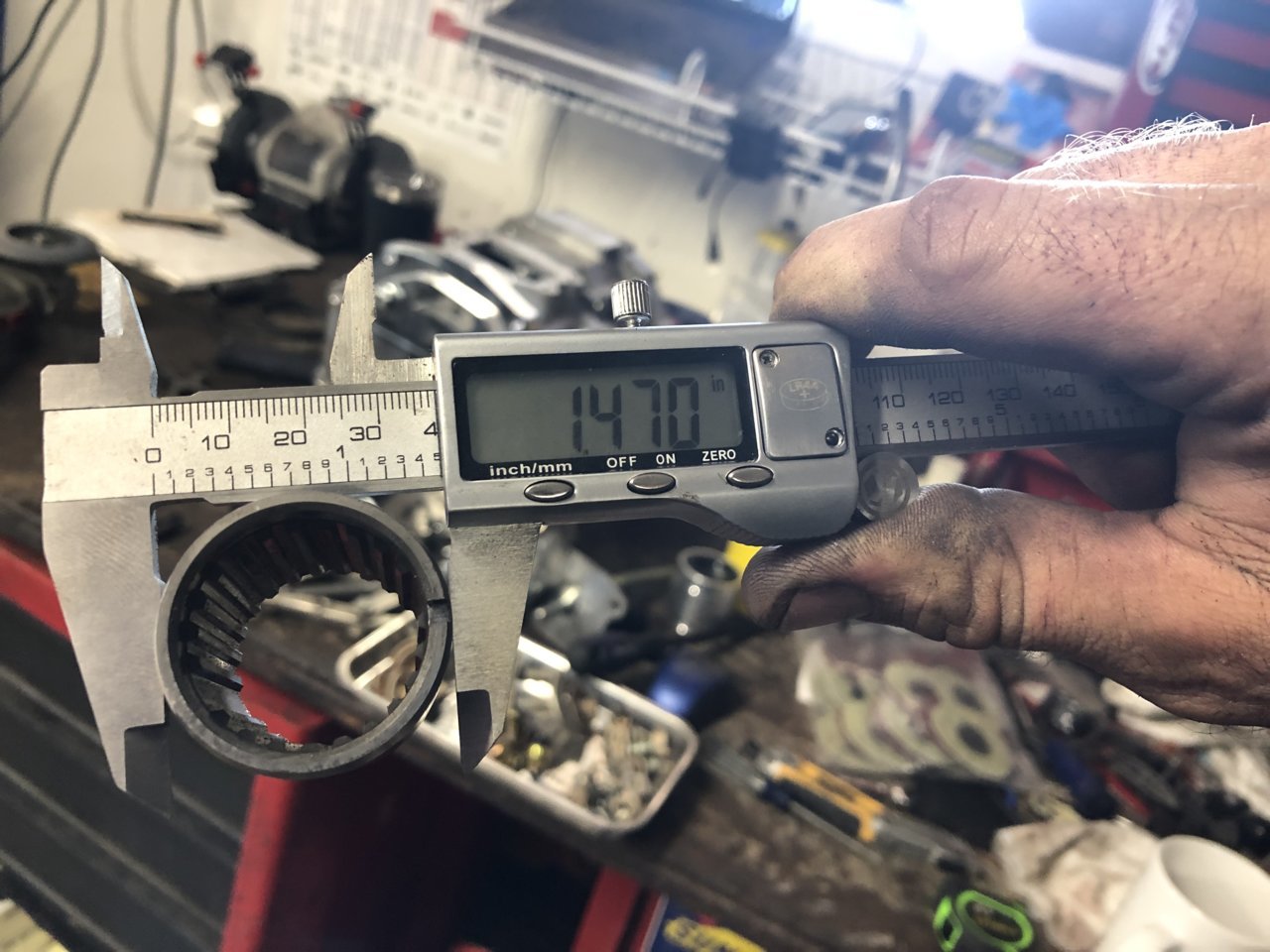

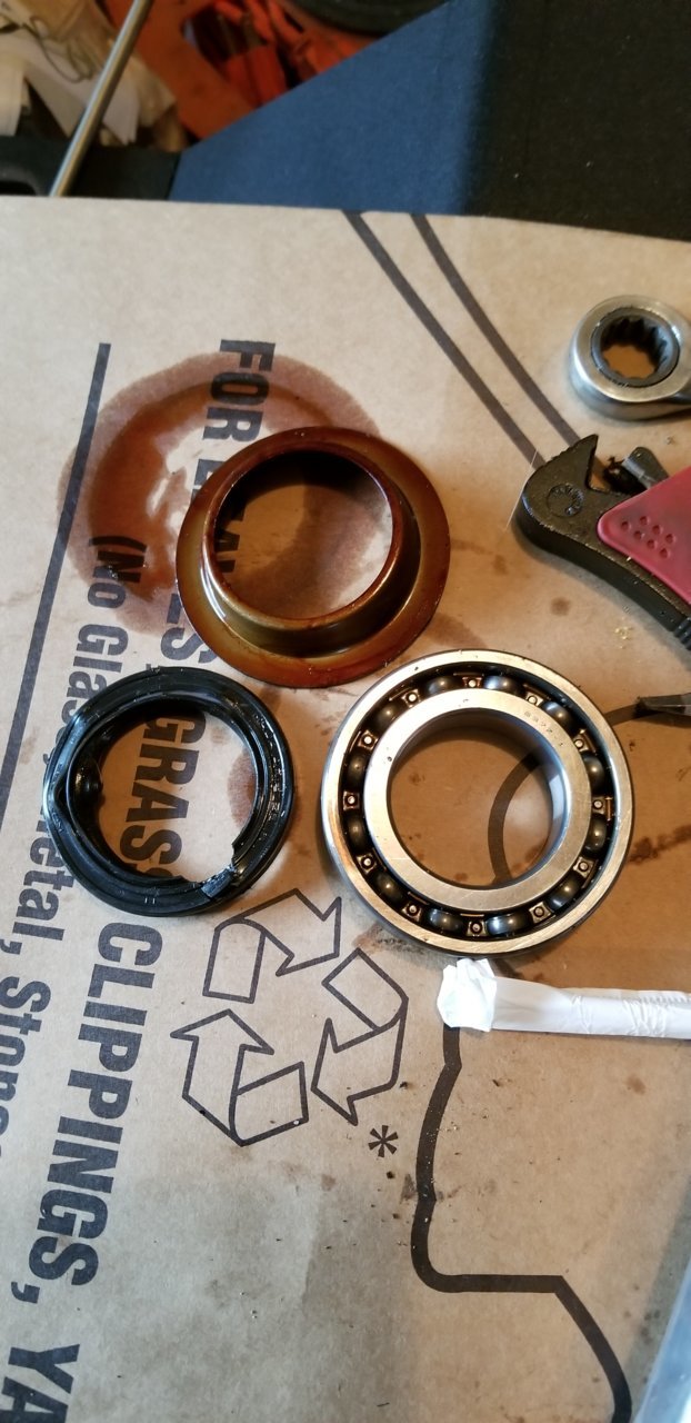

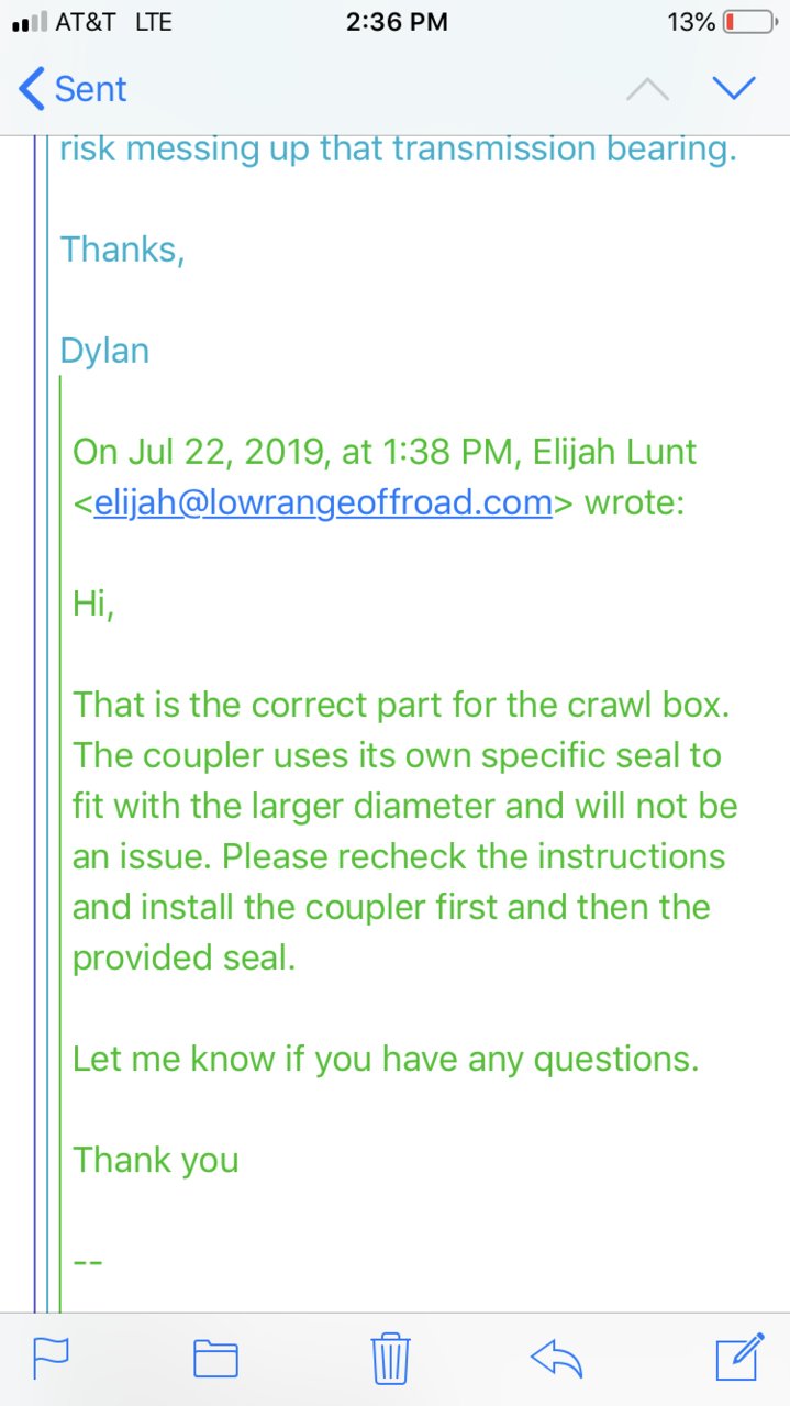

    Could use some advise. This sleeve doesn’t fit inside the transmission. Trail gear is giving me the run around. The instructions never talked about taking apart the fkn trans

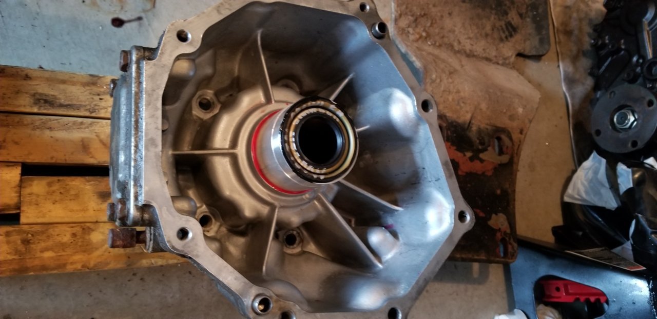

    Auto transmission correct?
    You'll need to remove the housing adapter that goes from the trans to the factory tcase. Inside of there is a C clip with a bearing and seal that needs to be removed in order for the new coupler, aluminum seal housing, and seal to fit correctly.

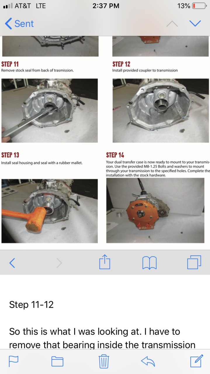

    Sorry if I sound like a moron, I kinda am and I don't have the truck in front of me. What you're saying sounds completely outside the realm of what the instructions are saying (I trust TW more than these trail gear guys at this point). I pulled the stock coupler off the stock t case, that's in one of the photos. But just to clarify I have to remove this bearing out of the back of the trans?

    Yes that's correct. For autos, that bearing is too small of an I.D. for that new coupler.

    Thanks for the link, that actually looks really helpful. I still can't do step 4 though as that coupler doesn't fit in the trans. Sorry if i'm missing something obvious new to all this

    So it looks like there's a piece of the trans (between the bell housing area and the stock t case) that I can remove to get that bearing out without pulling the entire trans, is that right?

    No worries, you made me question my own knowledge when I thought you were 5-speed. Auto trans instructions start on step 6 in that pdf
