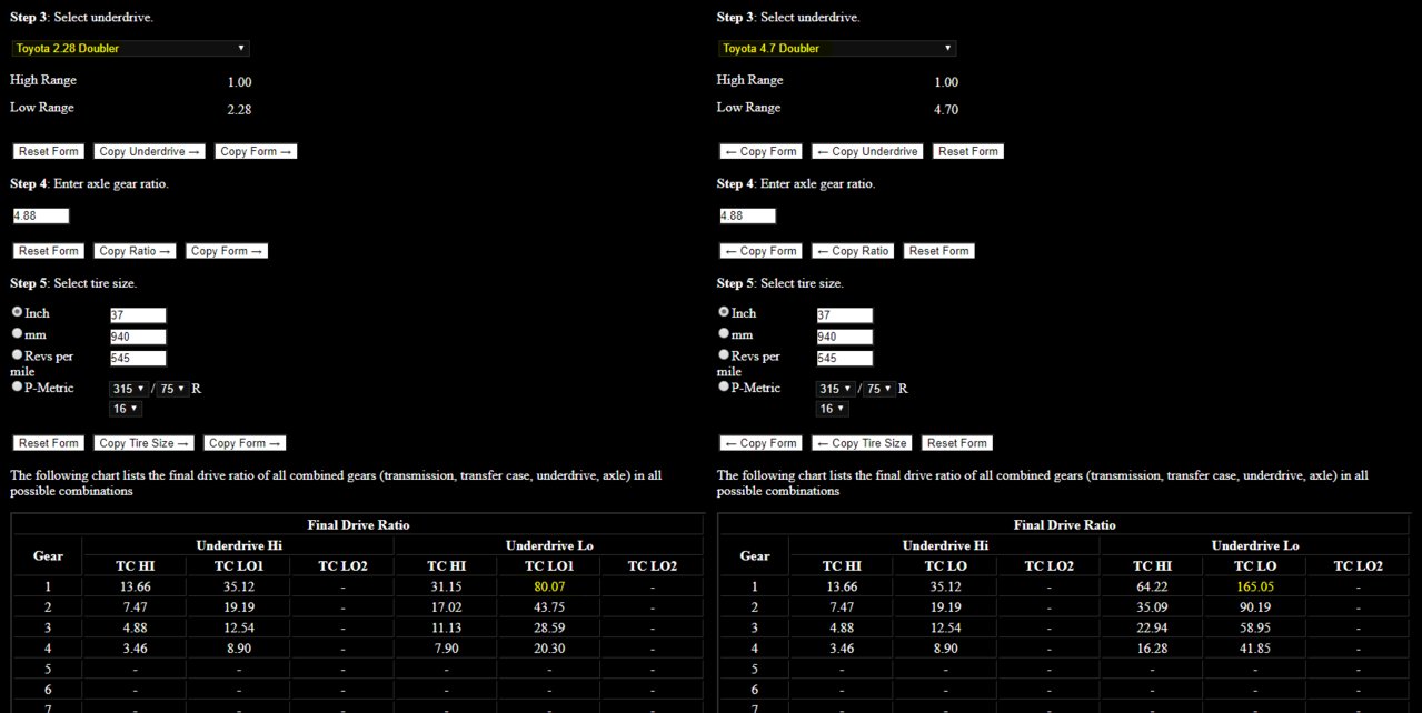

    SAS'd PreRunner Diamond Axles Crawlbox
    2.28 vs 4.7 Differnece is pretty substancial.
    upload_2019-7-25_13-21-52.jpg[
    hoverlover likes this.
  20. Jul 25, 2019 at 10:35 AM
    #1060
    hoverlover
    hoverlover Never pet a burning dog.
    Apr 4, 2016
    #183342
    10,838
    C-137, Laniakea, Virgo, Milky Way, Earth, USA, TX
    Things. Stuff. Lots of bad decisions.
    Mostly Zip-Ties
    Fancy
    What is that?
    I just did mine with a pen and pad :anonymous:
