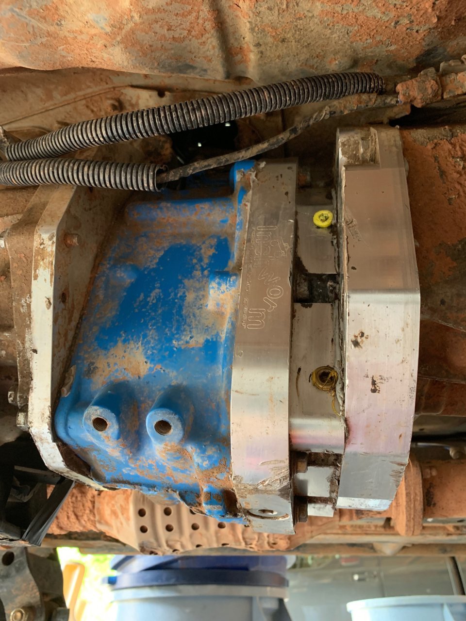

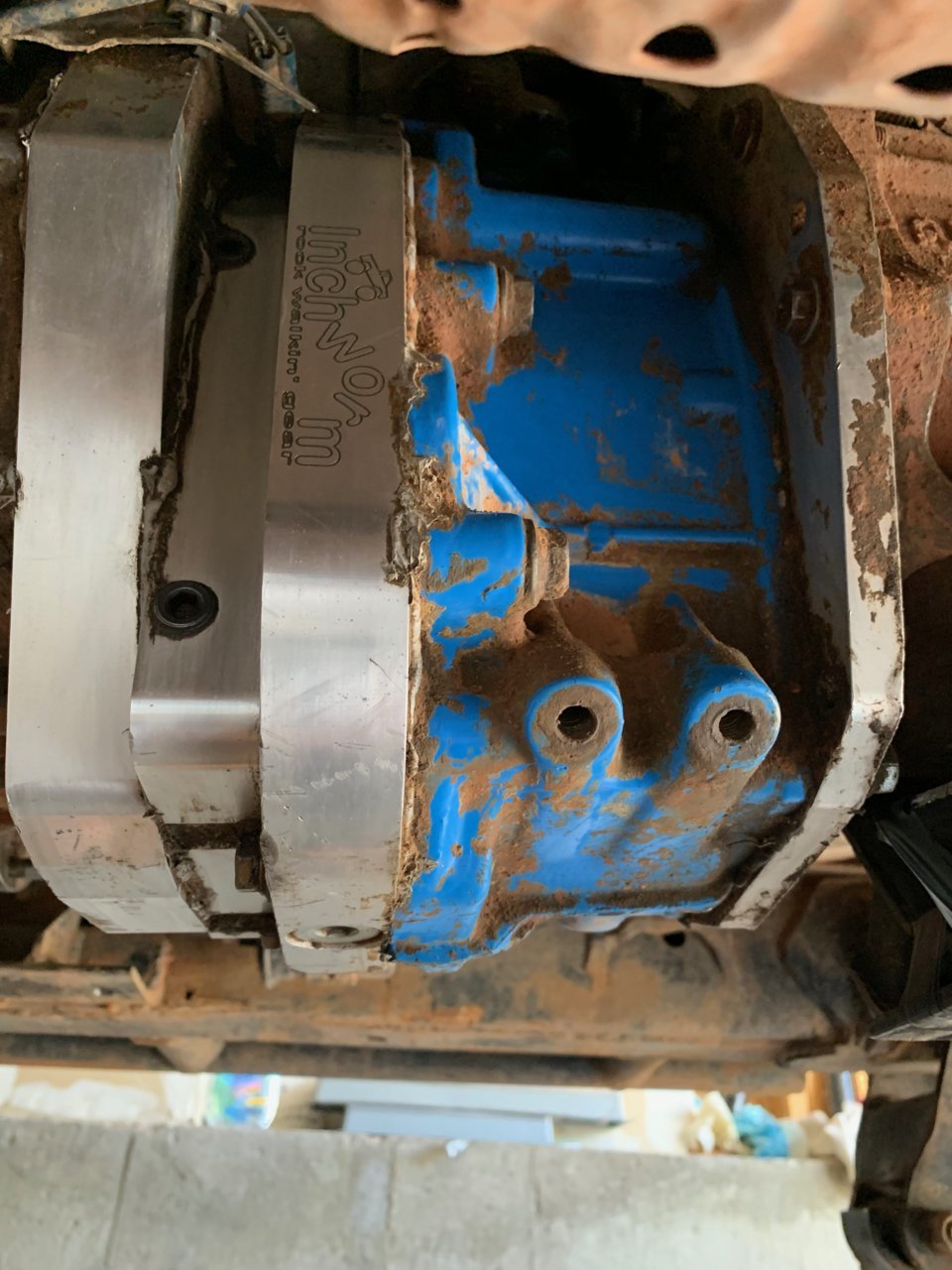

    I have a question that perhaps someone on here can answer. I have a 2002 Tacoma, 3.4, auto, dual cases. (D60 / 14B, exo, etc) I bought the truck mostly built but have improved it here and there. The driveline is all as I bought it.
    The front case is an Inchworm 2.28. The rear case is the stock Toyota case also 2.28. It has a clockable adapter (Inchworm I assume) so the rear case is clocked up. The adapter has its own fill and drain ports and from what I understand does not share fluids with the front or rear case. This makes sense based on the fluid level in the adapter versus the fluid level in the rear case. The front case has a drain plug in the "adapter" that is bolted to the back of it. (I believe Inchworm refers to this as the front adapter.) But I cannot figure out where to put the gear oil IN. I found some instructions for Inchworm crawl boxes for older Tacoma's and they clearly have a fill plug on the passenger side of the 'adapter' on the rear of the crawl box. But mine has no such plug.
    Does anyone know the procedure to drain and fill this Inchworm crawl box? I attached pics of my set up if they help at all. file1-26.jpg file3-20.jpg file-42.jpg

    The fill is through the shifter that's the best way, but otherwise there should be a fill plug on the side of the adapter depending on what year and serial # yours is. Some of the older models did not have a side fill plug. I'd say undo the drain plug and measure how much comes out. The crawler/adapter should take around 3 qts of gear oil.
    The front crawl box/adapter share fluid and the rear transfer case is separate from them and has it's normal transfer case fill/drain plugs.

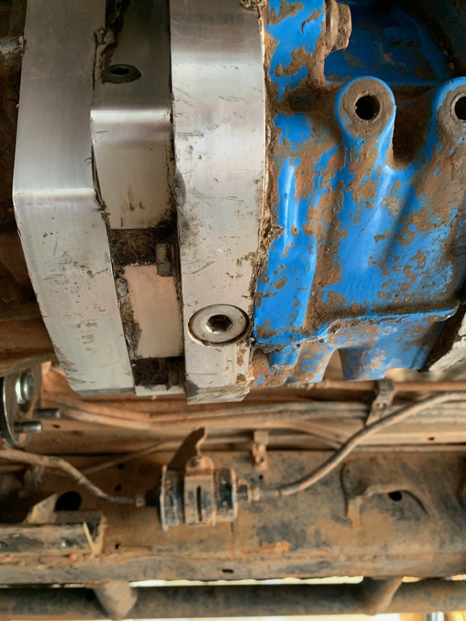

    I attached a picture with numbers and letters.
    So are you saying that the crawl box "A", adapter "B" and adapter "C" all share the same fluid? If that is so, then I should be able to open drain "1" and drain A, B and C. Then I should be able to refill A, B and C through port "3". This would put the fluid level in the crawl box all the up to the port "3" level which seems high, but makes sense if the capacity is around 3 quarts. However, in the pictures of Inchworm crawl boxes with a fill port for the crawl box it is located about at the level of my letter "B" in the picture (but on the passenger side), which is considerably lower than port "3". Which is confusing...……. Inkedfile3-20_LI.jpg

    yes, but those you have marked aren't fill plugs. They look more of a level system if you installed a tube to keep an eye on the level. The oil should be about halfway between the top and bottom of the case. Again, some of these older adapters didn't come with a fill plug installed, don't over think it. Just remove the top shifter and fill with 3 qts and drive around and enjoy.

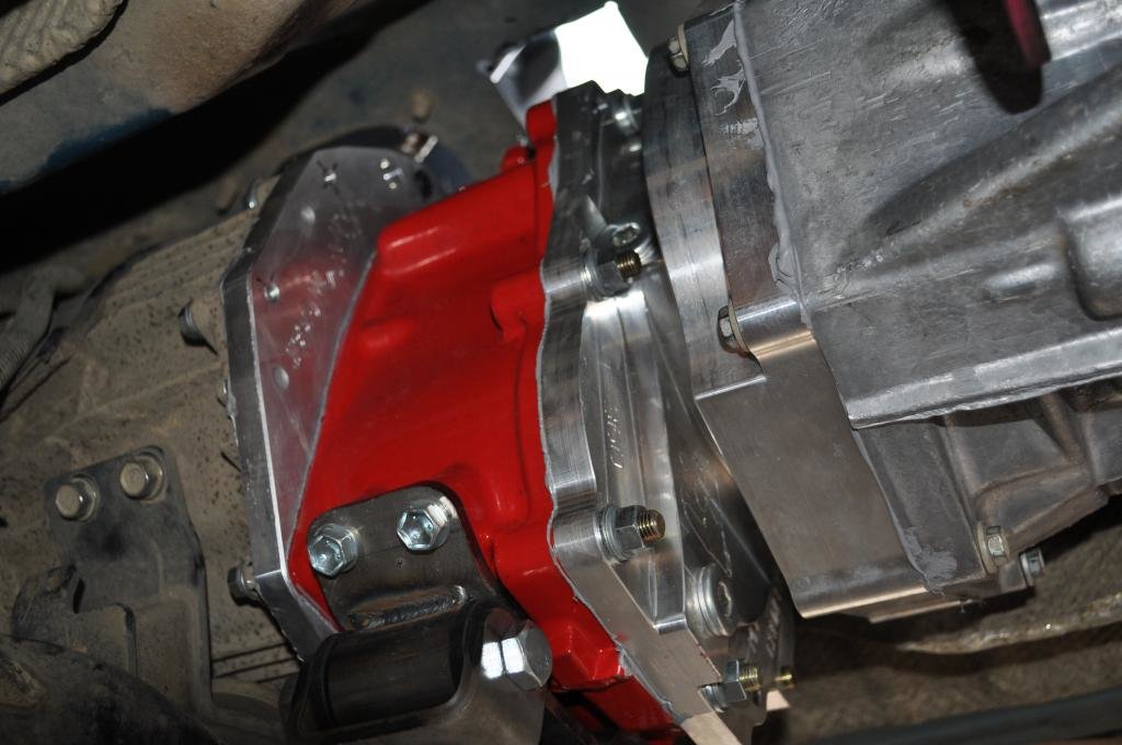

    You can see both fill and drain plug here for the merlin

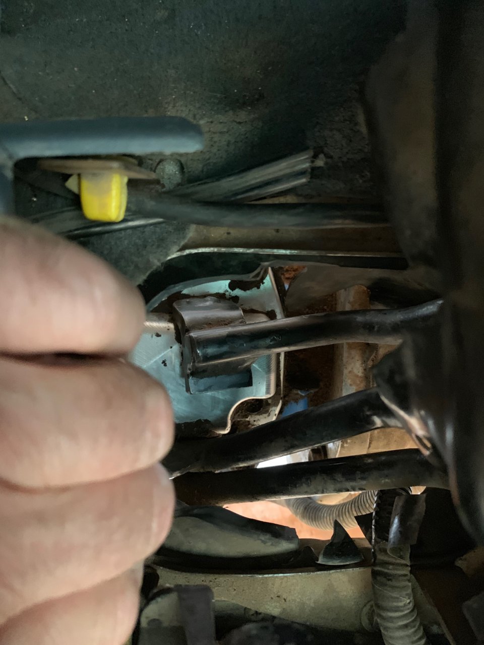

    Well I think I have run into another difference between the "older" version and the "newer" versions. There is no snap ring (that I can see) where my shifter goes into the crawl box. On top of the crawl box is the shifter plate, which has a raised section. Coming out of the side of that raised section (doghouse) is a horizontal shaft. That shaft has an "L" bracket welded to it. On the top side of the "L" my shifter rod is welded to it. Then across from that "L" bracket, there is an "assembly" that holds the shift linkage for the back case, hi to lo and 2wd to 4wd. So there is a lot going on on the top of that shifter plate.
    I wish it were as simple as pulling a shifter shaft out and dumping oil in, but it sure doesn't appear that way. Unless someone can provide another way, I think that plate has to come off.file-43.jpg

    yes, there is a drain plug in the "adapter" at the rear of the crawl box. But there ain't no damn fill port, which to me is really, really stupid!!!

    Ahhhh looks like you have an aftermarket sealed shifter. Looks like you are filling it from the bottom then, or unbolting that sealed shifter plate and dumping it in through there and resealing it.
