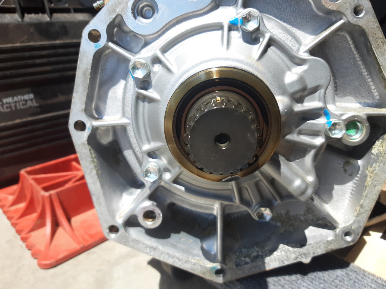

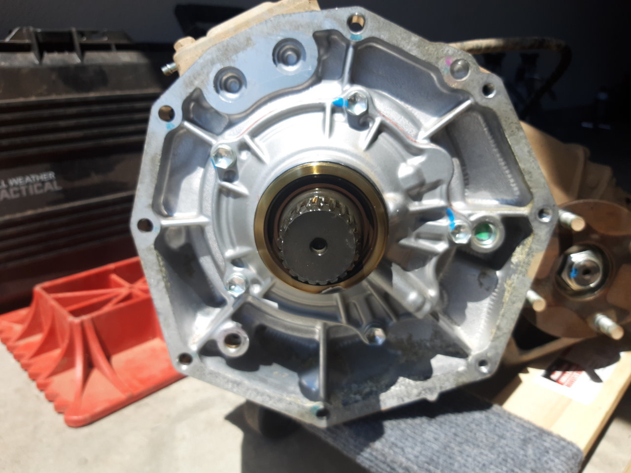

    Anyone pull their stock t-case and have their coupler already backed off a little? Seems odd

    You added a crawl box and shorten the rear shaft 1.25" only???

    Amazing right?

    Never have seen that before on the handful of stock cases I've pulled off a few trucks.

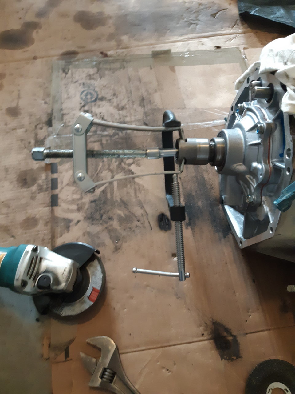

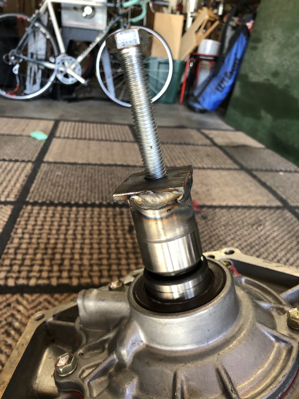

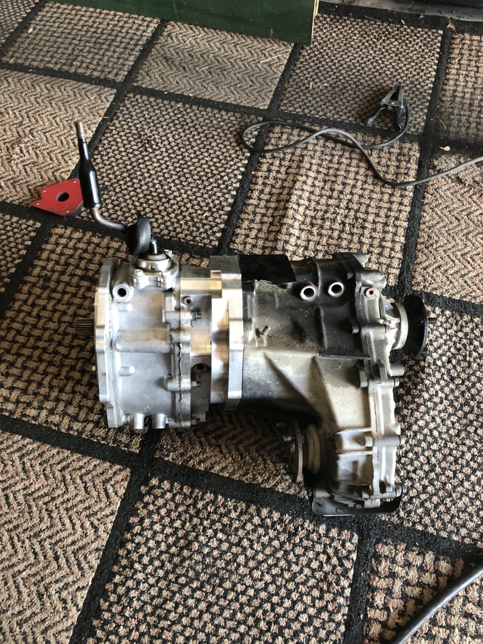

    This also works if you dont have a welder. Definitely pushed that autocrat jaw puller to the limit!
    Twin stick complete!

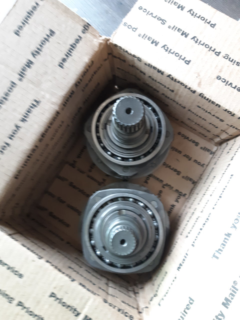

    I'd also like to settle the debate on the number of splines on the 6 speed RA60F manual transmission with photographic evidence of the transfer case input. There are 22 splines.
    The top is the input shaft from my transfer case in my '09 6 speed man trans taco, bottom is the AT FJ case input. I was going to wait till winter to do this but seeing all these parts on my counter and this adapter being the only major obstacle has me motivated to get this done. Taking these to the machine shop this week to see about an adapter. Wish me luck!

    @Littles you should take that male-male spud adapter and weld the back half of the stock 23 spline coupling onto it and bam, you got yourself a 22 spline male-23 spline female coupling!

    Dont tempt me. Smarter people have done stupider things. This thing is going in my truck one way or another
