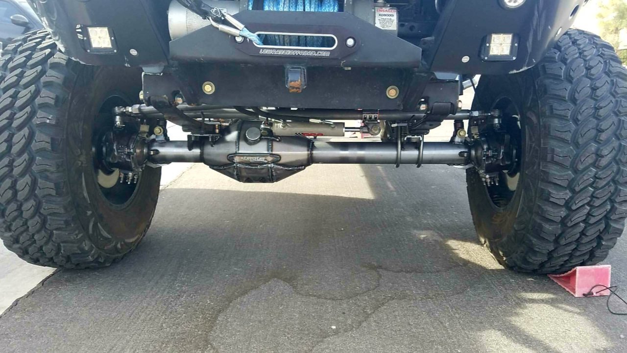

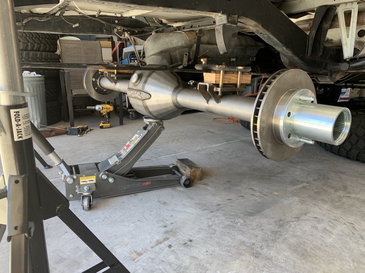

    Look outside of Toyota crawl boxes. Look at the magnum black box, off-road designs, atlas 2 or 4 speed, hero case. There’s tons of different cases out there and although they may not bolt up to a Toyota transfer case they will bolt up to something else that is stronger. Just have to do some searching and figure out what works.
    Like my plan. I have an a340e (2wd transmission) with a inchworm adapter to dual cases (23 spline 2.28 front 4.7 rear. About as strong as they come). I want to ditch the dual cases and go to a 4.3 or 5.0 atlas 2 speed. To do this I need an a340f (4x4 Toyota transmission) or an aw4 transmission from a Jeep. If I use the a340f transmission I need an adapter to bolt the atlas up which costs roughly 800-1000$. If I go with an aw4 (which are a dime a dozen out of an xj) and swap my current bell housing and torque converter onto it, an atlas or Dana 300 will bolt up with a small spacer that costs 100$.
    You guys do what you want, I’m just trying to say there are better options out there, you just need to search and talk to companies. Buying a 1 off coupler for 500-1000 dollars to make a part that was designed for an 80hp 3000lb trucks to go into your whatever hp 5000+lb truck sounds absurd to me.
    There’s a reason the old Toyota’s work with dual cases and Toyota 8 in axles and 3rds with no problems. They have little to no horsepower and weigh next to nothing.
    I know all about the fancy axles and what they cost as I’m finishing a 609 rear now and Already have a ruffstuff Toyota front..
    reason I say all this is because I have dual cases and even though most aren’t automatic, I regret it because of the leaking problems, small splines, and overall weak cases. Look at what truck these cases started in and compare them to what we are putting them in. More weight. More motor. More everything. The weak point has gone from my axles to u joints and I’m not willing to blow the transfer case up so now I wait and save for an atlas.
    Just my .02.
