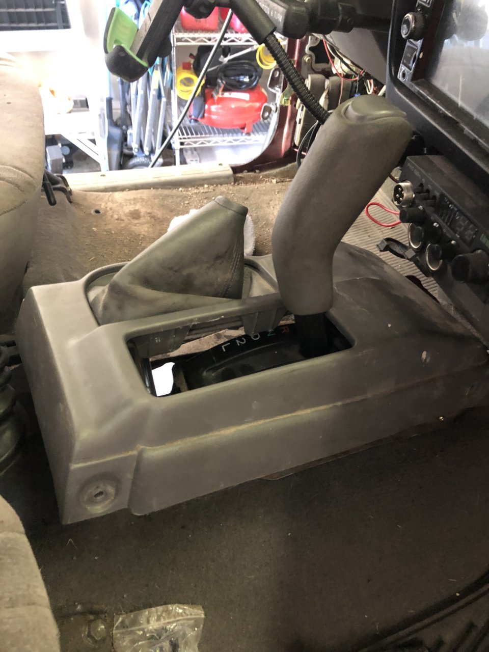

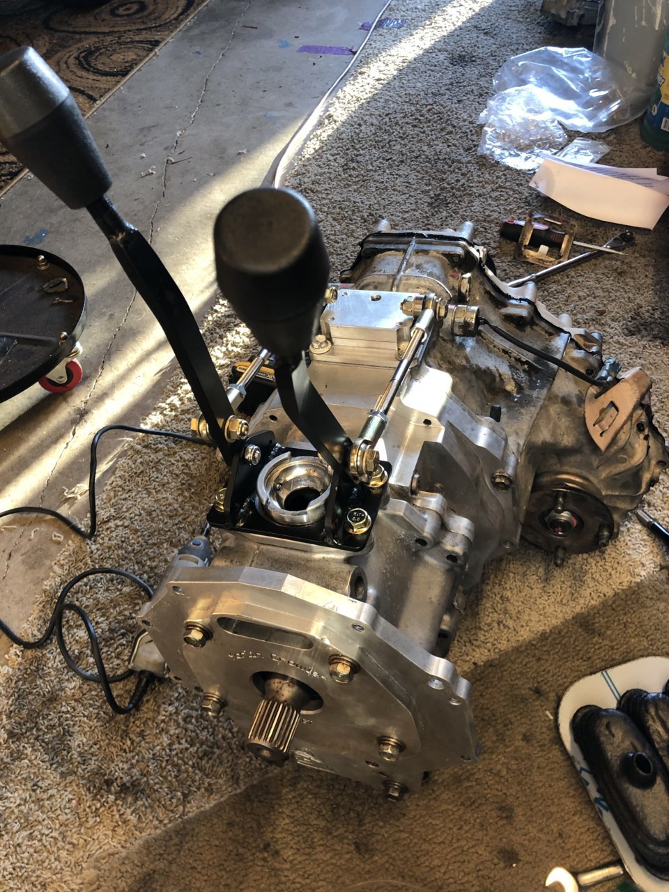

    Any of you guys have autos? Fighting this trim piece. Doesn’t even allow for the full throw of the crawlbox, can’t gdt it seated anyway

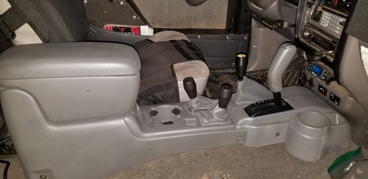

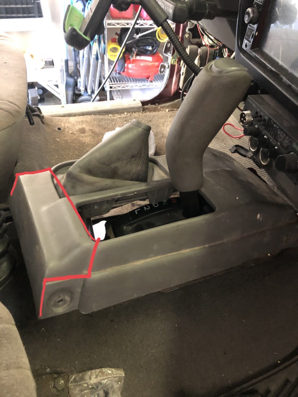

    Not an auto, but the manual version of that piece looks similar. I had to cut the back of it off to allow for my shifters, if that makes sense. I'll try to find a pic.

    I figured i'd have to snip the back as well. The biggest problem is there's not enough room between the crawlbox shifter and the auto shifter to allow that trim piece to seat its self.

    Cut something like this.
    Came out like this.
    I’m sure there’s a cleaner solution, but this works for me.

    Heat and bend the tcase shifter, will take some trial an error, but it works.

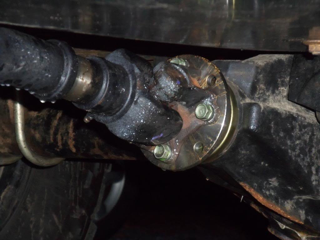

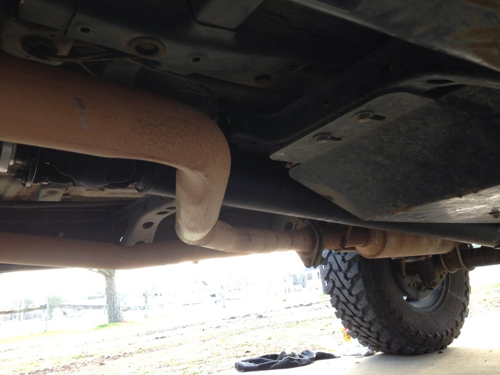

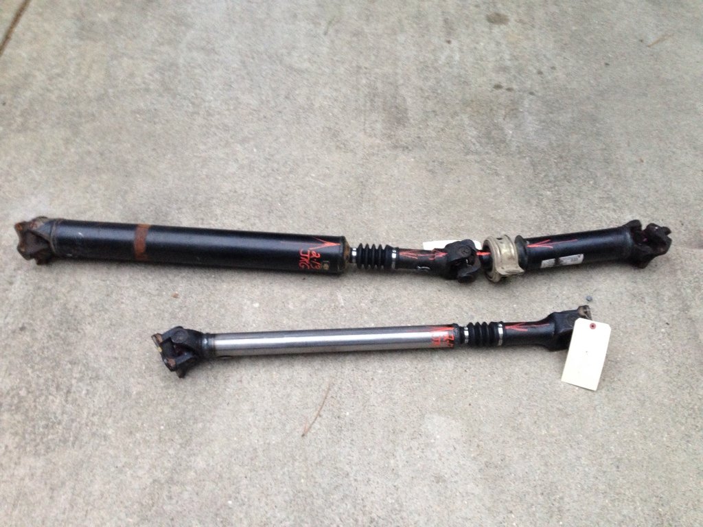

    I'm on the fence about keeping the carrier bearing or going to a single shaft. Looks like drivelive angle remains about the same either way. Any input?

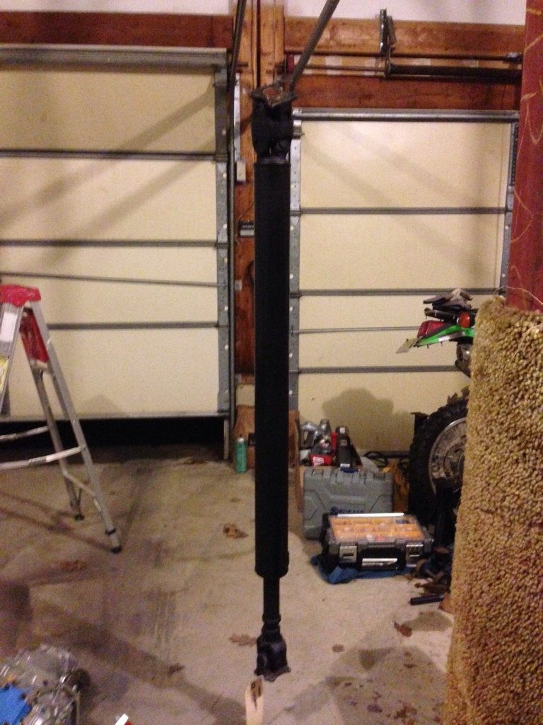

    one piece you'll thank me later. Haven't had a problem with mine for 7 years since installing. Get yourself rid of that garbage pillow block bearing setup.
    I used a double cardan from 3rd gen 4runners (96-02), have them lengthen it and re-balance, re-used all the u-joints. The double cardan end will bolt right up to the FJ case flange, the differential end has a smaller bolt pattern; you have to drill it out or get a double/triple drilled flange. The best part is you get it to keep it all toyota driveline which is one of the strongest around, and they come with a greasable slip yoke so no more of those annoying squeaks. You can get the 4runner shafts for cheap from a pick n pull, think I paid $40 for mine and then another $150 to get re-tubed and balanced. Here's some shots, as you can see, no loss of driveshaft clearance from the carrier setup
    I kept my 2 piece shaft as a trail spare and had the front part shortened 8.5".

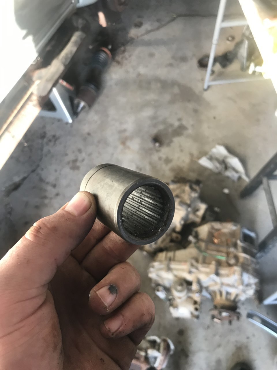

    Does anybody have a stock 23 spline trans to tcase coupler? I’ve only got a couple of 26 spline, 4-cylinder/manual couplers in the garage. Looks like the picture below but from a non 4-cylinder/manual

    #1215
    theesotericone
    theesotericone Well-Known Member
    Jul 27, 2018
    #260800
    12,378
    Bishop CA
    I might still have the one I pulled off my stock case. If I can find it I'll let you know.

    Snowy Is neither here nor there
    Feb 5, 2014
    #122349
    3,465
    Connor
    Winnebago, IL
    3 linked 98 Xtra cab
    Stock-ish
    That would be awesome if you had it

    Bishop CA
    I just found it. Came off my stock case and it looks pretty good still.
