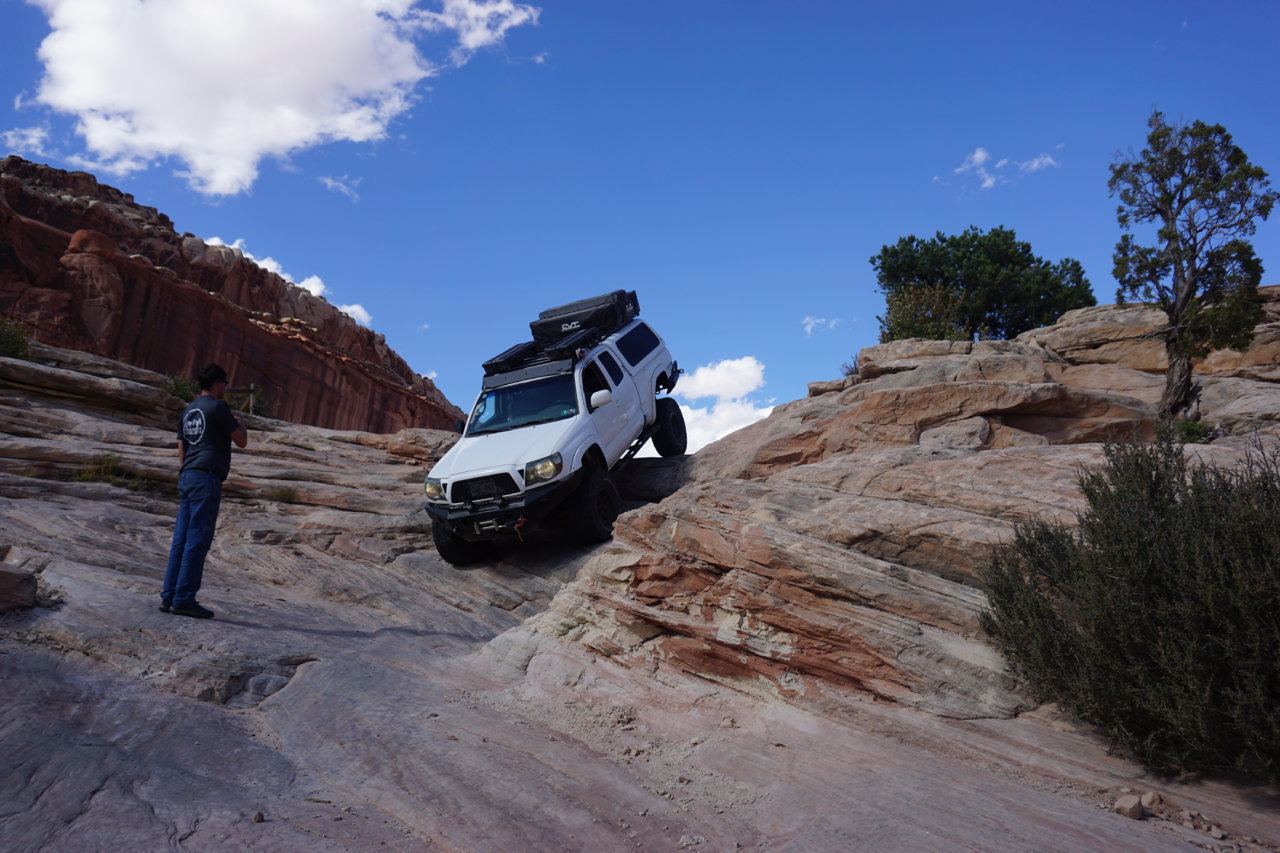

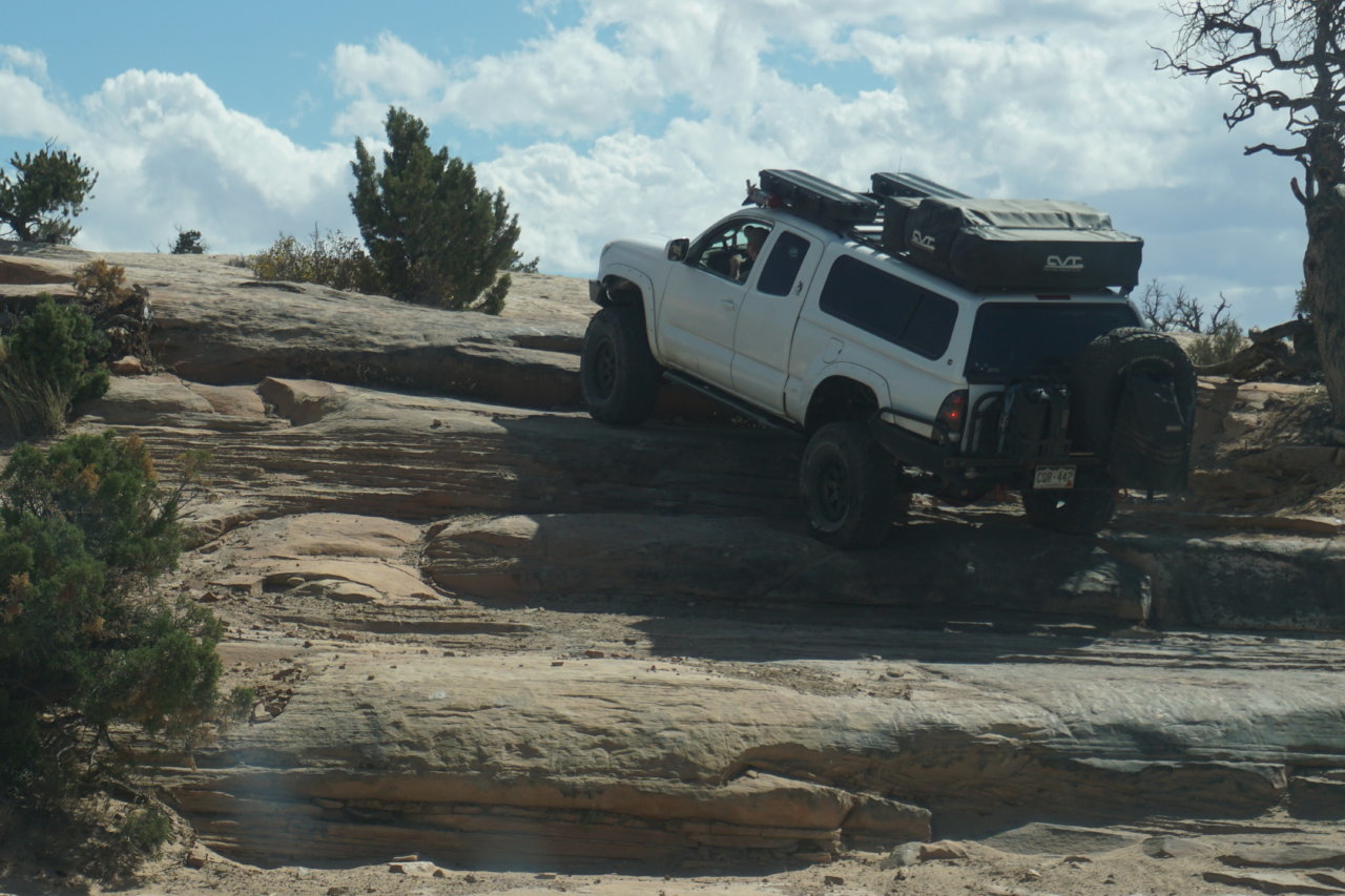

    Got to properly use the crawlbox this past week in Moab. I can't imagine having done most of what we did without it. I'm just trying to quantify all the stuff I didn't break because I could go slow.
    I think this was in 1-lo-lo @ ~2k rpm. It's pretty amazing how much grip you can get even just by letting it idle vs 2k rpm.
    I definitely loved being able to have 3 lower ratios to choose from depending on the terrain. Usually was in 4.7:1 low range as I could crawl up decent sized ledges but still have enough speed to get between obstacles.
