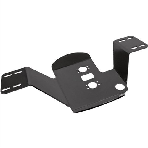

    Thats legit! Wanna make me one and give me an excuse to go to bishop lol. I like how that doesnt add a ton of weight like this thing.

    Yeah I was looking at those. I will definitely get one, plus you just have to remove the two bolts and it separates from the crossmember. I meant his fabed up plate for him to put the hd mount on lol

    There's never an excuse needed to come to BIshop. lol
    I only came up with the idea and design. A swung by my local fab guys place after work and it was welded up. No CAD was used. Just me and him making some cardboard templates and welding it together. He did TIG weld the sides on in the shop and it sure is pretty. Then it was mig welded to the crossmember. I was at his place for less then an hour and total cost, including the material, was 60 bucks. lol

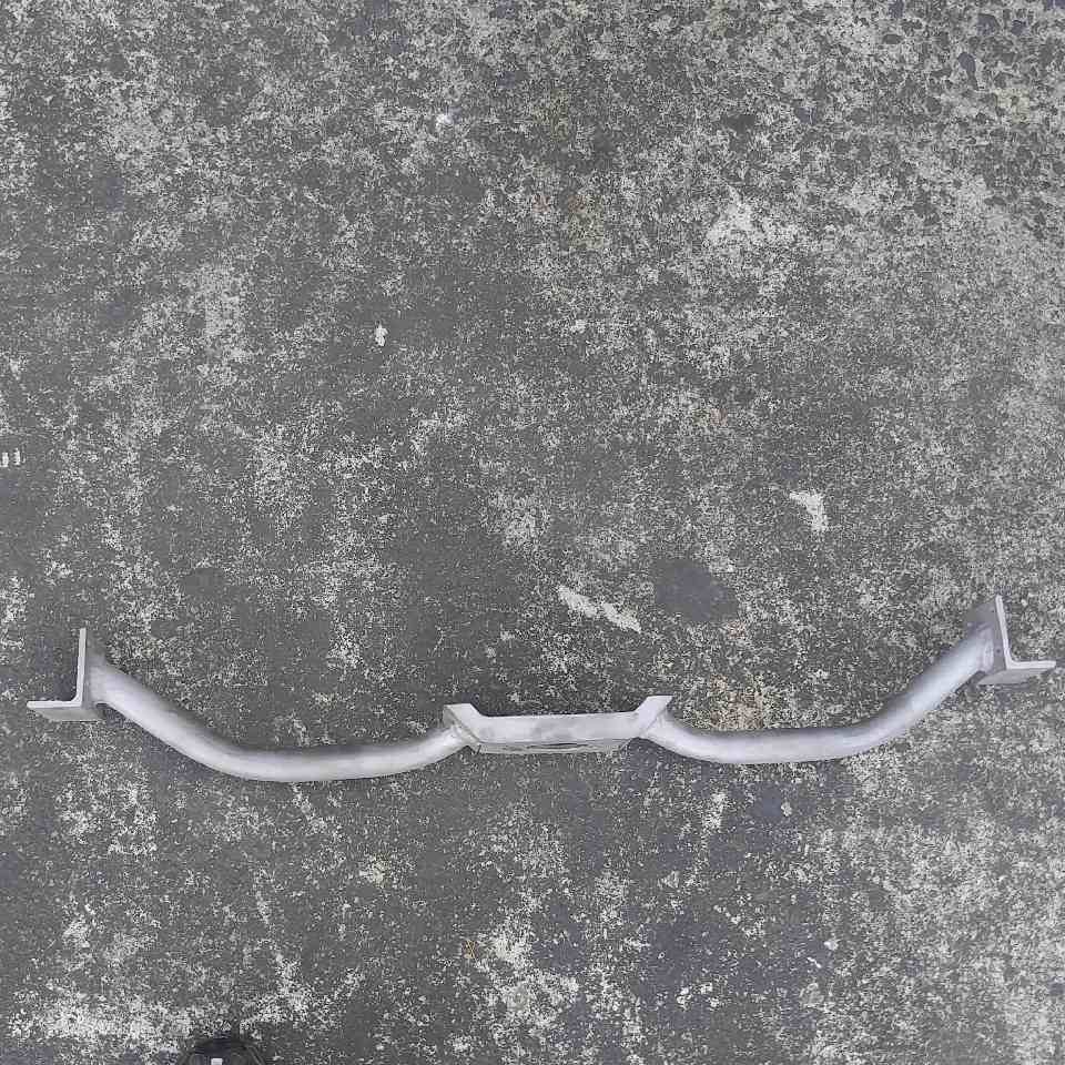

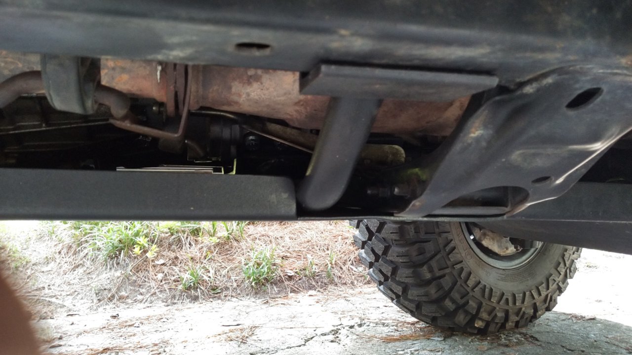

    According to Marlins site, if you go with a 4.7 crawl box you're talking about 2000 torques.
    And because I'm super good at math i know that's a bit more than stock which is why i added an additional crossmeber.
    it's a debated topic for sure but for peace of mind i wanted more support to go along with the increase in power.

    Math was never my strong point but that sounds like a lot of torques :rofl:
    when I have the money for this mod I will definitely add support. Like I mentioned. Seems silly not to. Thx for the input though. Did you make your crossmember or did you purchase that?

    I love me some torques!
    I had to go the custom route as I already had BudBuilt skids underneath and there was no way I was giving those up so custom fabrication it was.
