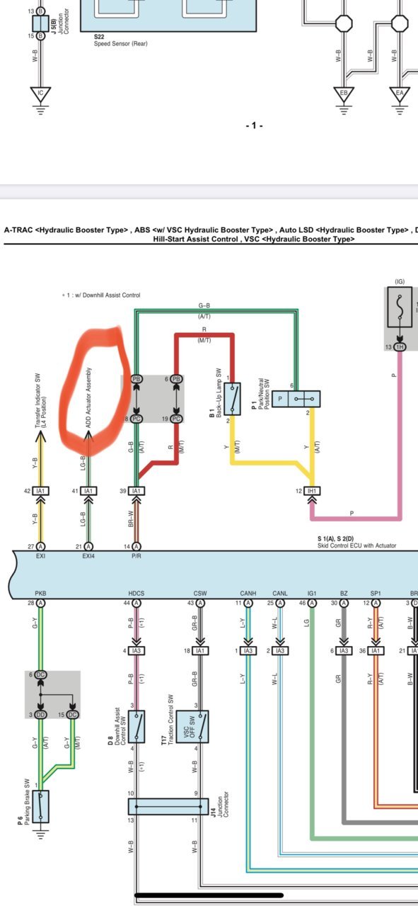

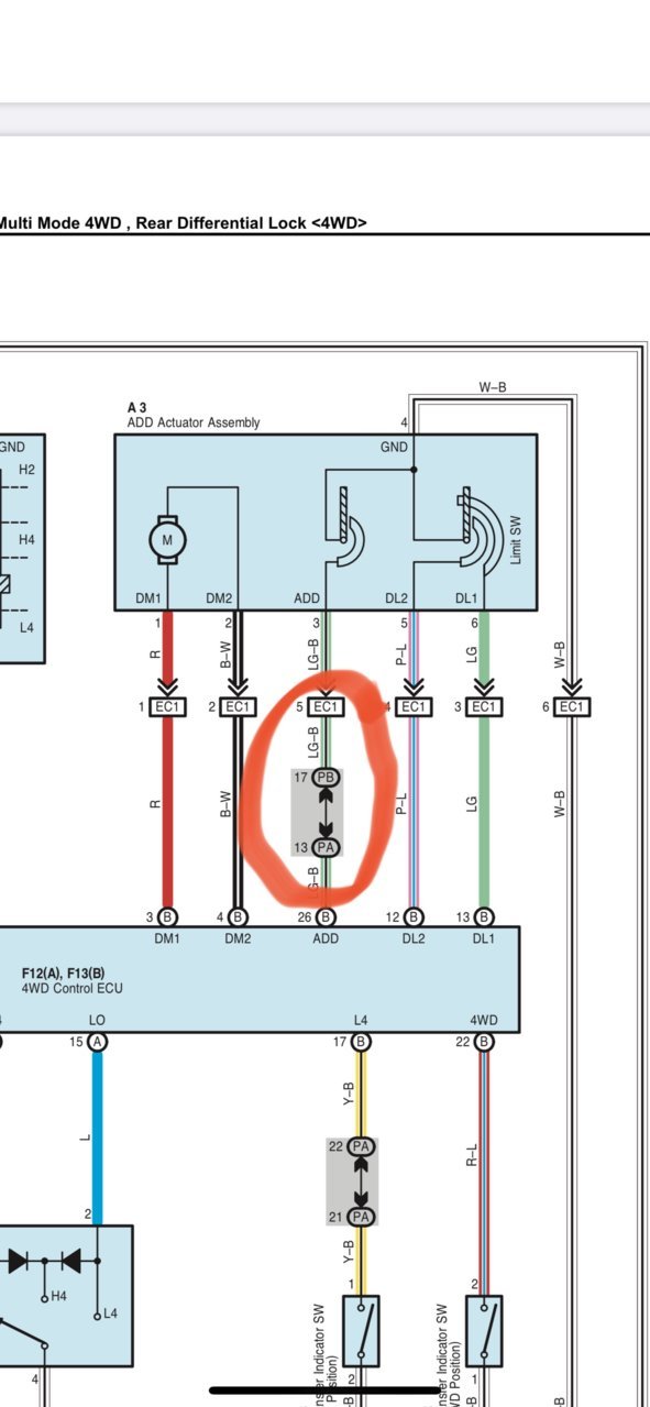

    no lights will come on but if you don’t reconnect the 4wd and 4lo the indicators on the dash won’t ever work. Plus the ADD switch drives a contact input that’s used by the skid control ECU for the traction control so whatever mode of traction control is used in 4wd such as trac or Atrac may not work. But let’s be honest here, most anyone who is putting in an aftermarket transfer case isn’t giving a hoot about atrac

    Yep but I never even unplugged mine just left it up there. It’s all the way at the top of the dash so a pain to get to, and I used the fused tap to tap into the power wire for the 4wd ecu for my “locker anytime” mod. So I opted to leave mine in, but it’s not really doing any control functions at this point, more like abandoned in place.

    truck would not care. Just leave them disconnected. The indicators are a normally open switch and close when the truck is in 4wd/4lo/ADD engaged. I’m not 100% certain about the traction control ECU but I know there are different modes of traction control whether you are in 2wd or 4wd; so essentially you’d be stuck in whatever traction control mode the truck does in 2wd. If the ABS light is on the traction control is probably non functional anyhow. I haven’t reconnected anything except for the hi and low lights to the dash and that is for indication only they provide no control functions. I also pulled one of my speed sensor wires to disable the ABS, it’s been like that for years and everything is been working fine. I have a TRD off-road with the hydraulic brake booster assembly. Below is the ADD switch i am talking about.
