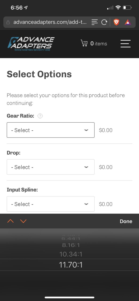

    4.3 second case for the 11.7 total is on my order, shipping just after New Years :bananadance:

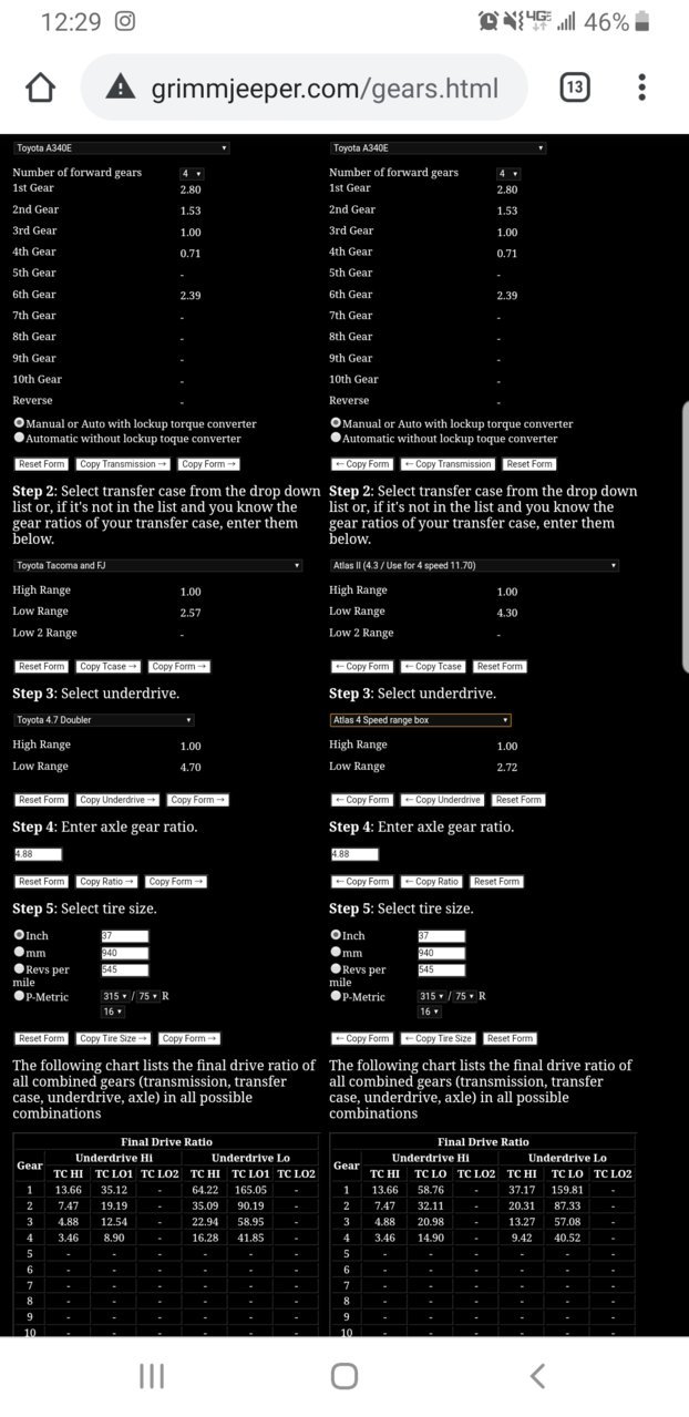

    What will your final ratio be with 11.7?
  8. Dec 5, 2019 at 5:37 PM
    #1388

    160:1, with 4.88 diff.

  9. Dec 5, 2019 at 7:24 PM
    #1389

    #197244
    6,527
    Planet: EARTH
    That can't be can it with 11.7.....

    2.8 low on the A340F
    2.8x11.7x4.88=160 :notsure:

    Need to factor in the first gear too. Mine is 4.71x2.57x4.7.4.56 =259:1

    Torque converter slip in non-lockup effectively doubles the mechanical gear ratio though. So think of it as 5.6x11.7x4.88 on an a340

    You can play around on Grimmjeeper.com for different specs.
    Pretty much identical to what tacoboxess get you down plus gaining the strength and front dig with the Atlas.
