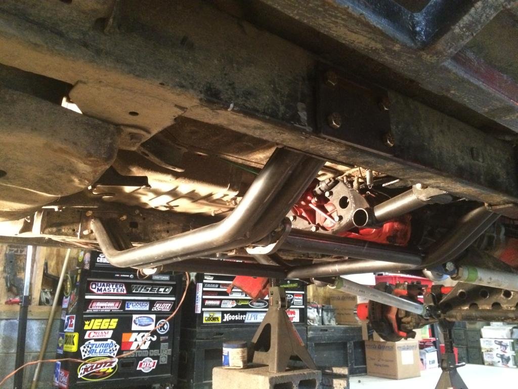

    Here’s what RS did and what I was contemplating with the tail mount, tying it to the tranny crossmember.
    I’m going to cut the stock tranny cross off though and tuck it up.

    That seems....not optimal

    I agree, but better than leaving the tail totally unsupported.

    True. Plus it does give it a skid

    Although I don’t get why they didn’t just build another crossmember, there is still the issue with this setup of two different mount types. I would do poly to the tranny too and solid or derlin on the frame.

    Acting as a skid is about the only thing that looks like it'll do. Looks like it would act as a giant lever on the transmission crossmember and eventually lead to damage.

    The more I look at this, the more I want to know how the exhaust gets routed. This just seems like a train wreck

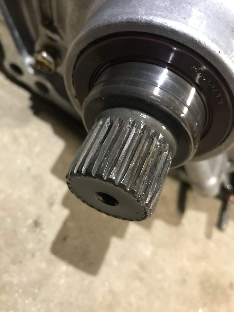

    Pulled my rear case today and the splines still look great (The dark spot is dirt from my boot kicking it across the garage floor). Used anti-seize on assembly with 5 years and a bunch of road miles.

    Not bad!! Some fretting on there but not too much! I wish someone made a longer aftermarket input for these cases for more spline engagement and keep stuff from wobbling around.

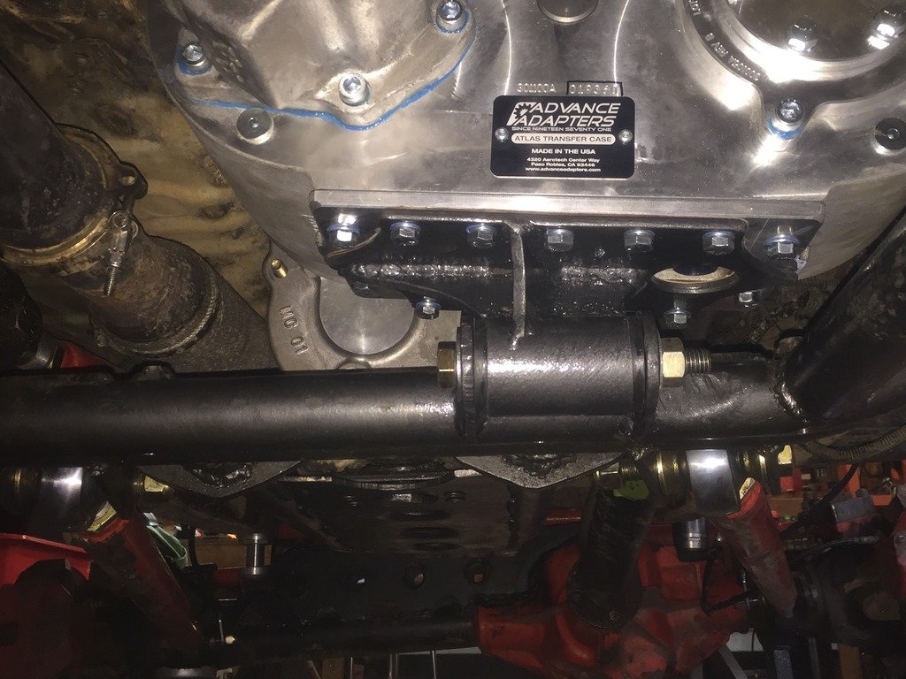

    G.T., jubei and hoverlover like this.

    I'm thinking of a single crossmember located between the tranny and Tcase, with a mount T'ing off the middle with one arm to the tranny mount and one to the Atlas, attached like the above. Where I can't quite decide is how to mount the whole thing. I think that a solid crossmember between the frame rails and then the T attached to it with poly bushings would be the way to go, but undecided if there needs to be some flex between the piece that attaches the tranny and T case. Thoughts?

    I also dig the crossmember he did, bolted through the frame.

    thats seems muy bueno and like your idea of a single that T's off. i want to think that any custom crossmember ive seen has had bushings at frame and tcase/tranny mounting points
