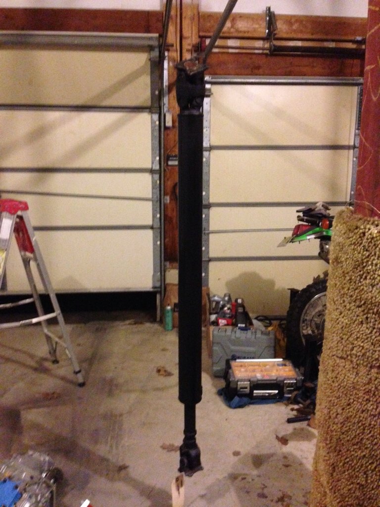

    2,011
    optional
    '10 TRD OR mostly stock
    Plasti dipped hootus

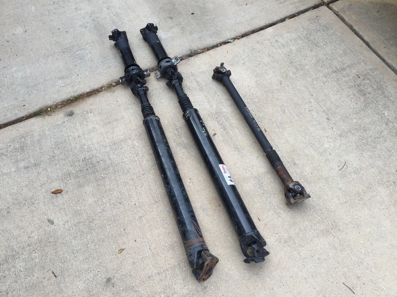

    Not sure about that. I've had one for 3 years now and haven't had any issues. Double cardan one piece is the way to go. The carrier bearing is just another failure/wear point. Once a crawlbox is in the rear driveshaft ground clearance is no different from that of a 1 piece.
