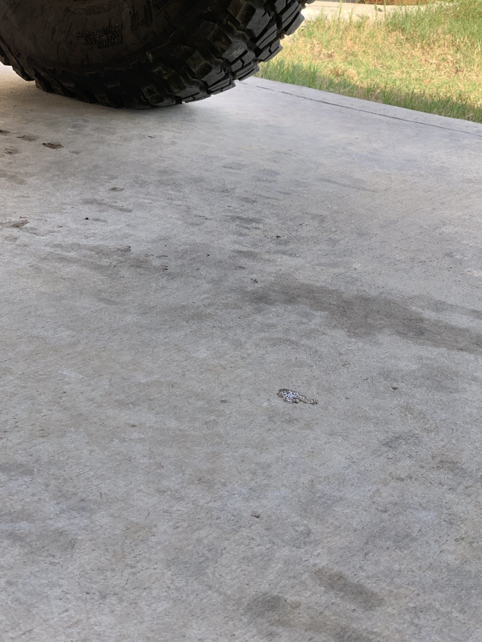

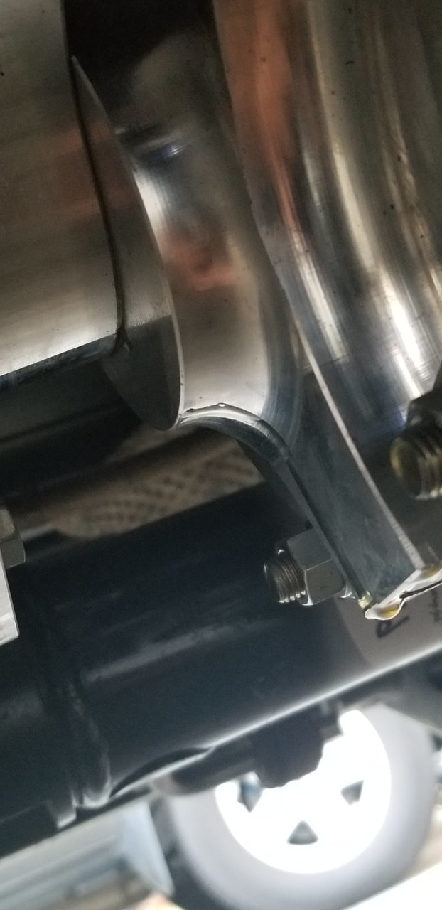

    Hey guys, just joined the crawl box club and it's already started leaking. I didnt do it myself, so I have to admit I'm no pro, but I like to think I'm not clueless. I had Wyatt at RST put it in and the seams between all the pieces are gooped and sealed, but this seam isn't. At first I thought maybe I was just breaking it in as the leak stopped, but I took it for another quick run and it started leaking again. It looks like @hoverlover's, except it seems to stop after a short while? I contacted Wyatt, but I'd like to see what you guys have to say

    Yeah that leak sucked ass to fix. And it only got worse. They were skimpy AF with the sealant on mine.
    Break it down, scrape both sides clean, polish with steel wool, apply sealant as recommended by the instructions around the bolts and follow the curve where it drops downward on the rear plate for good measure. Took me 3 or 4 full break-downs and 4 or 5 times dropping it from the truck to get all the leaks. Although the majority of my problems were at the trans/crawlbox, I had to deal with that one at least twice.
    Be careful around the bolts on the clocking plate. Too much sealant and the bolts won't seat properly in the plate. Too little and you'll be doing it again.

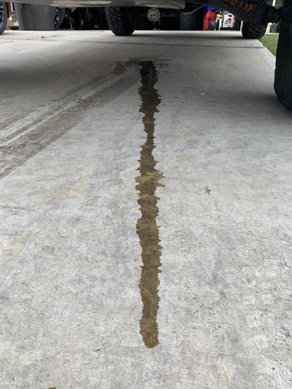

    It's drivable. It's going to spray oil all over underneath and look like a bigger leak than it is. I drove from NC to TX after my install with two leaks and got home with 1.5 of 2 quarts still in it.
    This was after my first fuel stop on the way back home.
    Edit: added pic

    Earlier today it got to about 1.5-2 inches then stopped entirely, I just threw a piece of cardboard under there earlier tonight. If it's any more noticeable tomorrow I'll have to start measuring.

    Sorry I should have said in diameter on the ground, so not too much. That was the first time I noticed it.
